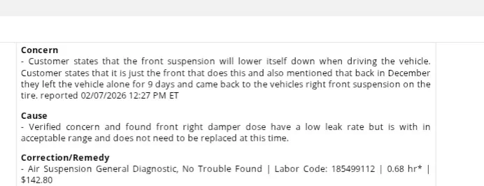

So I have noticed for a few months now the front suspension often has to raise up usually at the first stop I make when driving after it's been sitting a while, like overnight or when leaving work. I didn't think much of it but we went on vacation for about 9 days around New Year's and the truck sat in my garage plugged in the entire time. My first drive back the front passenger tire was rubbing on the wheel well when turning until it raised back up.
So while it was in for the rear suspension recall this week I asked them to take a look at the front suspension. The report says they verified there was a "low leak" on the front right damper but it was an "acceptable" level and no repair was made. The SC has been great at fixing minor issues for me the last time I had it in but this is a bit odd to me. How can a suspension component have an acceptable level of leaking?

Sure I get that, but if it the leak is bad enough that after a week and a half the wheel well is hitting the tire? I still have 16k and 1.5 years on the warranty so I guess I'll just keep bringing it up anytime it's in for service?
I’d definitely keep bringing it up and seeing if you can get a replacement. For perspective, assuming the airbag drops six inches over ten days it’s only a loss of .025”/hour which is quite small. For a daily driver the loss of less than half an inch per night wouldn’t be much of an inconvenience.
