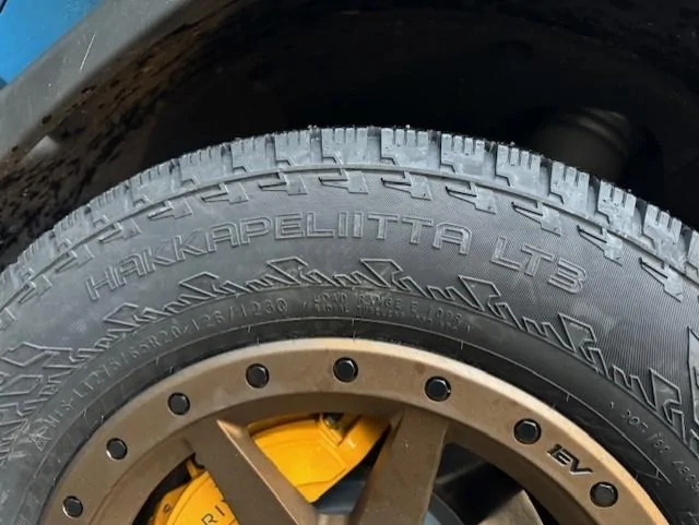

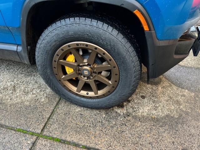

I installed this set of aftermarket wheels (R800 EVSportsline) with Nokian LT3s non-studded. I don't have a report on snow performance yet. However, so far the efficiency is higher than the stock 20 ATs. They are a bit noisier than the stock ATs, but only really noticeable with the windows down.
What’s your new efficiency? I’ve done the same but with the Falkens. It seems I’m averaging about 1.9

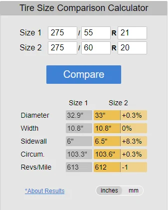

I also have 21" stock wheels. If I understand correctly, you are saying that the Hancock winter I*pikeX 275/60R 116T XL mounted on a Radius WI35 wheels will have the same overall diameter and not require re-programming. I am in Salt Lake and was wondering if anyone has had any experience with local shops getting these wheels and tires, or anything else that will work as replacement for 21" stock wheels.
That is correct. See below from https://tiresize.com/comparison/.

I like to have a dedicated set of snow tires and rims. So, I went with these rims from Tirerack, Rivian TPMS’s, and Nokian LT3 studded snow tires (LT275/65 R 20 126/123 Q).
(I just noticed that the delivery date for the wheels has been pushed out since I bought mine :mad:.)
A buddy of mine has the Nokian LT3’s tires on his truck (not a Rivian) and swears by them. Even though they’re studded, they are a lot quieter than I expected them to be.
We live in BC and frequently travel over the infamous Duffy and Coquihallla passes, (https://www.dangerousroads.org/north-america/canada/4008-coquihalla-highway.html). So, ice performance is top of mind for us.
