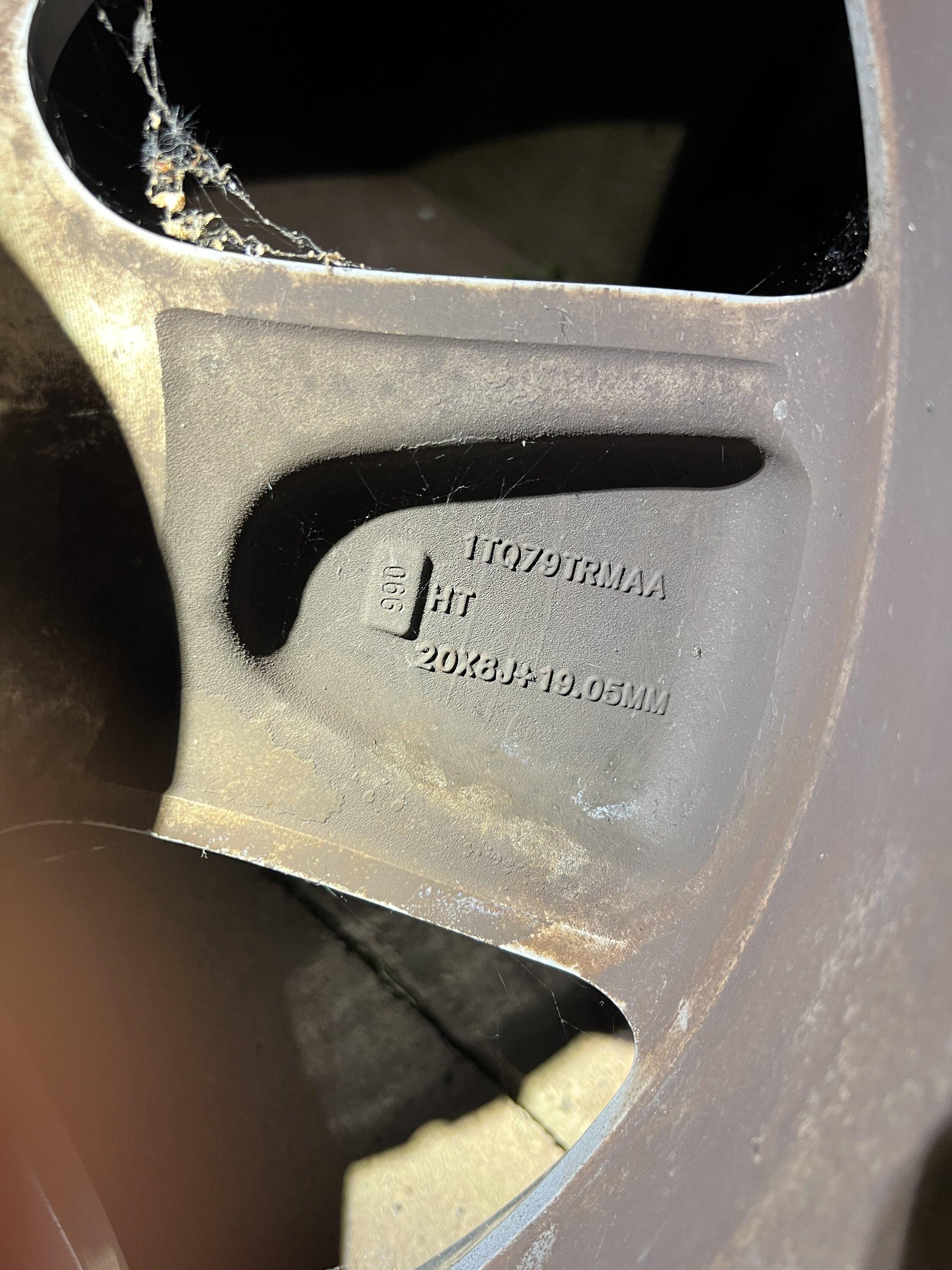

I went to go look at these wheels and noticed the serial number on these wheels are 1TQ79TRMAA. If I remember correctly, 2363 wheel should have serial number of 1TQ79GSAAA? Do you know if the wheels on offerup with serial number of 1TQ79TRMAA will work with our R1S?

Quick research leads me to think, the two wheels are the same. One is painted silver (2363) the other wheel looks to be a variant that is polished (2607). They look identical minus the finish. Notice the 2607 cites both part numbers
  • Factory Part Number 1TQ79GSAAA 1TQ79TRMAA
If I'm in your shoes, for that price, I'd take the risk. But to each their own.

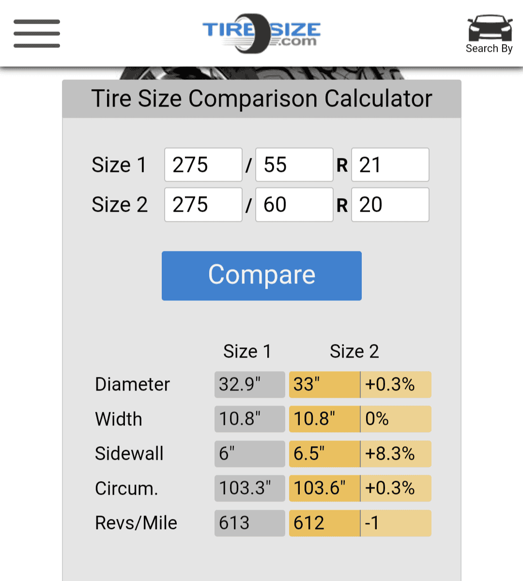

Your speedometer will be off. OEM 21" and 22" is 33 inches, OEM 20" is 34 inches. The 265/60/20 is 32.5 inches. Your cameras may also be off as I've heard cameras need to get recalibrated when diameter of wheels changes. Big reason folks are going to 275/60/20 for 20" rims from 21" or 22" to avoid any recalibration.
Your speedometer is always off, but moreso going 275/65R20 to 275/60R20 or 21s or 22s.
Incorrect on the size difference, it's the same.
