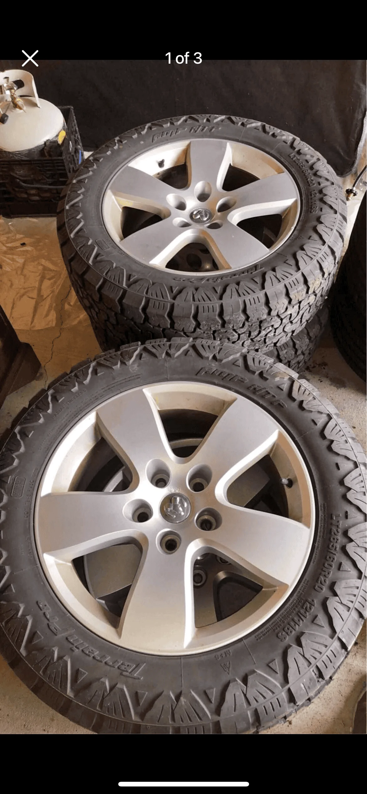

Can anyone tell from this picture if these Ram wheels/tires would work?
They appear to be correct (the wheels). The tire size is slightly different. OEM is 275/65/20. This one is 265/60/20. While it will likely "fit", I don't know that it would be correct. Someone else with more knowledge about diameter changes will have to answer.
I didn't go through the entire list, but someone here made a list of compatible tires. Some have some diameter/width differences and were deemed okay apparently.
https://www.rivianforums.com/forum/...for-each-rivian-factory-wheel-diameter.19563/

Thank you for the reply. I looked at that spreadsheet, and didn’t see these tires listed, but saw other similar sized Tires were OK. I am OK with less performance/efficiency as these will just be winter tires, just want to be sure there wouldn't be any safety concerns.

Your speedometer will be off. OEM 21" and 22" is 33 inches, OEM 20" is 34 inches. The 265/60/20 is 32.5 inches. Your cameras may also be off as I've heard cameras need to get recalibrated when diameter of wheels changes. Big reason folks are going to 275/60/20 for 20" rims from 21" or 22" to avoid any recalibration.
I have the Ram 1500 wheels already. I have the 22" OEM wheels/tires now.
Are you saying when I purchase all terrain/snow tires, I should be looking at 275/60/20 vs. 275/65/20?
Yes if you go 275/60/20 from OEM 21" or 22", no recalibration needed as minimal change in diameter.
