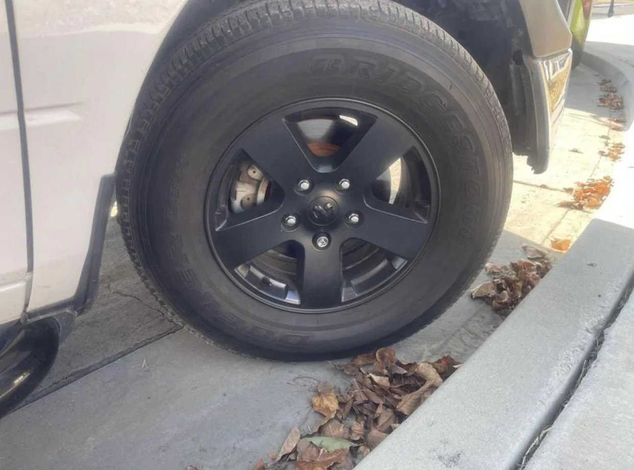

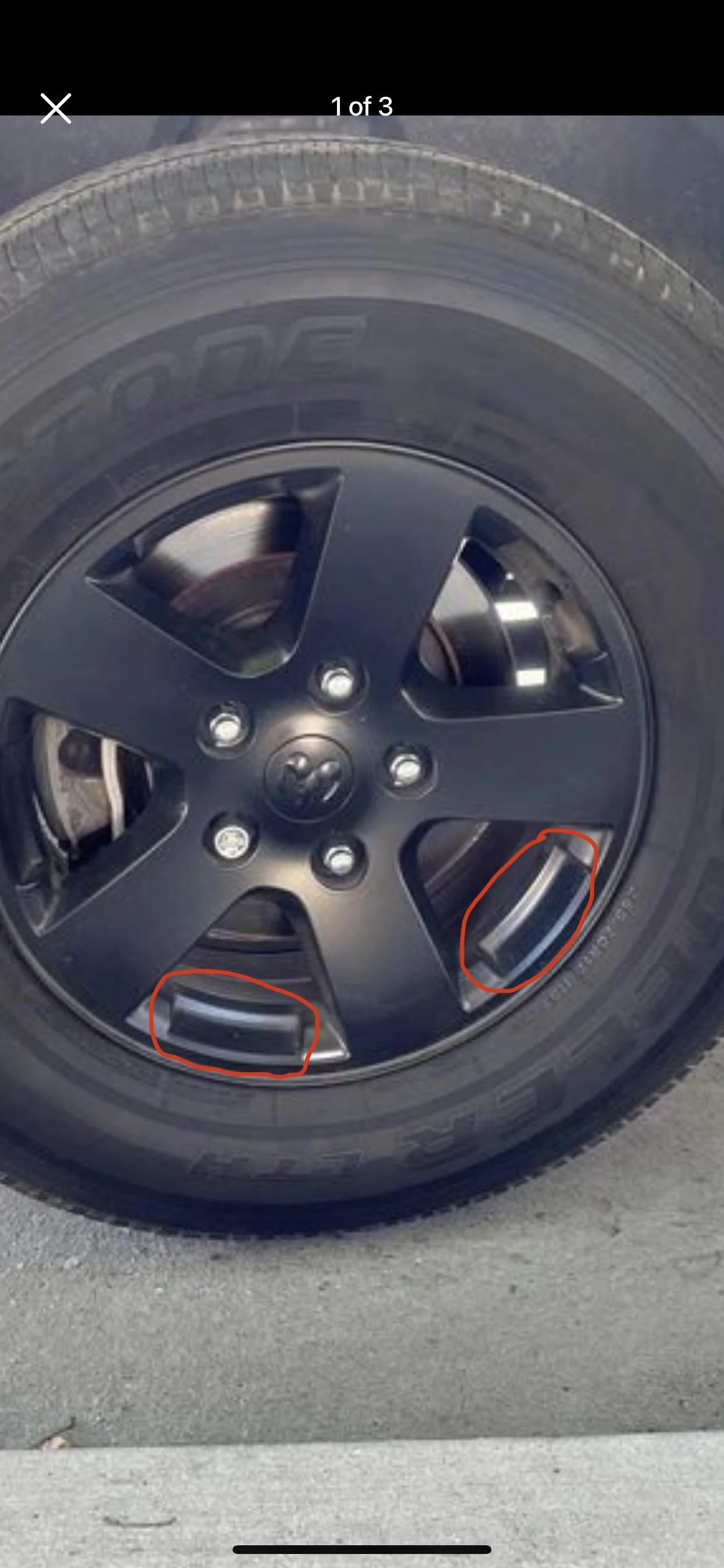

Almost jumped on this one until I noticed the “cutouts” between the spokes. I now know the spokes are completely flat all the way to the edge. But gotta look out for small differences like this….unless this may fit?
Rivian R1T R1S Affordable Winter Wheels Setup: Ram 2363 739235DD-619F-4F67-869F-491487C8EDE0
Cutouts here.
Rivian R1T R1S Affordable Winter Wheels Setup: Ram 2363 E8298DAA-380A-47B1-9318-F0C544325F55
Cutouts here.
Well, these are new to me. I can't find anything on them, but they're pretty similar. Wanna give them a go and report back? If you try one front wheel, you'll immediately know if it fits.
Cutouts here.
Isn’t that a 17” wheel? Tire size isn’t clear but sure looks like 17 to me.
