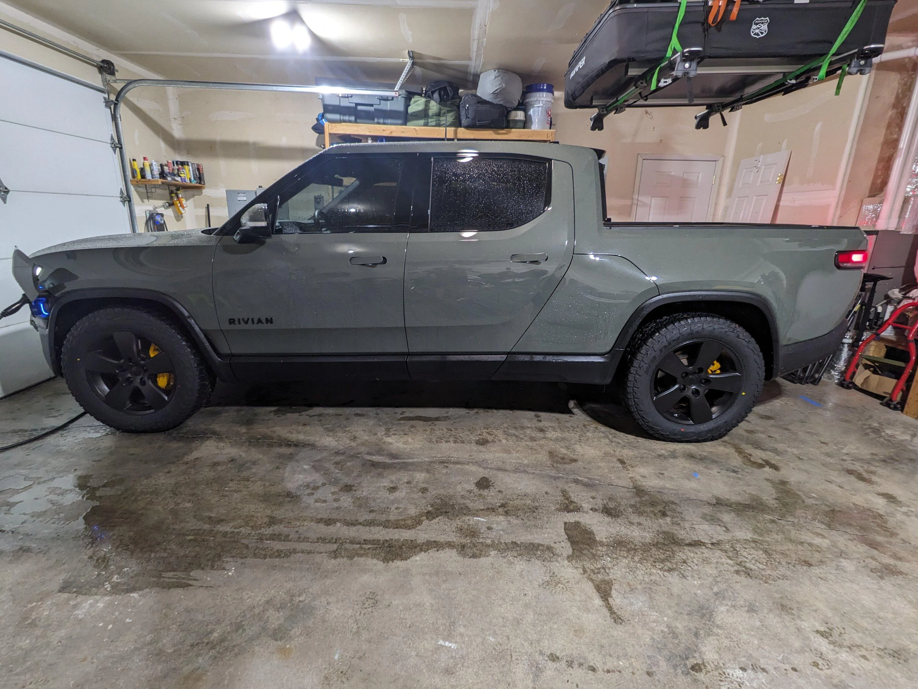

Don't tempt me to search for one, I just started building another set. Pirelli AS+3 was just $196 on Amazon and I snatched them up, they're back to regular price now. I don't know what happened but it saved me like $200!
I just put my new boots on and love them so far! I did a quick loop in the rain and dark, nothing over 50, but they bite in real well. I can't wait to get them dirty. Forgive the terrible pic, I'll get a better one tomorrow.

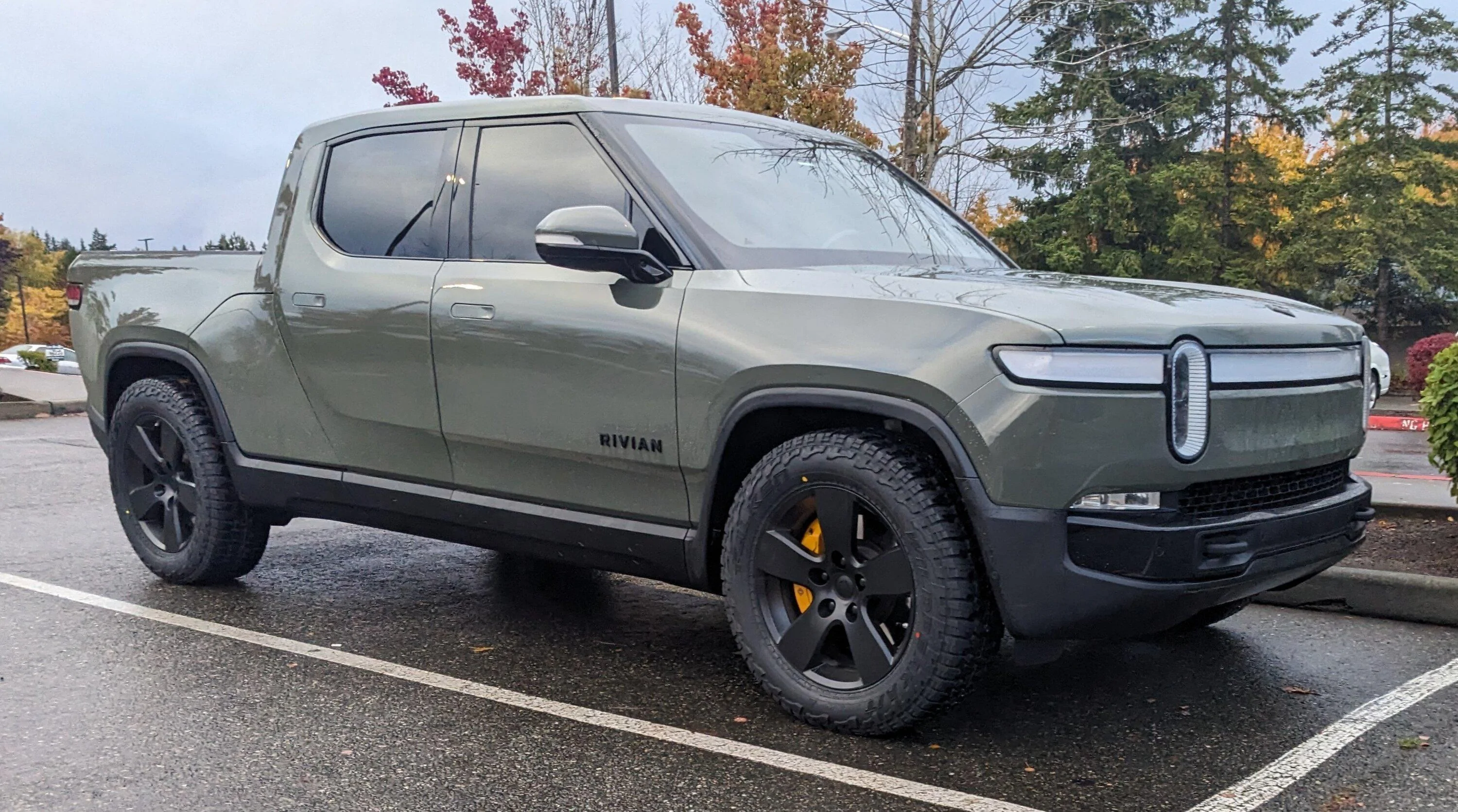

I've started looking for the Ram 2363 wheels, but surprisingly it is more difficult than I thought.
There are a LOT of Ram 1500 wheels from early model years on FB Marketplace and Craigslist and while they look the same as the 2363, they are something else like 2495.
Does anyone know if the 2495 20" wheel will fit? It is from a 2001 to 2018 Ram 1500. From photos it looks exactly the same as the ones above.
Are hub centric rings needed for the 2363? Thanks!
I'm picking up another set today from a junk yard, I love the looks and might put my AS wheels on the new set! There's just enough overhang to make it look squatty and buff ???
I've had luck on OfferUp and Facebook Marketplace.
2495 definitely DOES NOT FIT. Don't get it.
Hub centric rings aren't necessary but make life way easier when mounting them. The wheel won't sit right until you tighten the lugs all the way, and you'll be shimmying as you go (I learned as I noticed I forgot to put one on). They're cheap and worth it, use a mallet to tap them into place with some anti-seize lube.
Thanks! Sadly a lot of people I reach out to never respond.
Regarding your comment about hub centric rings, it seems they ARE necessary. The up/down force of the wheel against the rotor should be taken up by the hub/ring. The lug nuts should only be holding the wheel against the rotor. It should not be holding the weight of the vehicle.
If that makes sense.
Go on eBay and see if there is a local place selling for you to do local pickup. That was key in me getting a decent set at decent price.
In a lot of the cases, it's shipping that kills the deal.
From earlier in the message thread with the stamped number you need to look for. You may want to search using this to be more sure.
I found a set of Dodge wheels. It took some time and research and I discovered a few facts along the way. I was looking for a number 2363 on the rim but could never find that number on any of the wheels I found. The number on the rims will be stamped with a 1DZ12TRMAB. The number 2363 is used by the Hollander interchange guide. Hollander is the reference book all junk yards use to cross reference OEM part numbers. So if you are searching for the correct Dodge wheel, the number on the rim you want will be the 1DZ12TRMAB number.
About time! Look great.
What RTT hoist are you using with green straps? Or are the straps for additional safety
Hoister Direct 7806 - Overhead Storage Hoist for Jeep Top Removal, Truck Caps, Bikes, SUP, Dinghies, Canoes, Kayaks, Surfboards and More. Mount in Your Garage, Shop, Anywhere with a Ceiling. https://a.co/d/56bb7is
Green ratchet straps are safeties, just copying other great ideas I see on here!
