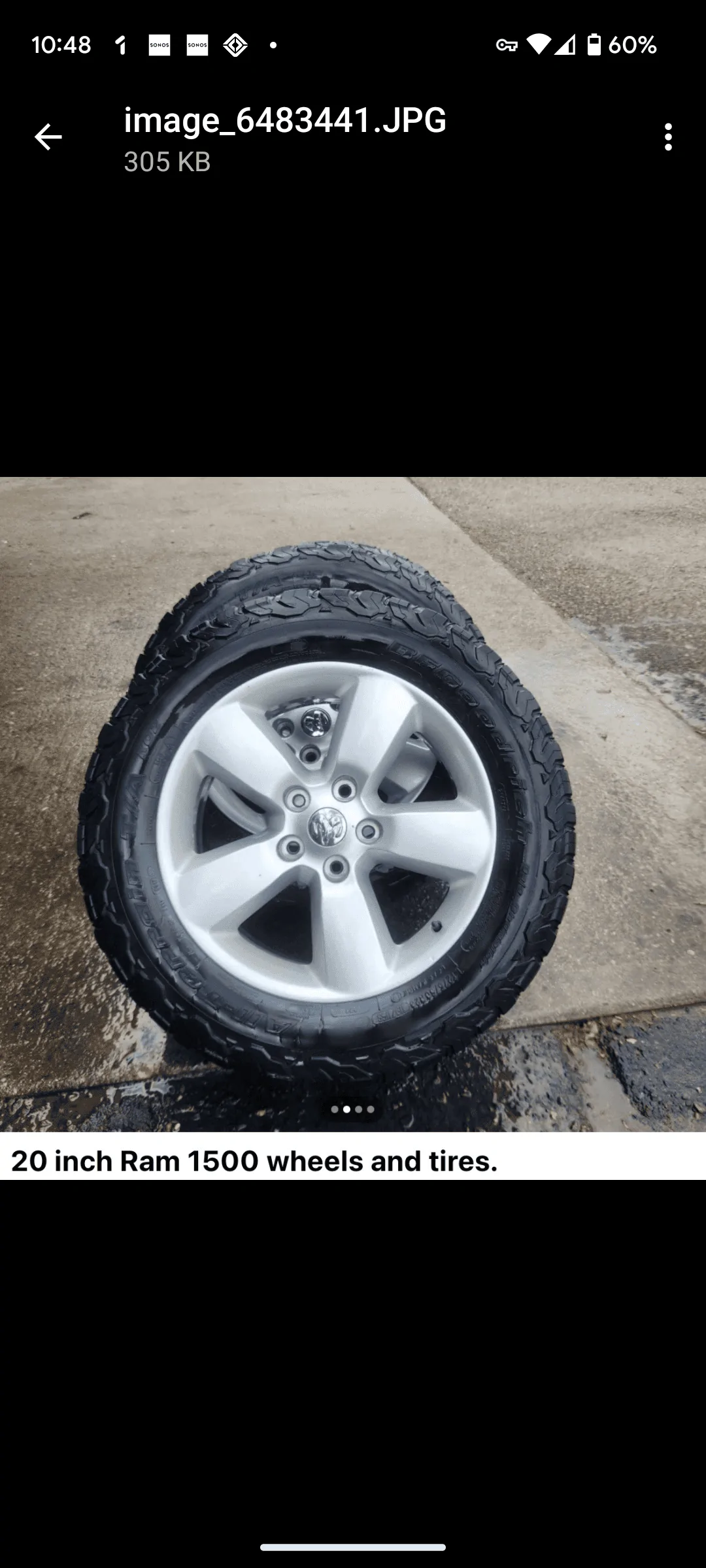

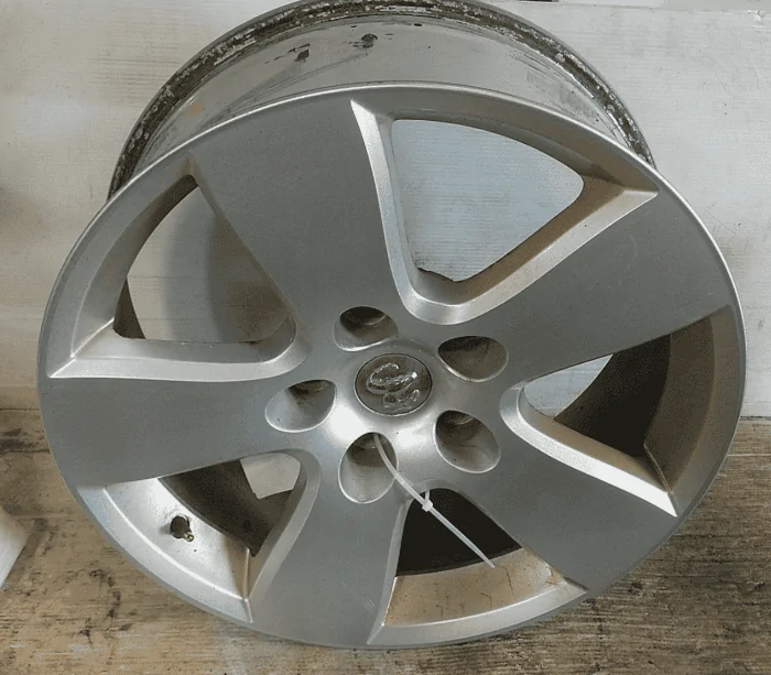

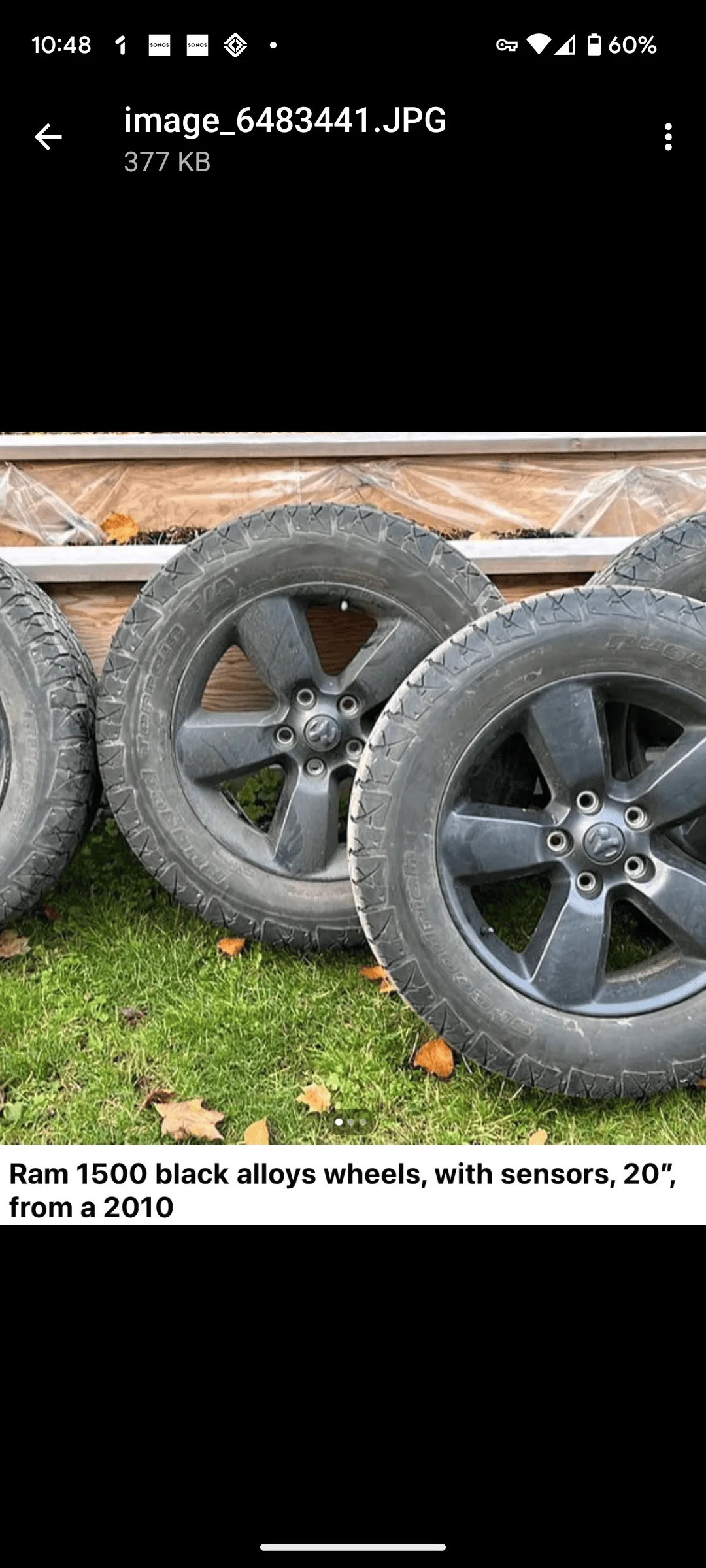

Hi: I am having difficulty getting used Ram 1500 "2363" wheels with the specific part number 1DZ12TRAMB. I see from recent posts that there may be other Ram 1500 "2363" part numbers that will work, like 1TQ79TRMAA. Can anyone provide a list of all known Ram 1500 "2363" part numbers that will clear the brake calipers?
So 1ub17trmac won't work??

I have no idea what those numbers mean and a quick DuckDuckGo links some shady websites I'm not willing to click on. Please provide a pic, like the fellow below
Here are two with the 1ub17trmac part number. They "look" like the 1dz12tramb but looks can be deceiving.
Rivian R1T R1S Affordable Winter Wheels Setup: Ram 2363 Screenshot_20231101-224857
Rivian R1T R1S Affordable Winter Wheels Setup: Ram 2363 Screenshot_20231101-224844

Those two pictured above will NOT work. They are not the correct wheel. Notice how the spokes are rounded and don’t extend flat toward the edge.
They are common Ram wheels but unfortunately not the ones you need.
