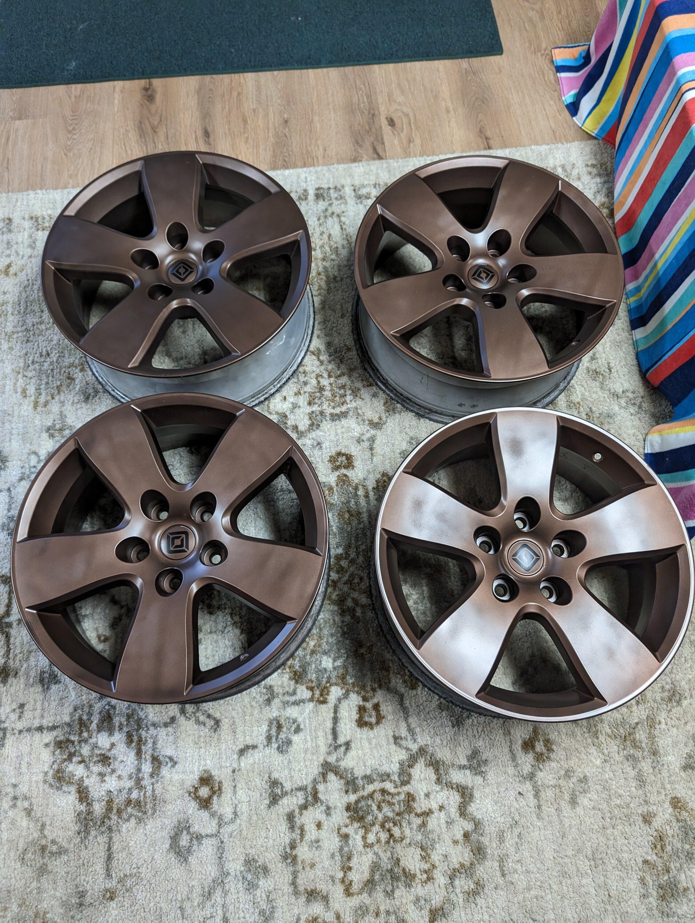

Mar 29, 2021
123
6,484
10,952
Kitsap, WA
Ready for rubber!
Not perfect but for a winter set, it's def good enough for me! Was a bit windy while painting but I only had the one warm day to get it done.
Going to go on a FG R1T

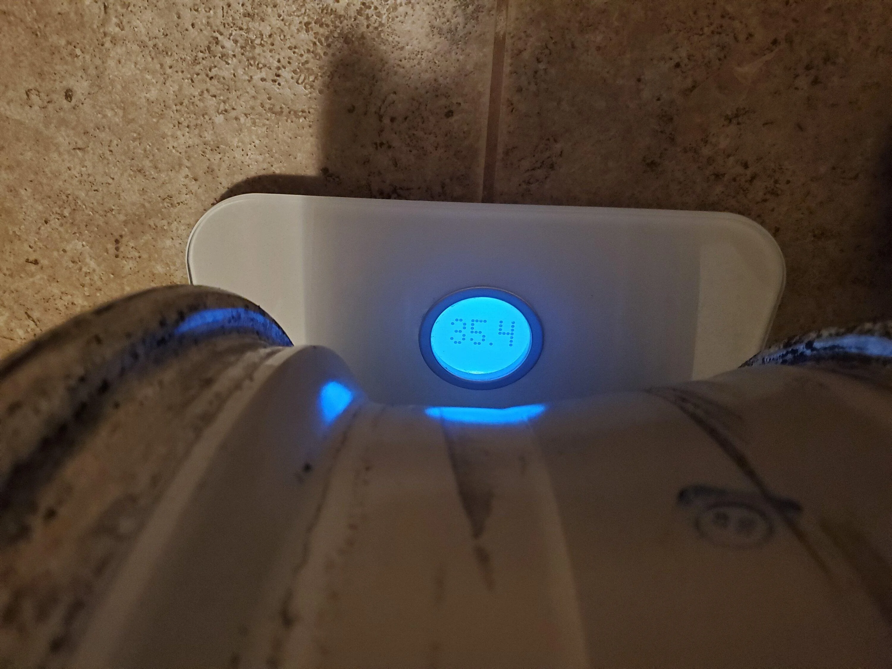

Not sure if this has been reported in here yet but I put one on a home scale tonight just to see.
I saw various reman/second hand websites saying 38-41 pounds so 35 is a pleasant surprise?
