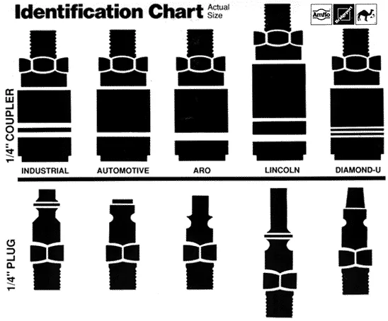

The air connector you want is. Industrial type D you can tell that by the two bands on the female end. The threads will be 1/4 NPT
