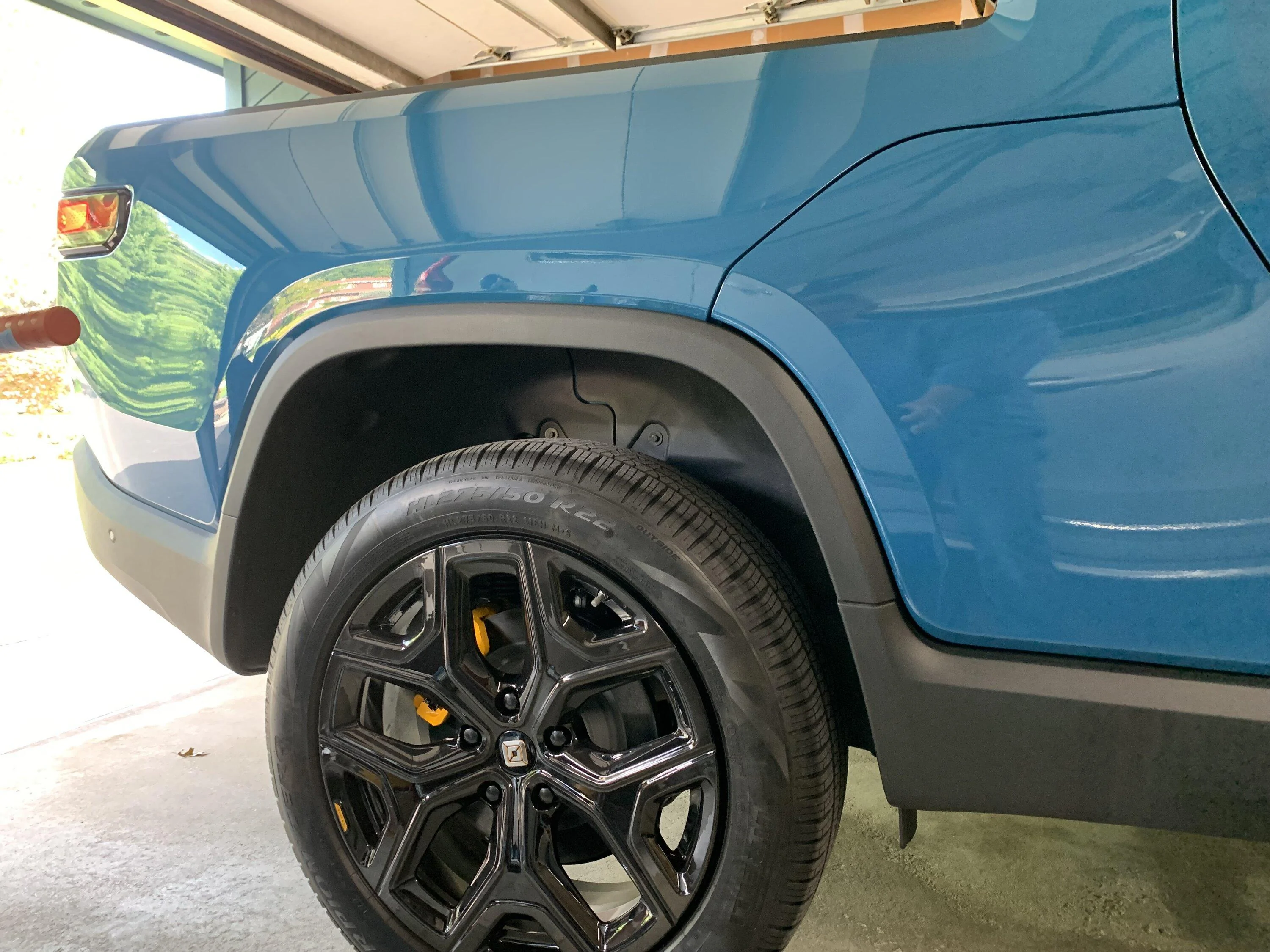

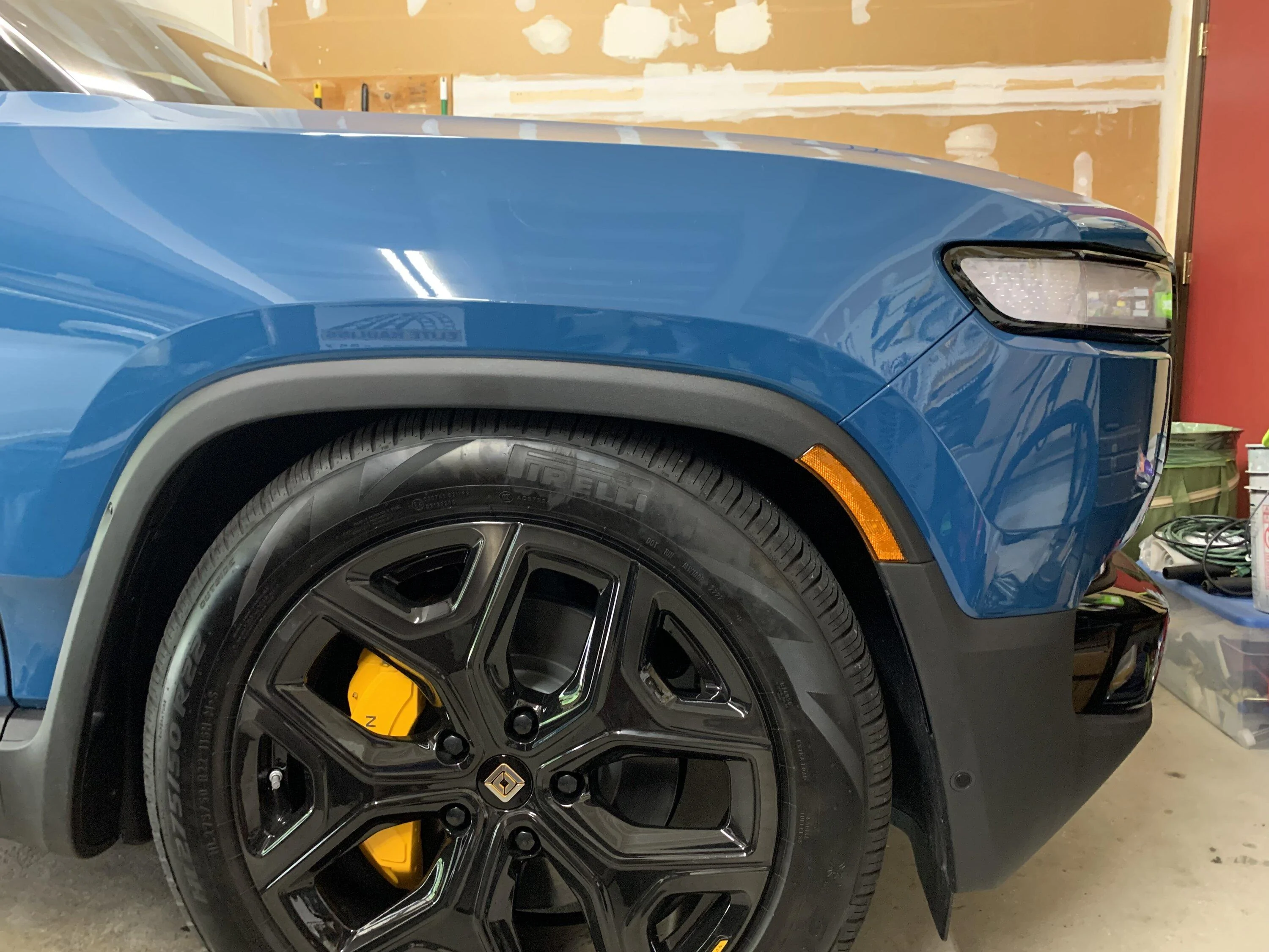

Changed the compressor and checked the lines. Got it back , took it for a ride, and then took those pictures. This is the third time they are working on it. It gets worse every time they do. Got it last AUG. 22. It has traveled more miles on the back of a tow truck than I have driven it. Good luck with yours!
