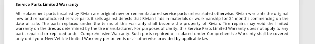

If you buy the battery after 36 months of owning the car, it comes with no warranty. But, please tell me I am wrong. I would love a warranty.

I specifically asked the SC when they replaced my 12V last month and he told me that it has a 2-year warranty. Of course, I didn't get it in writing...
You are wrong.
How was that?
5,801
10,199
2022 Rivian R1T LE
It's in writing on the service estimate:
Rivian R1T R1S Another 12v battery replacement (again)? Screenshot_20260226_211354_Rivian

I talked to tech at rivian today. You are right. If I am paying for battery after the warranty ends, it has a 2 year warranty for defective. This was my second replacement.the first under warranty and now. So that under warranty battery they don't attach a 2 year warranty. Only for ones we pay out of pocket afterwards.
