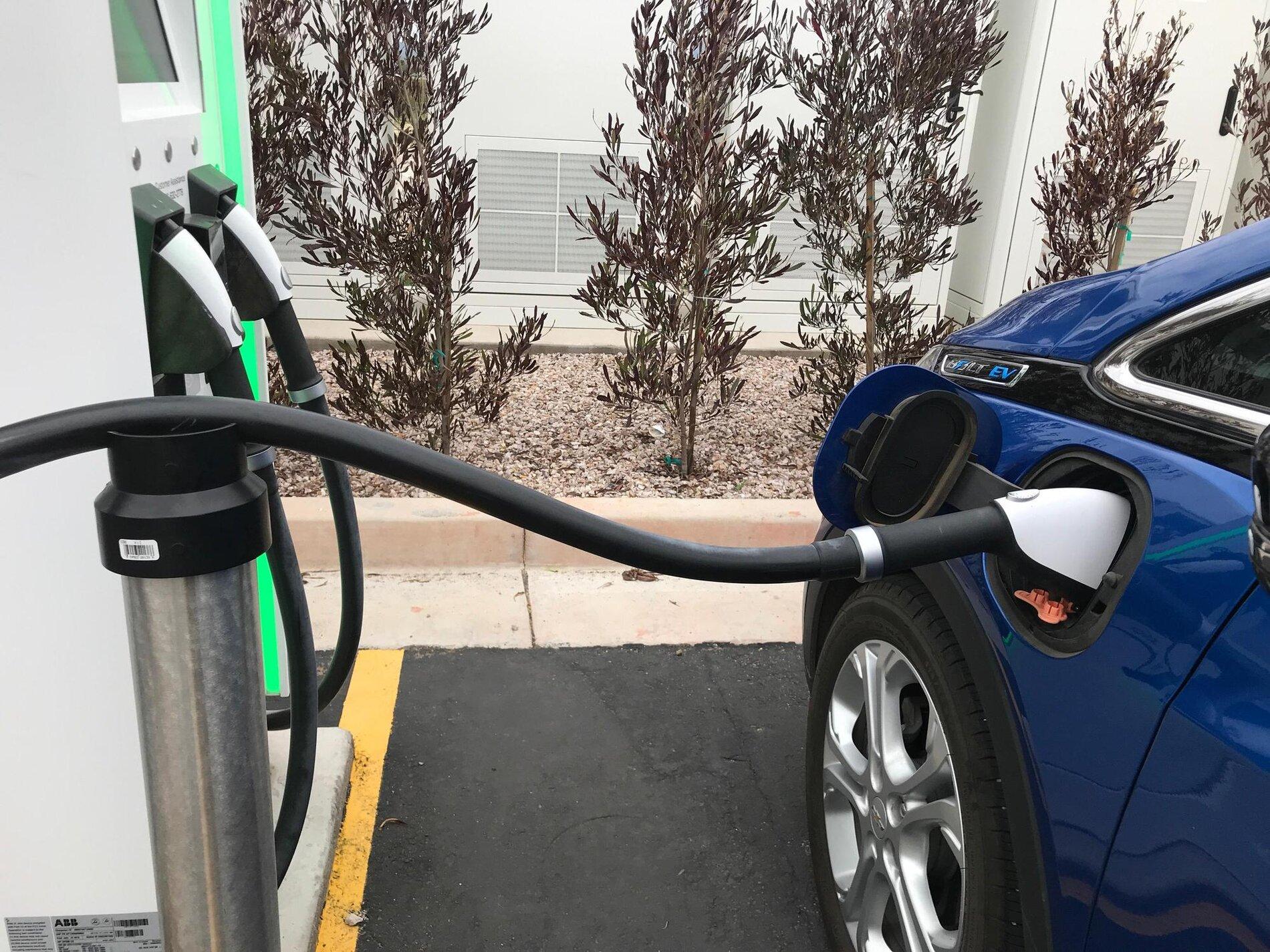

The Bolt has an issue with the really heavy cables sometimes preventing the locking latch from being able to engage. These stations didn't exist when they were designing the Bolt, so it wasn't something they would have ever encountered in testing. The trick is to lift up on the cable just enough to take the weight off the charging port until you hear it engage. Not always needed, but there isn't any indication that could be what the problem is when you are trying to charge.
I have an easy solution to that problem, carry this in my car.
