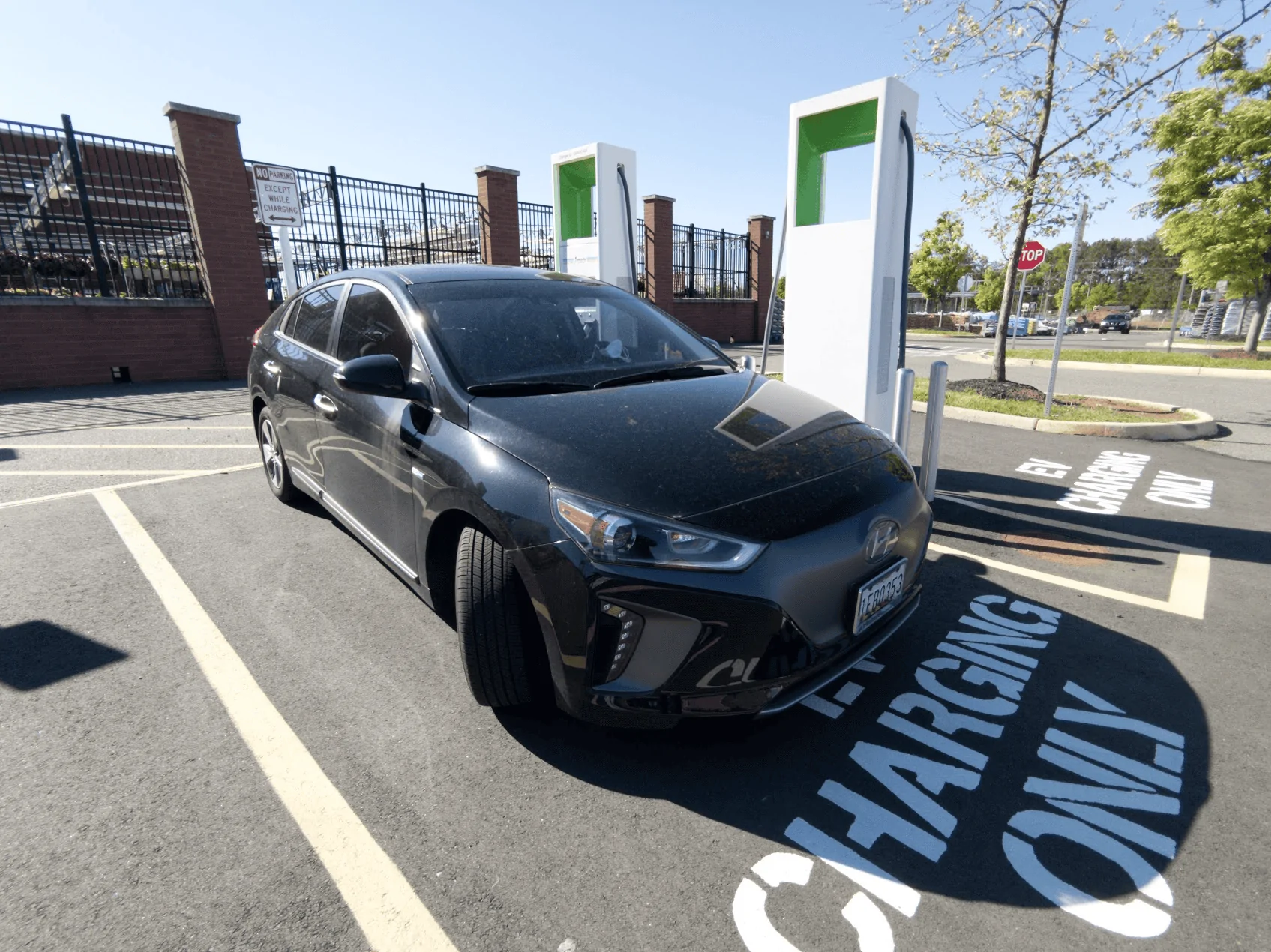

I would Say of all the providers they are the main ones of 150kw+ charging across the USA. I have used them on several occasions and their stations work well probably about 75% of the time, if you check out insideev Kyle/Out of Spec motoring you will see his road trip videos and how he try and uses EA chargers with a somewhat successful luck. Most of the time the vehicles charging curve is what is the issue and the vehicle plug and charge (Mach E) has become an issue lately as it doesnt work well with EA fast charging for some odd reason.
To answer your question, it works, mostly well, most of the time. It would save lots of time if you had a EA account + their NFC pass and or their app which I would only buy when road tripping really.

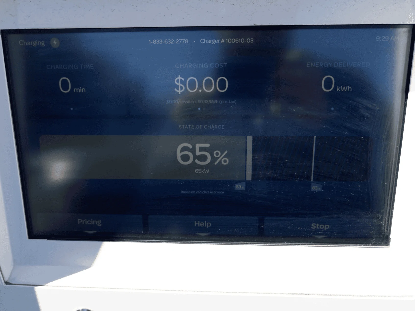

Because of Kyle's video that I discovered the same throttling on my 2011 Leaf, not that I road trip it much...well with about 50 miles of range tops I cannot get too far...but I digress..
The Leaf's ChaDeMO loves to taper really bad past 55% Tried it last time I drove to Seattle and back monitoring the pack's temps with LeafSpy. Granted I don't use it often in situations where I need to DCFC. But when I do I've just always planned for a solid hour of charging from 20-80%.
Here's what I discovered - from anything less than 20% to about 55-60% it'll pull about 40kW. Tapers down to about 15kW by about 65%, so I tried his trick. Stopped the session, started again and I was back up to about 35kW! Win. :cool:
Granted this is dial-up bandwith compared to the fiber-like connection of 100+kW many EV's can pull these days, but compared to L2 at 3.3kW...it's all relative. :)
