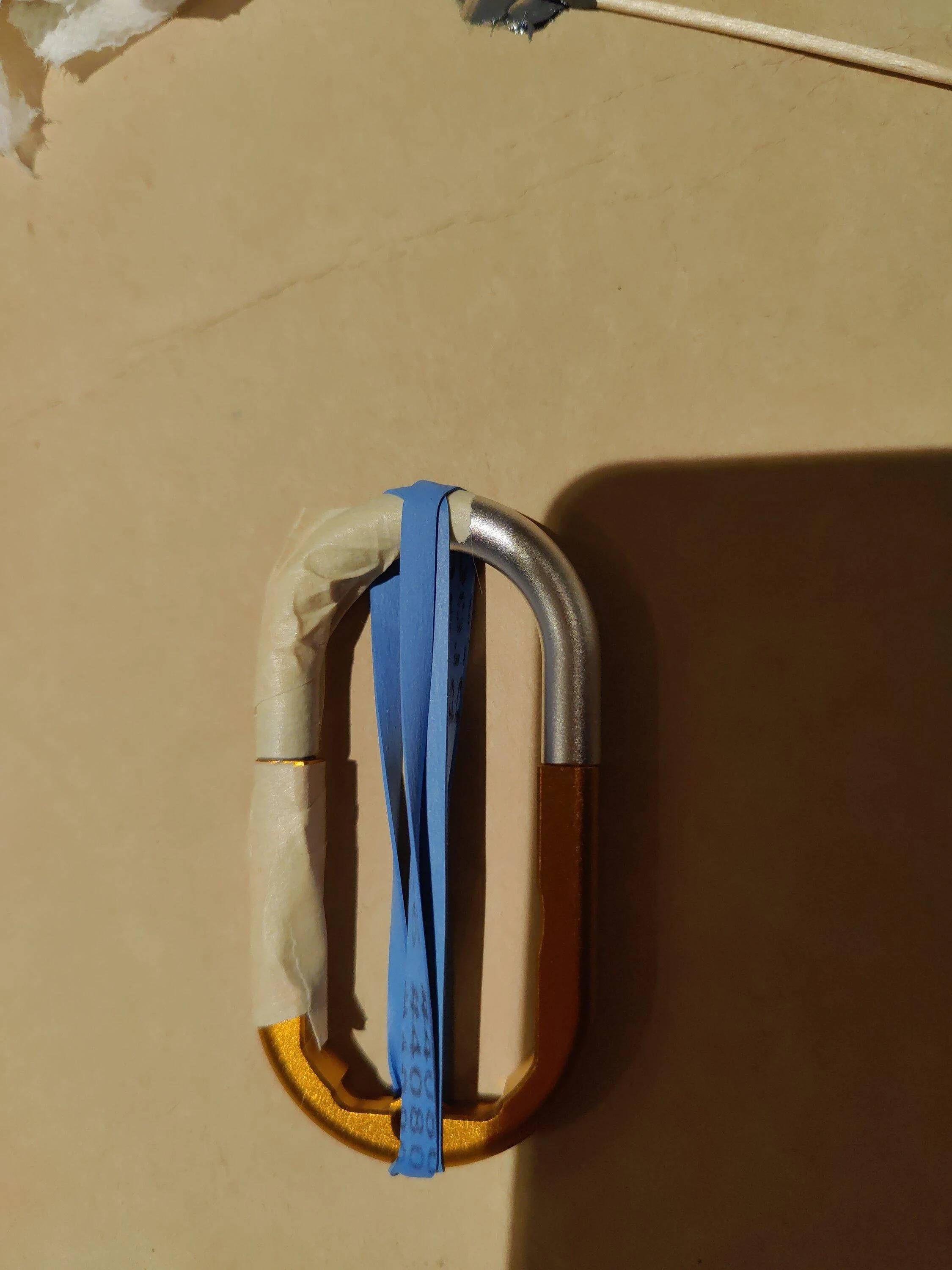

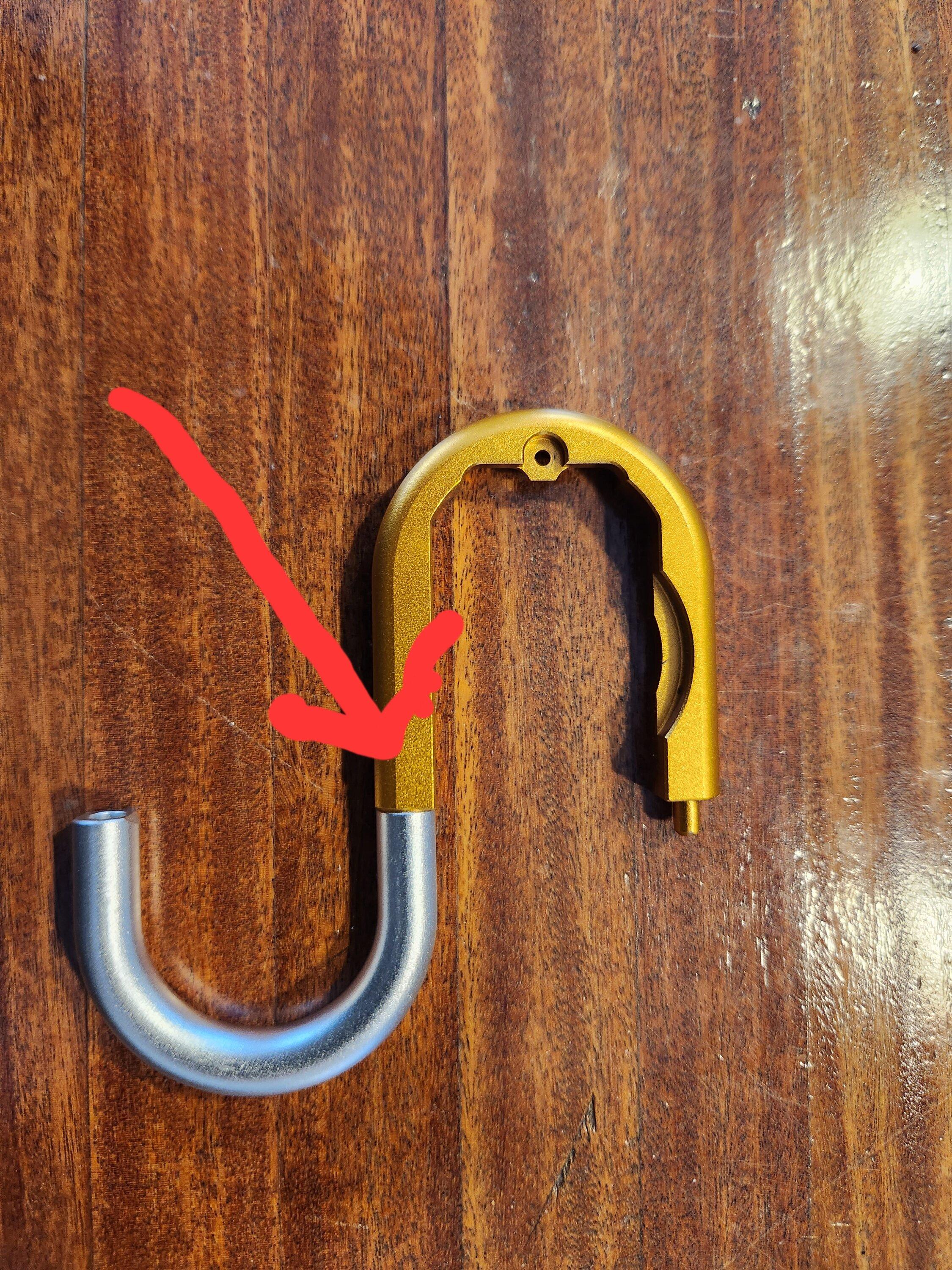

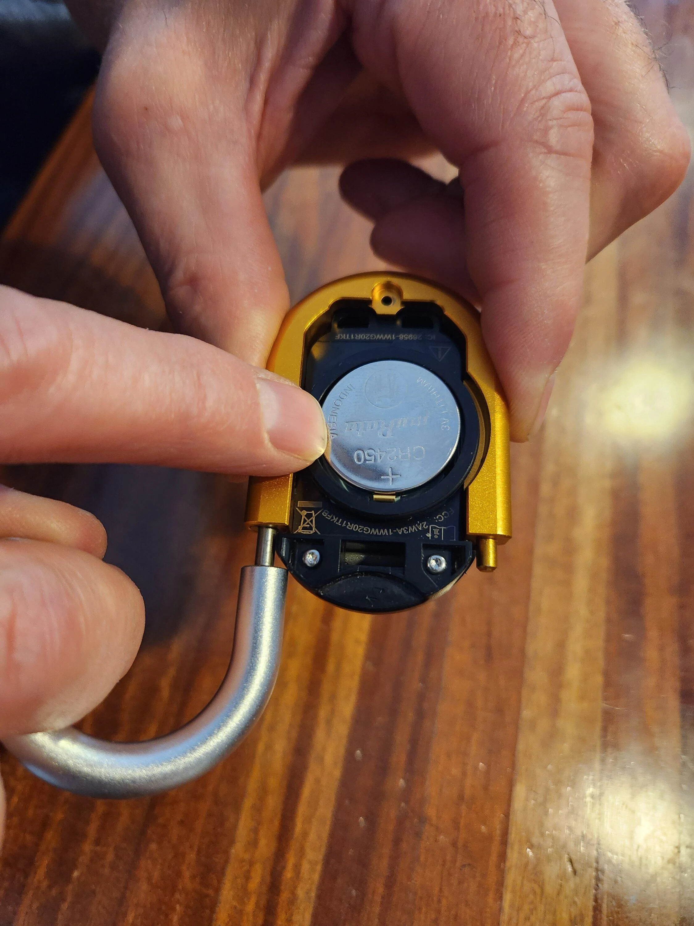

I prefer to have the fob on me for easy frunk access for groceries and the like. It does open way too easily however and I thought of various ways to add a magnet to the design for more pull resistance. I decided on a simple solution. Disassemble the fob to separate the metal carabineer by removing the back and taking out the three screws holding the inner plastic to the metal frame. Mix up a little jb weld and fill the little pin recess in the side that swings open. Clamp it closed with a rubber band and wait. I also added masking tape for squeeze out but it wasn't really needed. JB weld wipes up easily. I now have a key fob which looks completely stock but which can't be opened.

Second pic is the after shot. Just remember to put a key ring in before you glue it so yours doesn't get all stretched out like mine did.
