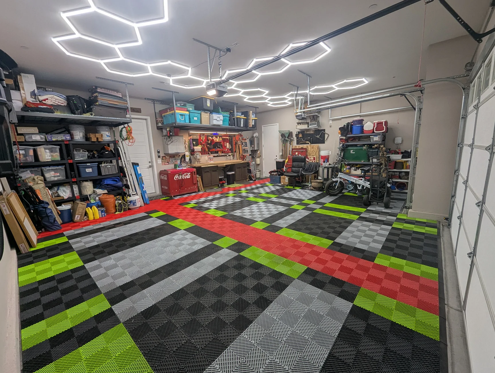

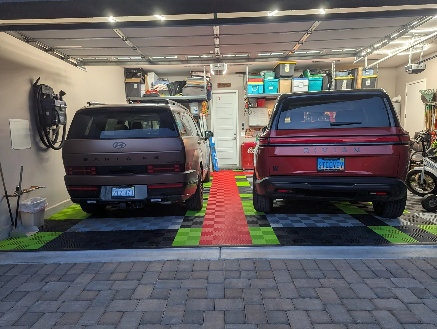

Why is it way better than epoxy?
The extreme heat from the tires when pulling into the Garage messes up the epoxy and it starts to look bad and just keeps getting worse over time. It then is VERY difficult and costly to repair. The Tiles are way better and if one breaks for some reason, you can just pop it out and put in a new.

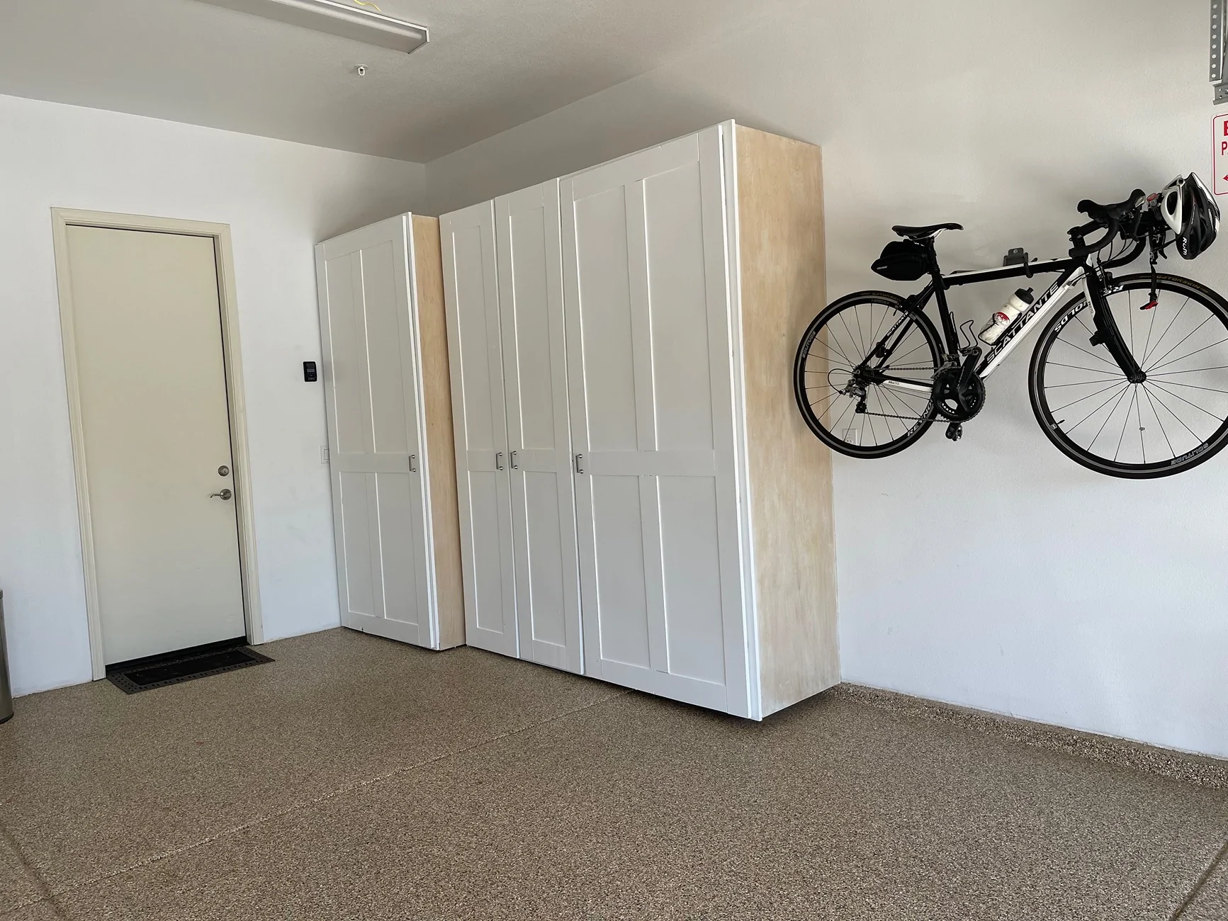

I’d be curious as well. I have a garage in Coachella Valley with an 11 year old epoxy coating that is still as good as the day it was done. Outside temps there in the summer frequently are north of 110 degrees.
7,503
12,880
I would question the installer if the happens. Maybe a DIY install might do that but a quality installer that should not happen. See my previous comment.
Edit; This is a picture in the desert, this is what the floor looked like after 8 years but looks the same today..
It could be poor epoxy quality as well. I imagine the good stuff is very stable at high temperatures.
