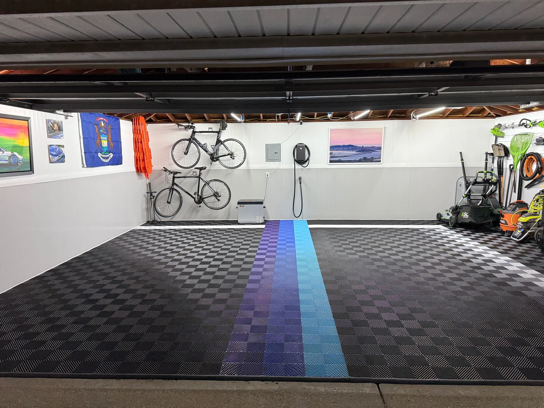

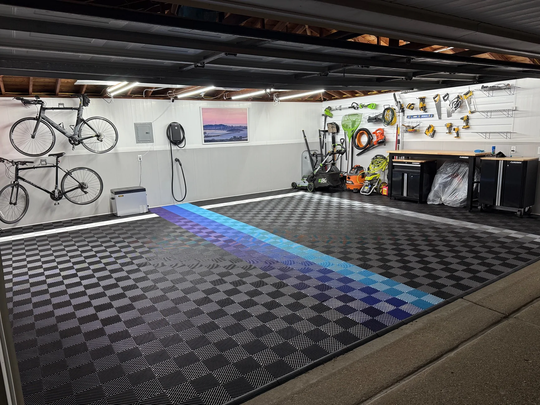

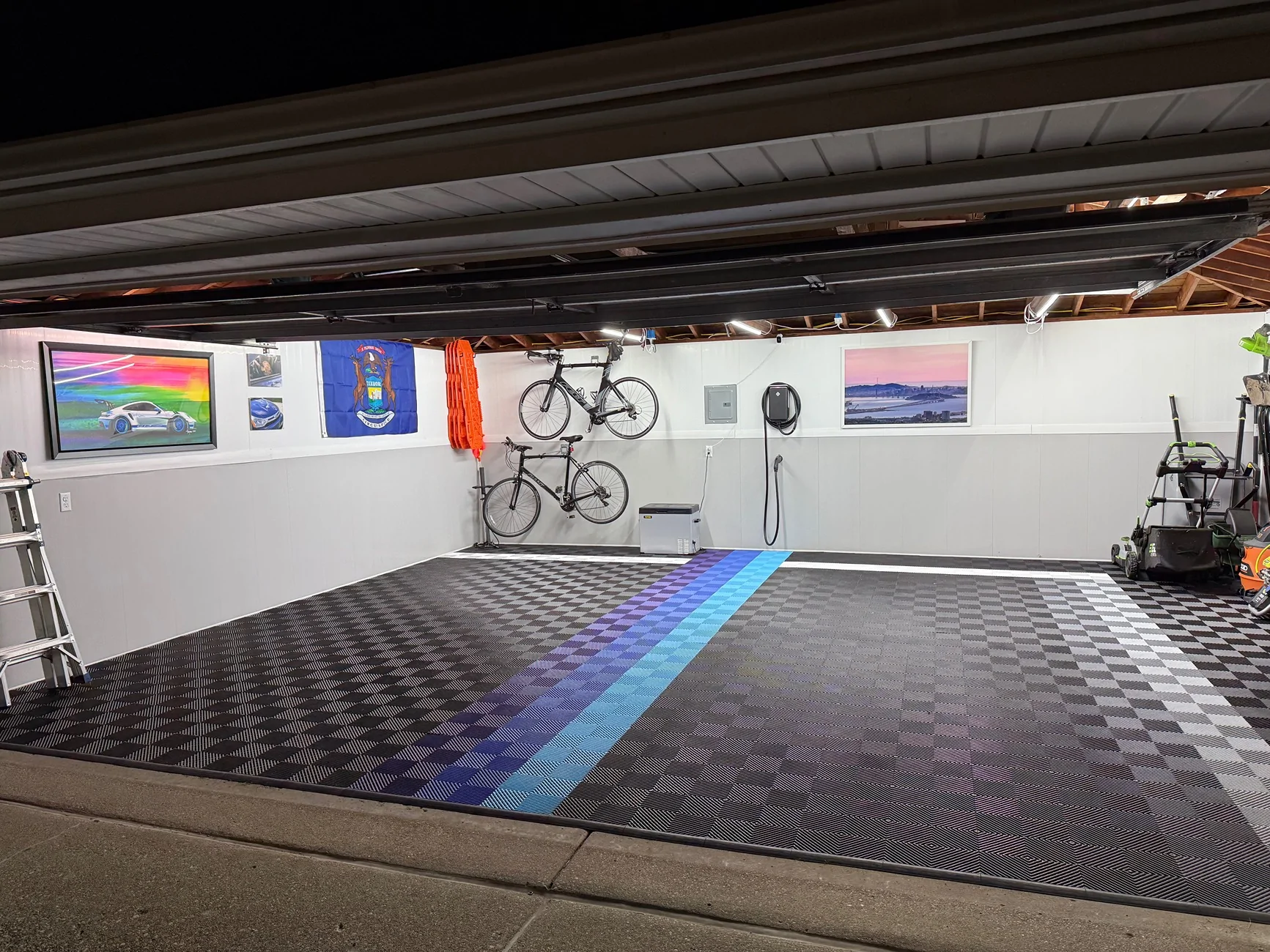

We have had the Snaplock Tiles for 3 years now, no issues whatsoever, from hot summers to cold winters in Utah. We had the epoxy but decided we preferred the look of the Snaplock.

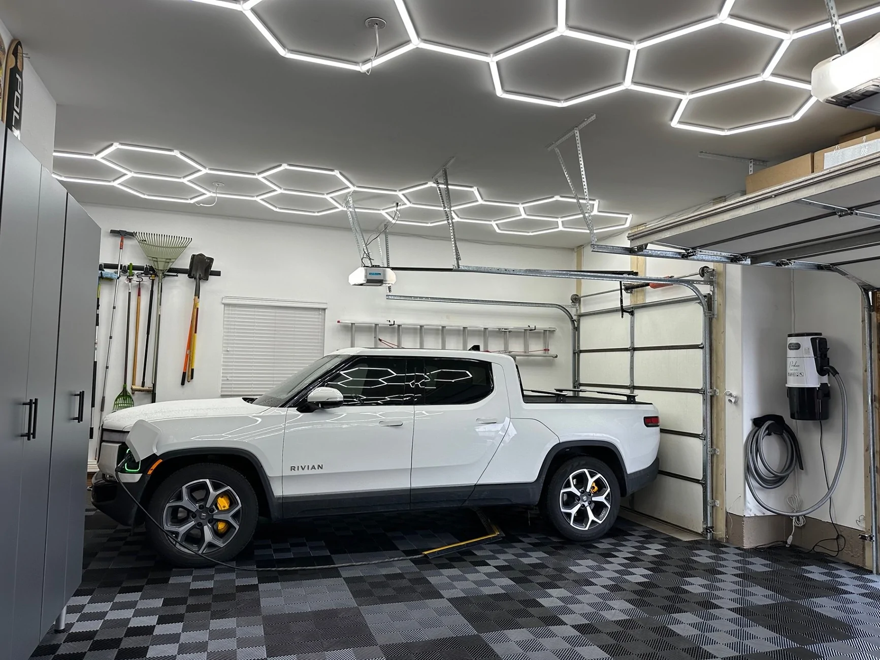

I have been parking my R1T on my interlocking garage tiles for almost 4 years now. The tiles directly under the wheels show wear and are a bit stained but are still usable. Something I have learned is if you want to rotate tires in the garage when you lift and lower each side of the vehicle due to the suspension design it will grab and stretch the tiles and unhook them from each other, so now tire changes are an outside task

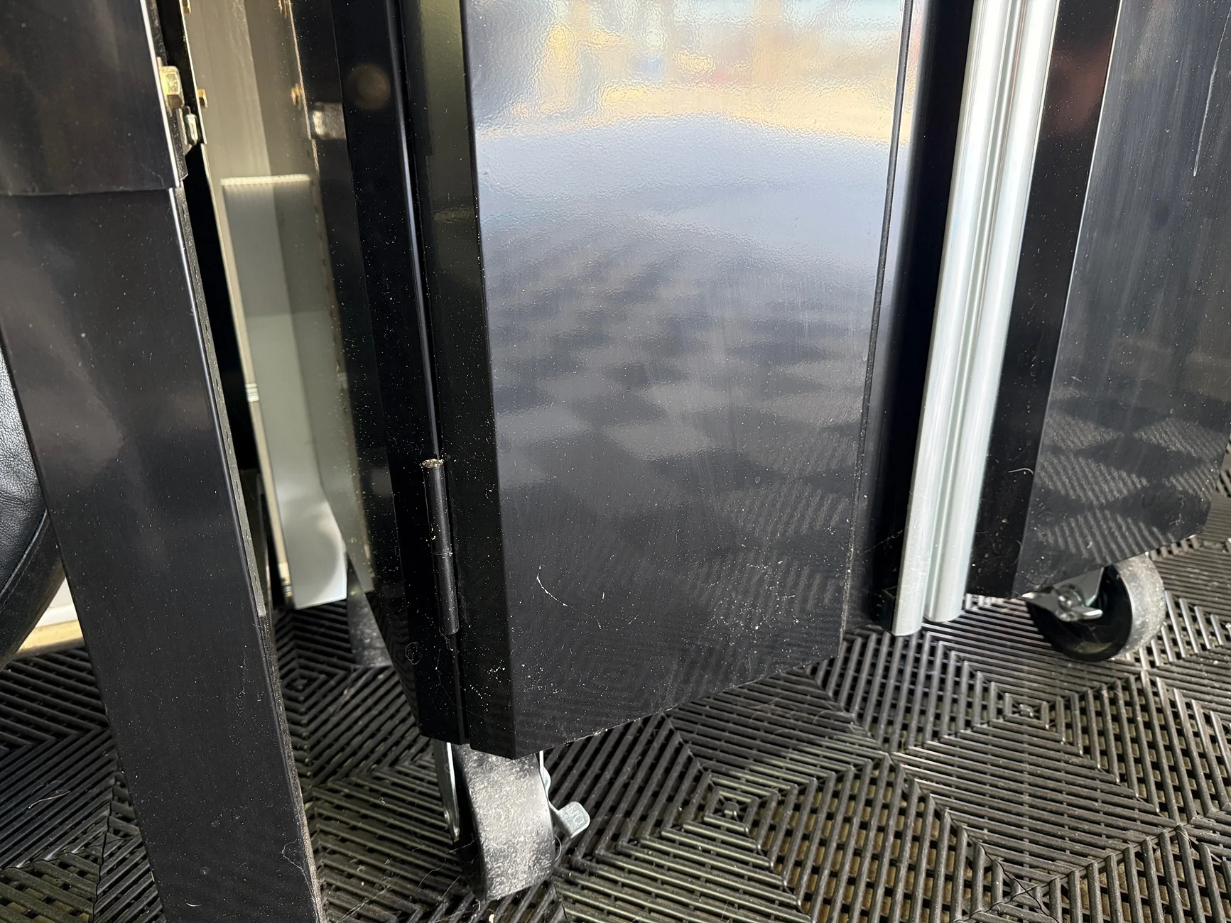

I was looking at the tiles that allow water and dirt to fall through, but was wondering how well tool chests and other smaller wheeled cabinets and things would roll across them. Not sure how big the gaps and ridges are on those types of tiles.
Rivian R1T R1S Anyone using garage tiles under their heavy Rivian? wheels
About a half inch center to center on the ribs, so most wheels should roll smooth.
