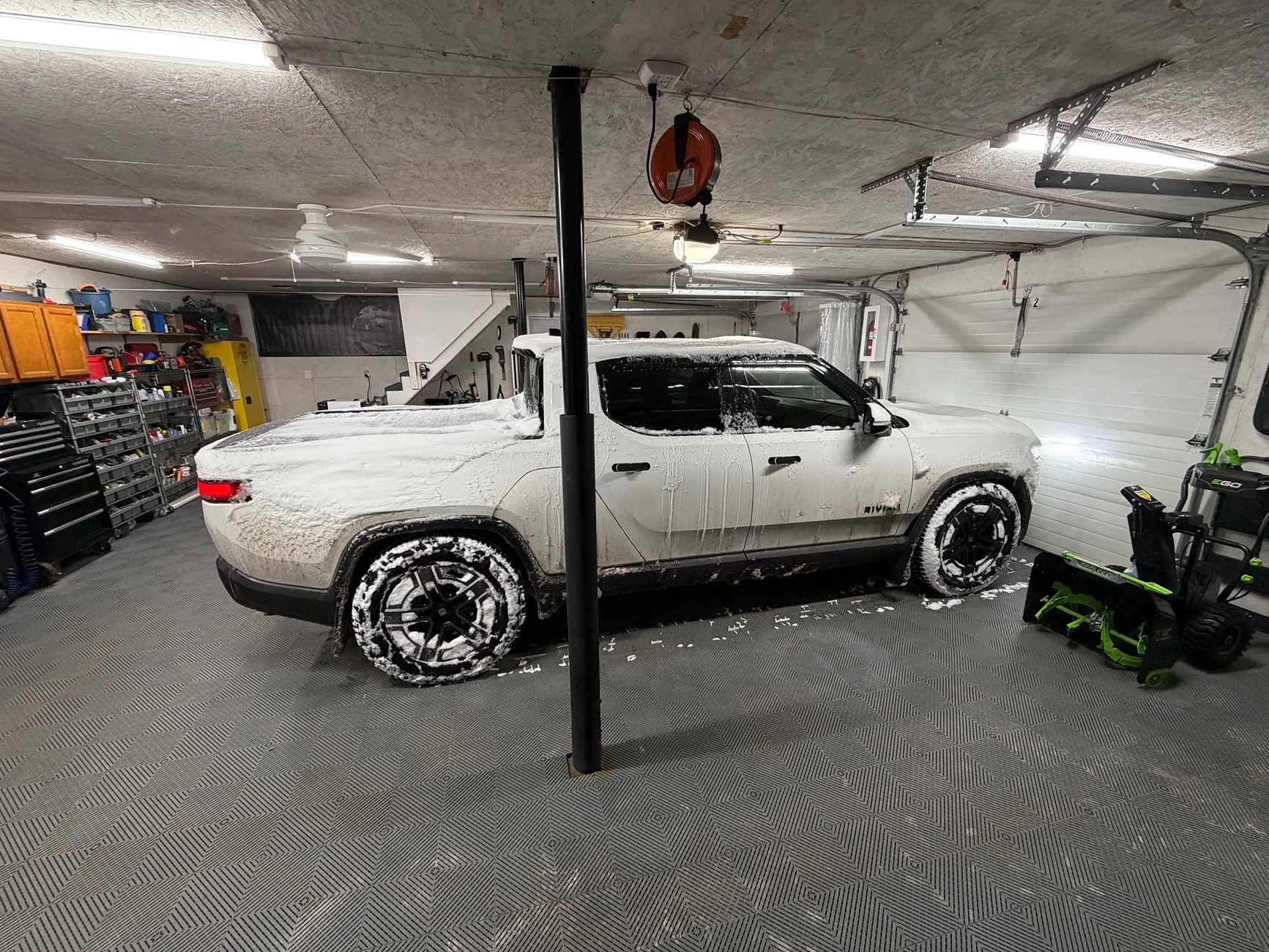

We have had the Snaplock Tiles for 3 years now, no issues whatsoever, from hot summers to cold winters in Utah. We had the epoxy but decided we preferred the look of the Snaplock.

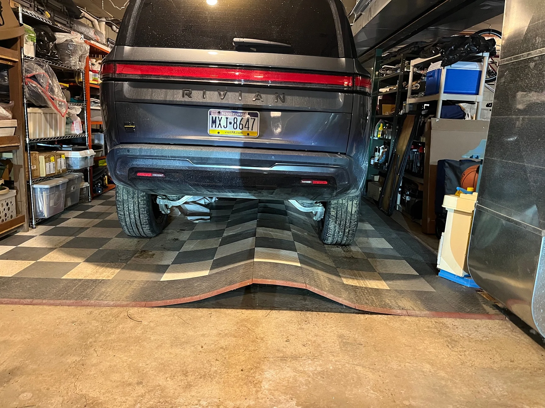

I have Race Deck tiles in the part of my garage where I work on stuff.
Today I worked on adding running boards to my R1S. '
First step is to raise the vehicle to its highest suspension setting.
I learned that doing this brings the wheels closer together, buckling the floor.
It straightened itself out when I drove off the tiles. Lesson learned.
Yeah, no. This isn't for me. I am going with epoxy.
Thanks for sharing your experience. It is very helpful for those of us still trying to make our garage look as nice as yours.

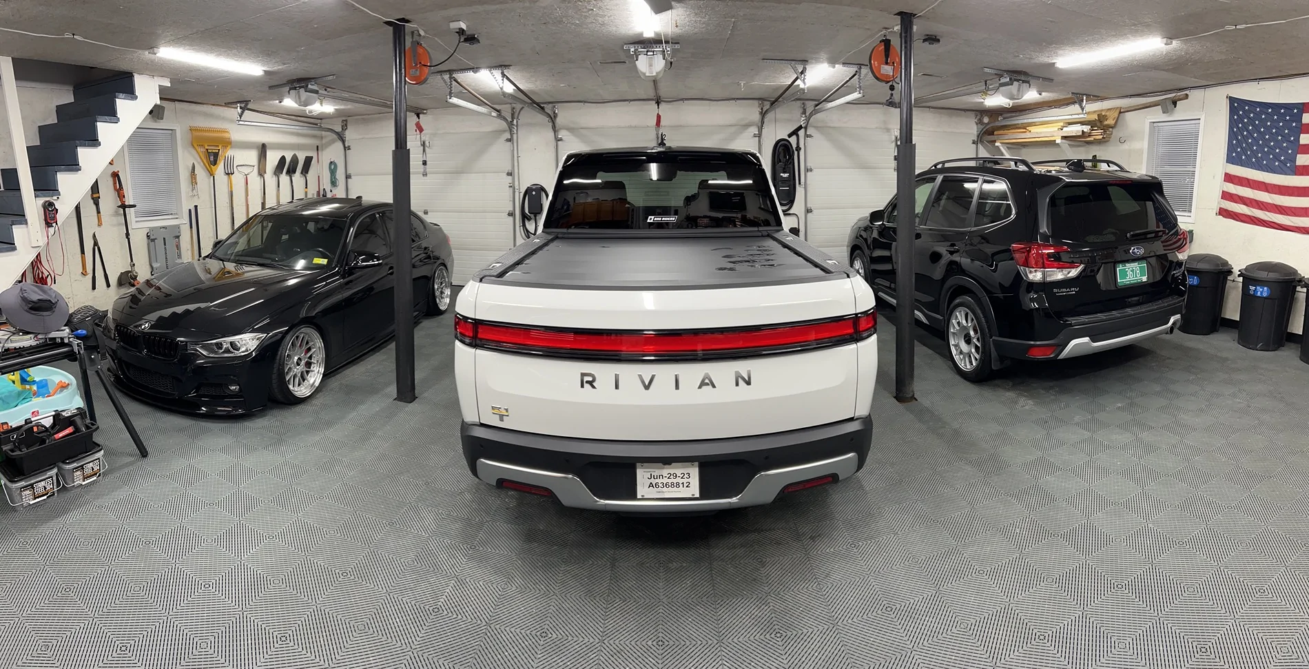

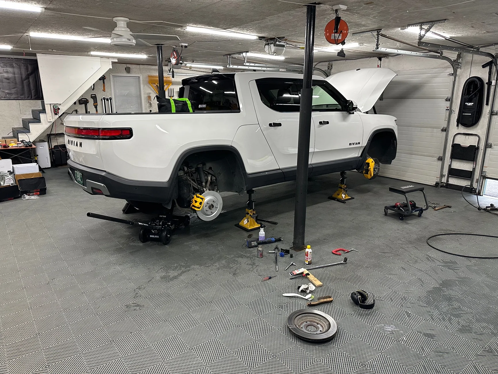

I installed Swisstrax eco tiles 7 years ago, and have had my r1t on them for 3 years. I have had no issues at all and they are amazing. Best mod I have done in the garage since everything drains perfecty under them and it always looks clean. Especially in our Vermont winters. The eco ones I have are lower strength and I can only see some slight groves now, but replacing where the tires drive would be very inexpensive. They have flat tops and everything rolls nice on them. I have had my truck on stands dozens of times and they don't move or dent at all. It is important to use stands with a wide base and an off road jack to distribute the weight. But that is the case with any car I lift.
