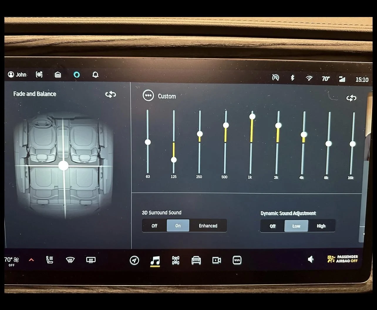

Maybe it's just my system but I feel like this EQ curve would make your ears bleed. But I also feel like my system (new Rivian) is weirdly hollow in the mids almost out-of-phase sounding, but also shrill and brittle on the high end. I've do a bit of EQ'ing to try and sort that out but I've never been entirely pleased with it.
Going by ear (I did sound engineering for many years), my EQ curve is fairly similar to the post from @SeaRivianR1s above but without such a strong cut at 125, a small cut at 250&500 (there was a boxiness I wanted to get rid off) and slightly deeper cuts at 4&8k, and no boost at 10k, and 3D off entirely
I'm still not entirely pleased with it, but honestly making more aggressive EQ moves wasn't making things better and seemed to behave weirdly... again making me feel like phase issues are a part of the problem somewhere but with 20-odd speakers interacting in such a confined space it's not going to be easy to track that down. Overall, not really impressed with the audio. On any given track it can sound decent, but I find it's not as consistently pleasing as previous vehicles I've driven, it's just not... consistent? Hard to explain. Also it just doesn't seem very loud given the amount of power that's supposed to be involved (again compared to similar values in previous vehicles) and the sub seems passable, but flubby/anemic. It does indeed get "loud enough" though, just feels like it takes a while to get there with less headroom leftover than I would expect given the numbers.
For all the hype it seems to be a "bit better than ok" at times and infuriatingly hollow or shrill in many others. And no amount of EQ tuning seems to significantly alter that. I'd love to see some kind of full aftermarket replacement option appear. It wouldn't be high on my list of changes to make, but it would definitely be ON the list.

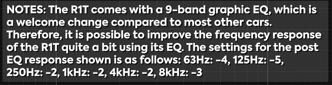

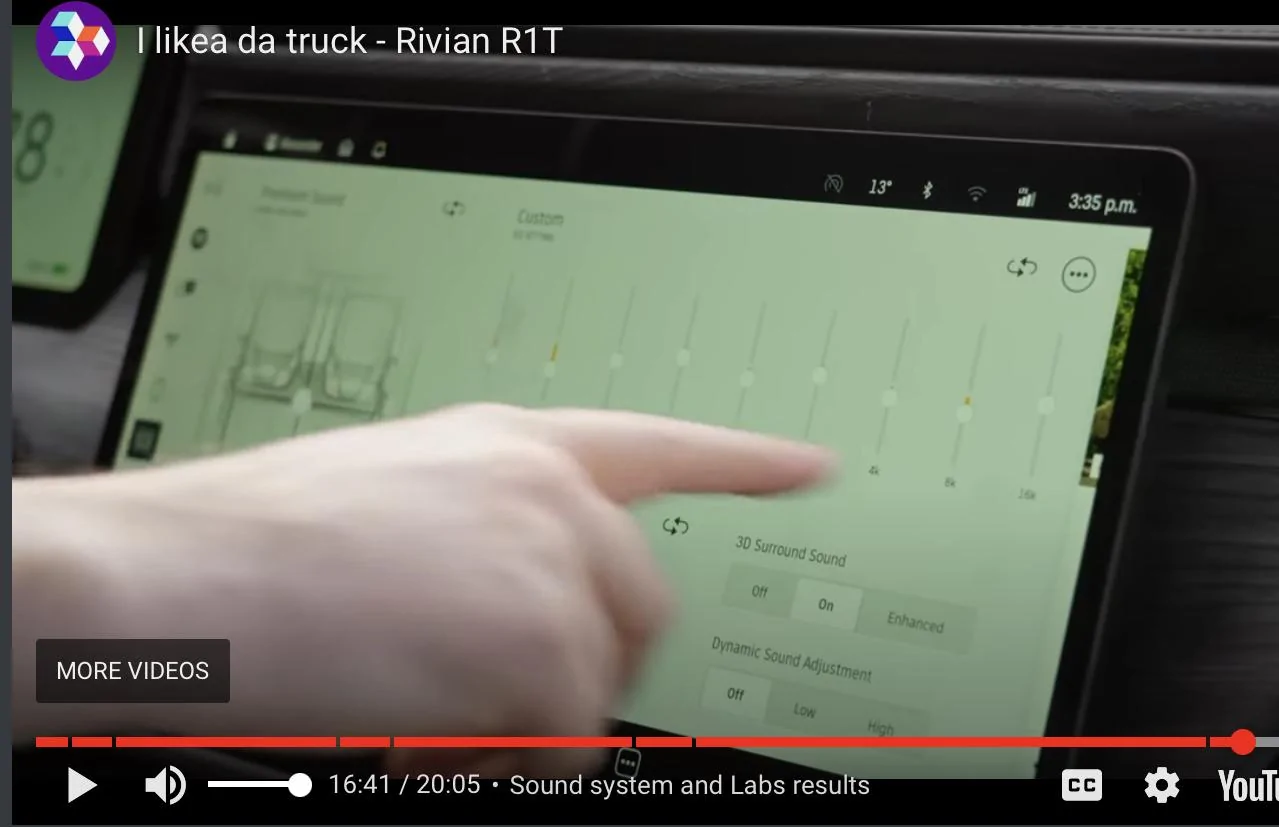

Linus Tech Tips reviewed the truck and adjusted the settings to hit a preset curve they had. I've been using it and it sounds pretty good to me as a general tune. You can see them talk about it and the settings here....

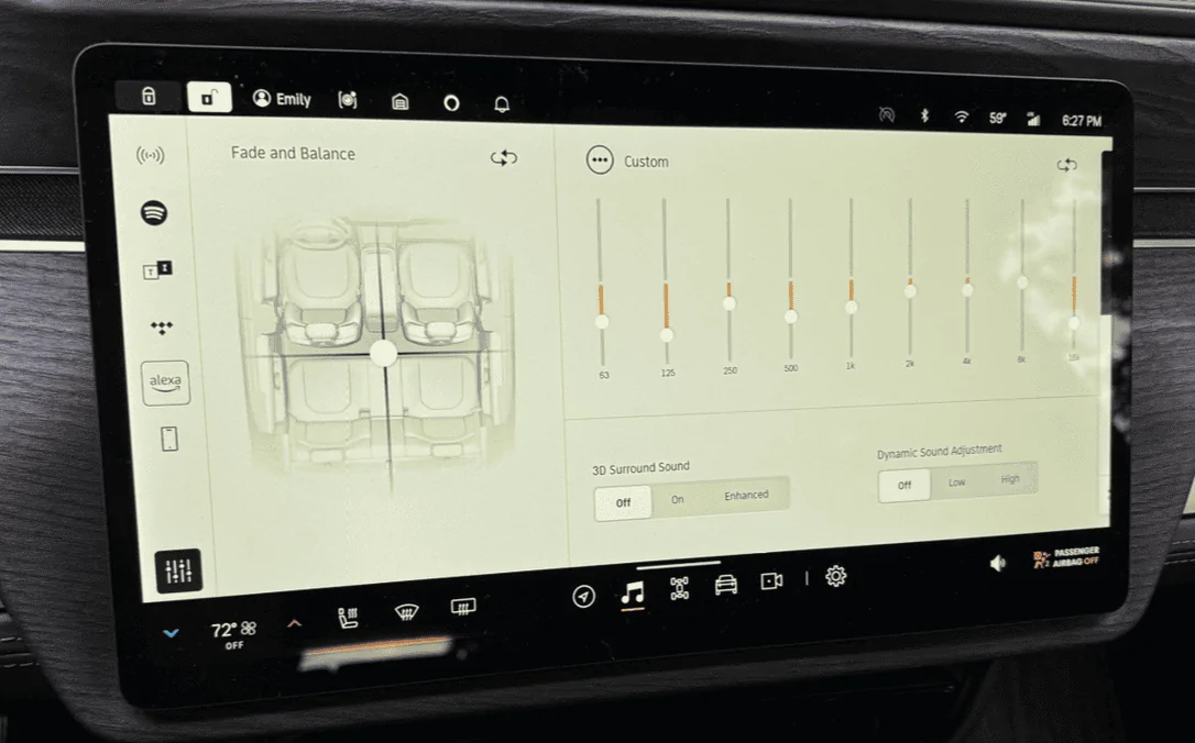

For those who couldn’t quite see the settings in the video:
Rivian R1T R1S Best stereo sound settings -- post yours! IMG_0027

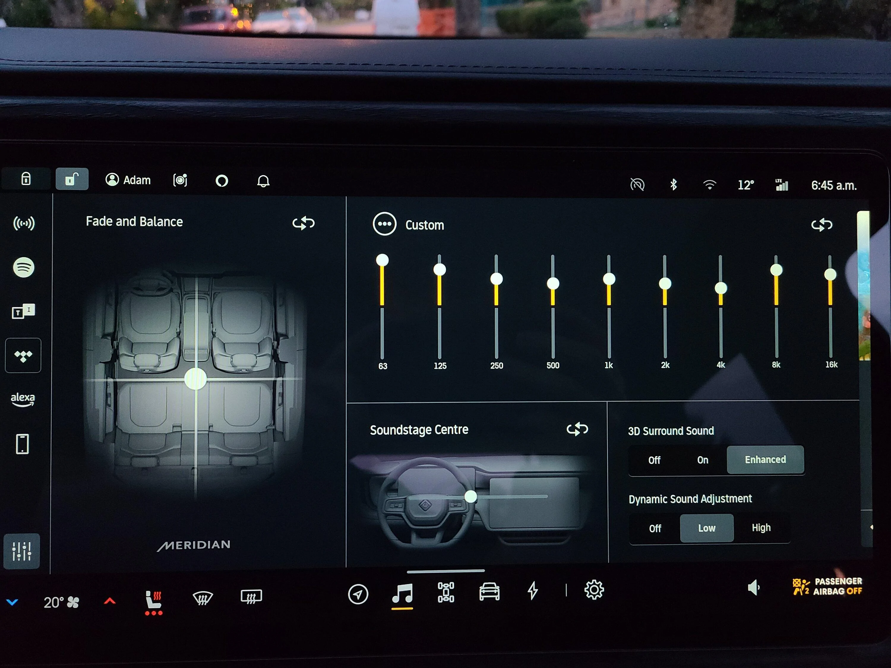

A little punchy on the bass, but I enjoy it. Mostly follows a classical music stock preset from other software
Rivian R1T R1S Best stereo sound settings -- post yours! 20230919_064532

There must really be a substantial difference between Meridian and Rivian systems because this curve with enhancement on would be legit painful in the high-end and absolute sludge/slop on the bottom end.
Also - this is effectively just a "volume boost" with a slight "v" taper - meaning when you boost "everything" you kinda boost "nothing". You could "normalize this curve to your lowest value (4k) and move everything else down by the same number of steps to get 4k to zero and it would/should sound exactly the same - just a little quieter. Though who knows, fletcher munson curve kicking in a bit might be making it sound the way you want... I dunno. But I can say I would NEVER boost the high-end on the Rivian in-house system like that without expecting blood from ear canals. And the low-end would just be mush. So it seems like there should definitely be some clarification on T vs S and Meridian vs Rivian systems included with these suggestions
Tried his settings (with minor tweaks) on my commute home and can confirm it works well in my non-Meridian T. I tried Portishead, Led Zepplin, Sade, West Mongotmery, Albert King and Stick Figure. Much more balanced than the settings I was using.
Can't really decide between Surround On and Enhanced. On yields tighter and better defined bass, which gets slightly muddy in Enhanced but has greater overall headroom. Cannot hear the difference between Dynamic High and Low.

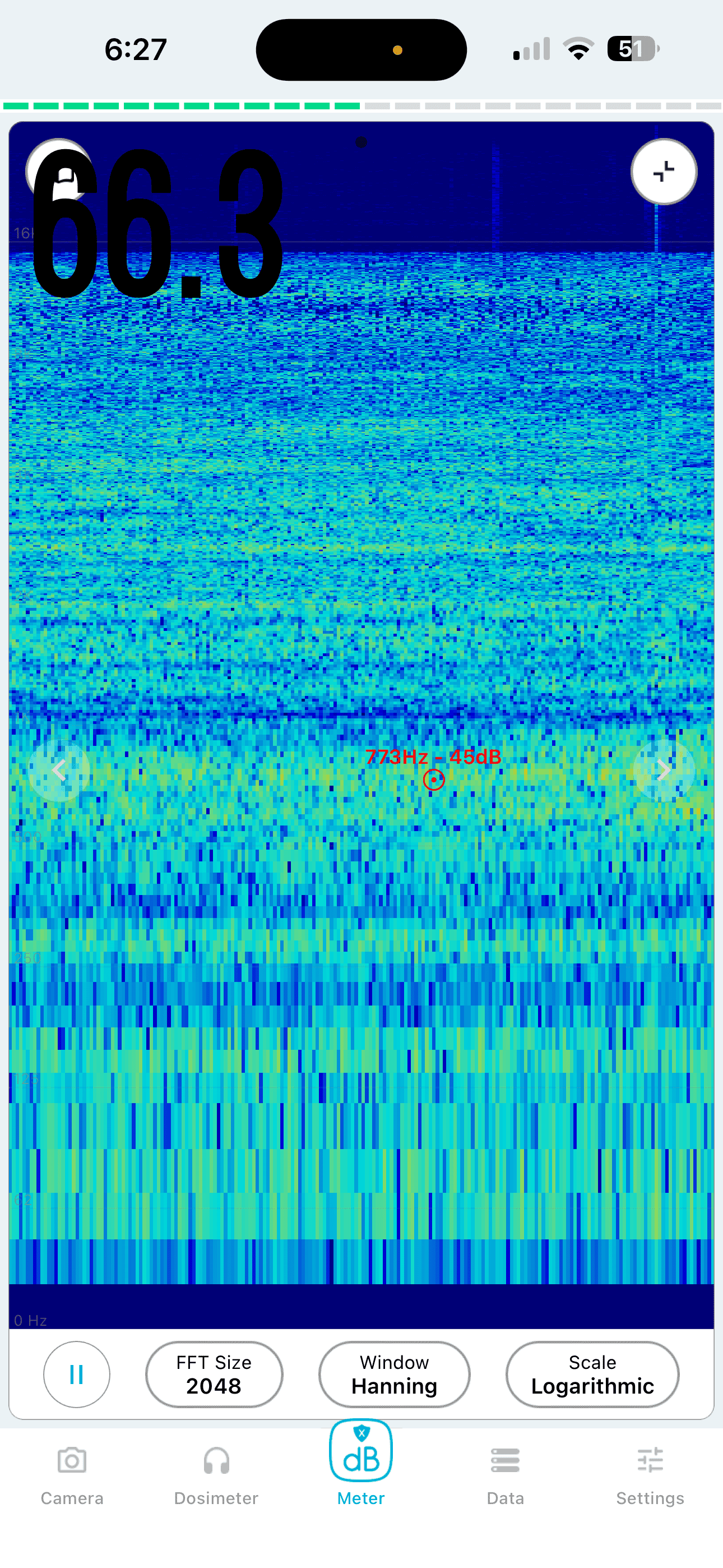

ILLCOMM
Aug 26, 2023

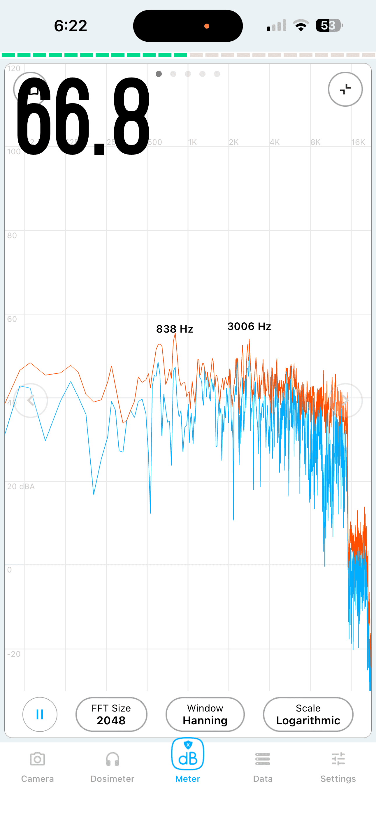

We’re about a week in and for an amazing SUV I am profoundly disappointed by the sound system. It is borderline garbage at defaults - shrill, hollow, but offensively punchy. Yuck!
I EQ’d it as best I could but there’s some resonance around 700Hz that you cannot dial out.
I need to get in someone else’s to see what’s up because I have a hard time believing this was the intended product.

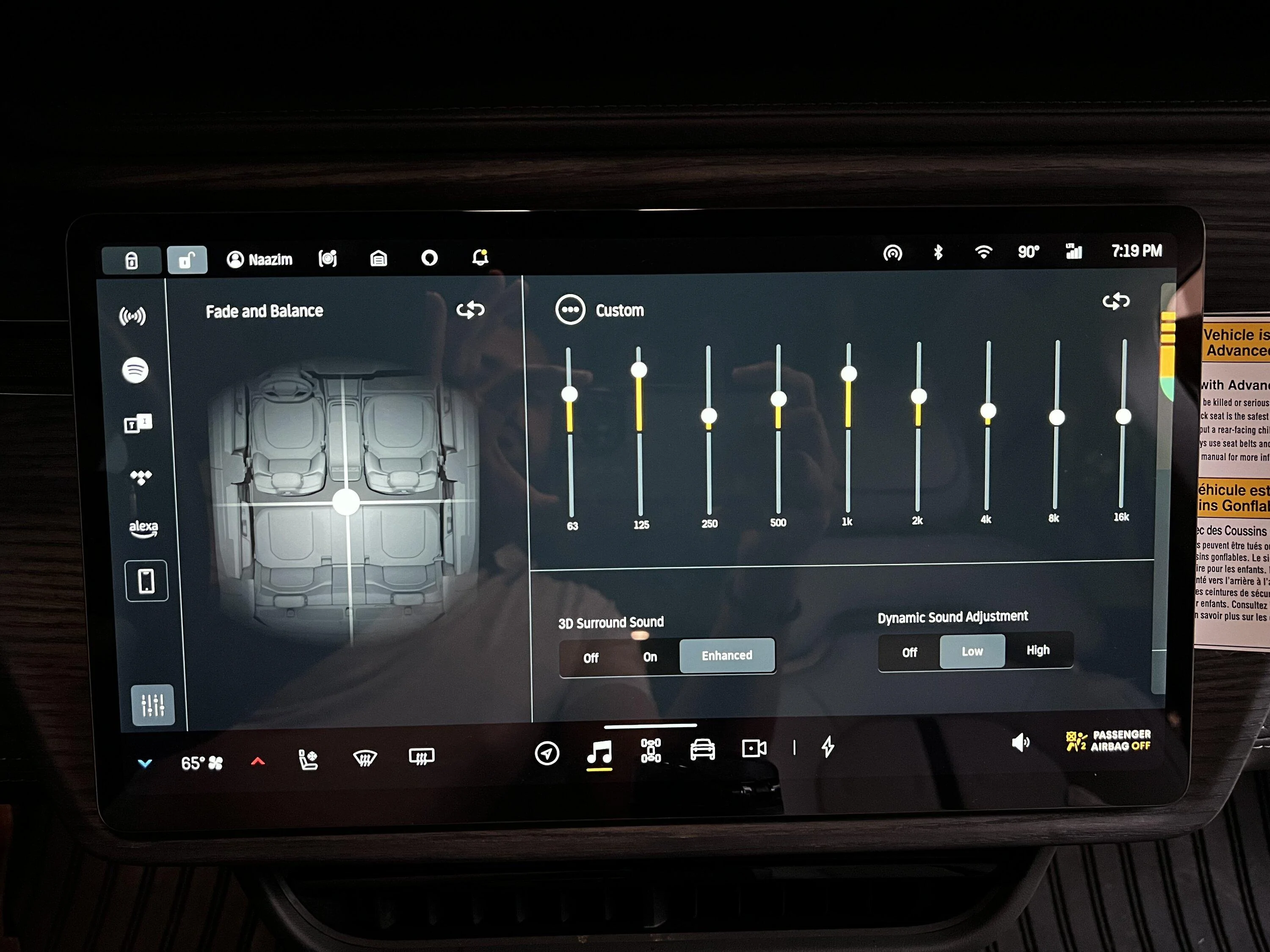

Latest version of what I’ve got it set to. Still not perfect.
Rivian R1T R1S Best stereo sound settings -- post yours! IMG_8143
