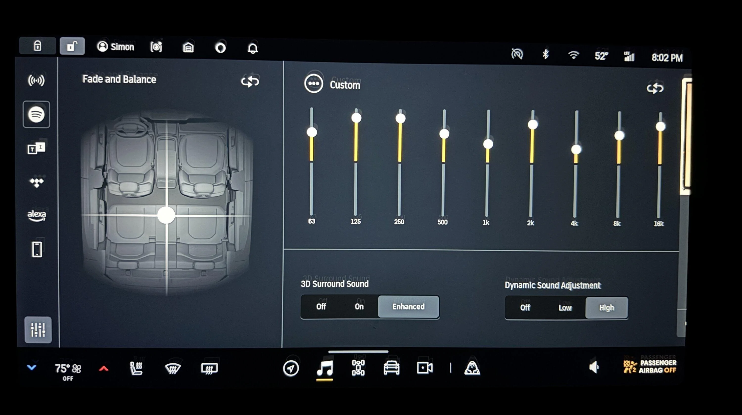

My R1T 2023 Rivian audio settings (non-Meridian).
Rivian R1T R1S Best stereo sound settings -- post yours! IMG_5718

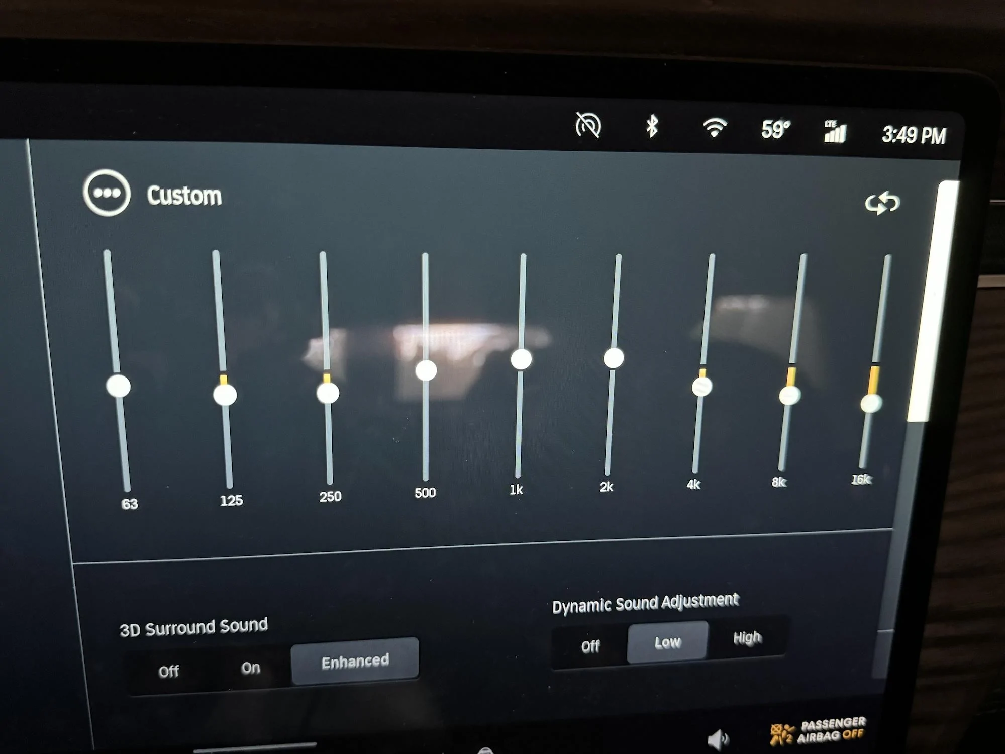

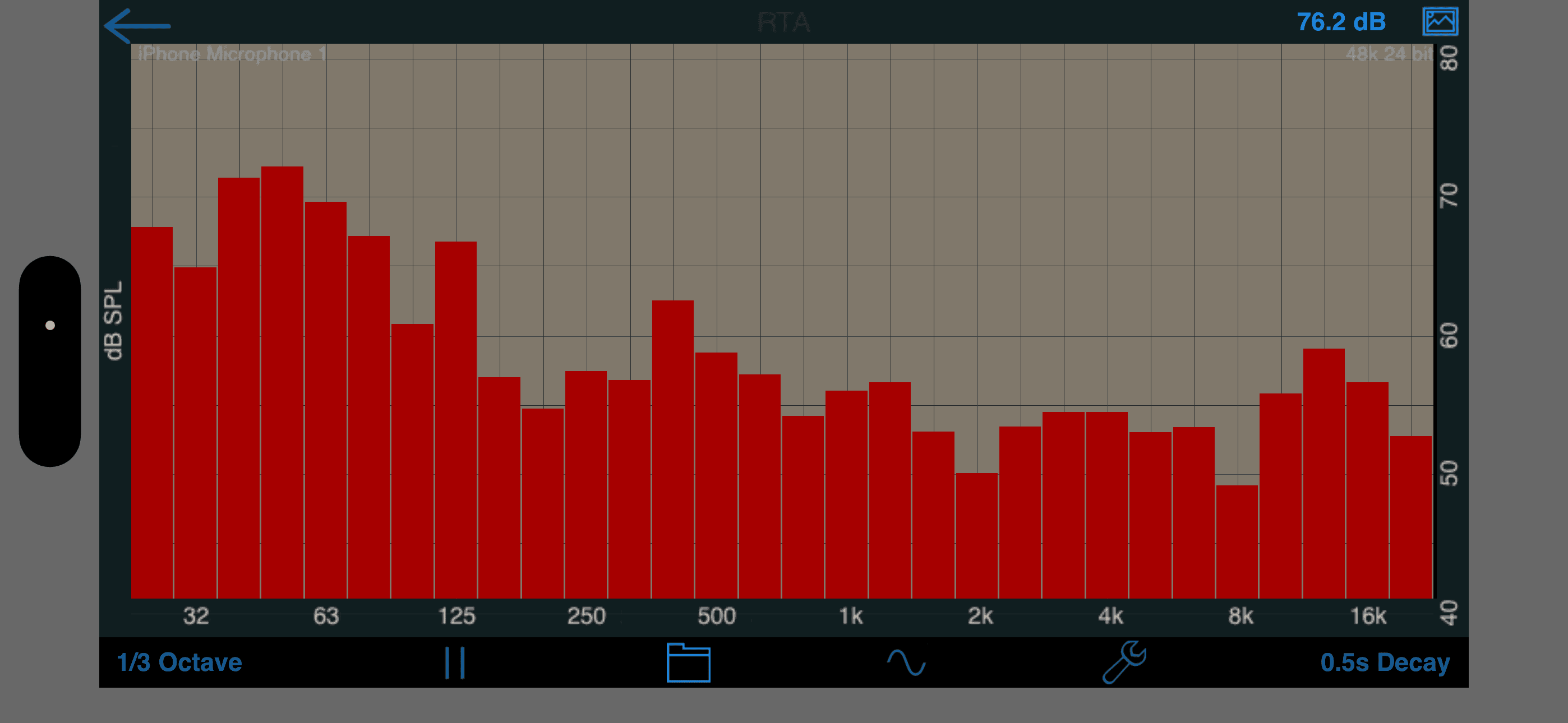

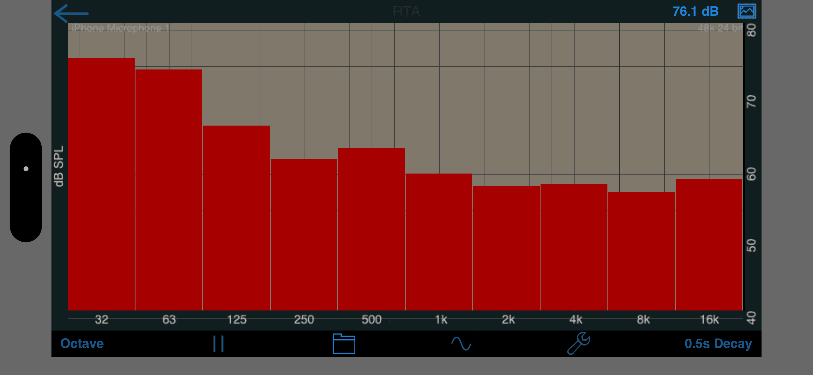

I started out by using AudioTools on iPhone to try an flatten out the sound a bit. Here's where I got with its EQ (and the corresponding RTA plots). I've run through this a couple times, and most times I seem to settle on a more subtle version of the "Voice/Vocals" preset curve in the Rivian but shifted down to avoid clipping. I just find that preset to be too harsh to my ear. Now I took a little liberty with the 63 and 125 to add a little punchiness back to the sound, but I'm finding that the vocals in most tracks are much clearer and more balanced than before.
Rivian R1T R1S Best stereo sound settings -- post yours! IMG_5231
I did note that 3D sound seems to mainly take the vocal range and spread it more around the cabin. Maybe this is a good thing for the rear passengers, but "Enhanced" can sometimes be a bit much. "On" seems like a good compromise.
