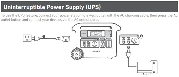

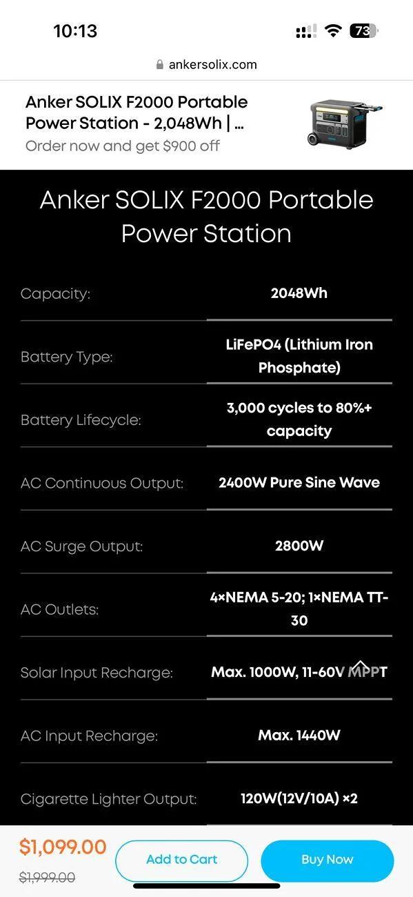

So I did some more reading, and the Anker SOLIX F2000 (PowerHouse 767) has this uninterruptible power supply (UPS) feature:
The unit is rated for 2400W of AC output. The manual doesn't say explicitly, but I'm guessing the UPS feature would mean it can deliver 2400W regardless of what the AC input is delivering.
The problem is the Max AC input of 1440w. I can confirm any output exceeding 1440w trips the F2000 and kills all output. Unplug the input and you can go up to 2400w with no issue.
My understanding is that the UPS functionality just refers to how quickly it can switch between pass through AC to battery power (up to the max ac input)

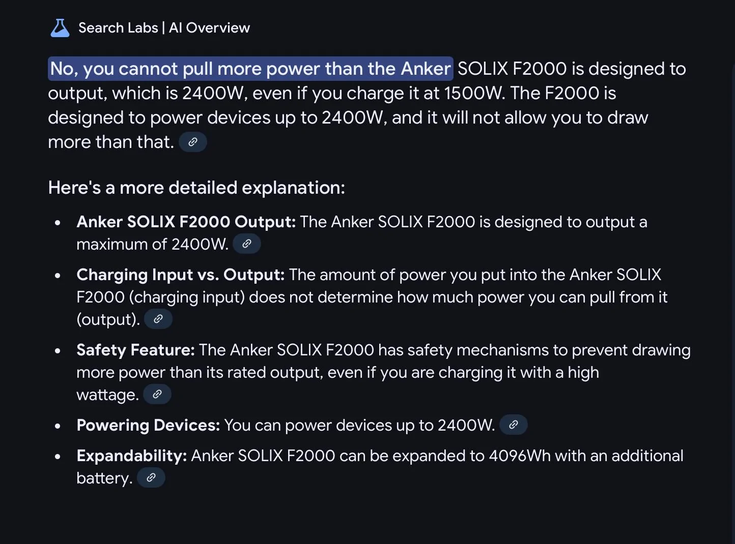

So the A1 generated response I received apparently is not accurate, unless I am reading too much into it.
I don't think that statement is inaccurate. You can pull up to 2400W if you are not plugged into an AC source. If you plug it in then you are capped at 1440W.
The F2000 does support 1000W of solar (DC). But if you are using DC then you can go output more than the input using the battery capacity up to 2400W. And that's basically how the OP is gaming the system. He is converting the AC from the truck to DC before it goes into his power station so he can go above the input limit. I will probably do the same in my case but with maybe a bigger rectifier. This is the one I am looking at currently if you're interested. It will plug directly into the solar input port. https://a.co/d/gBxnD9a
