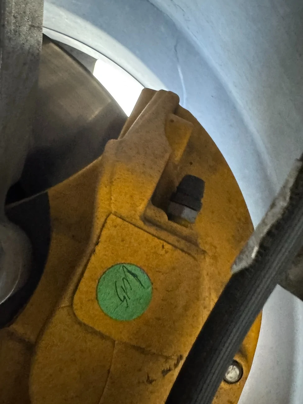

I should add the front calipers have 2 bleeders. They say to bleed the inbound first, then outbound, than inbound again.
