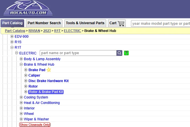

Rockauto my friend.... lots of pads & rotors available for Rivian.

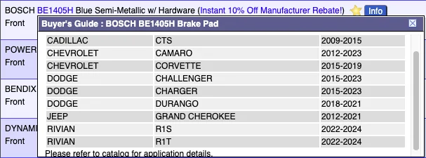

Rock Auto is a good company. I have been buying from them for years. Their buyers guide indicates the pads on the Rivian are common to many vehicles. They list Bendix, Bosch and Dynamic Friction, all quality brands.
