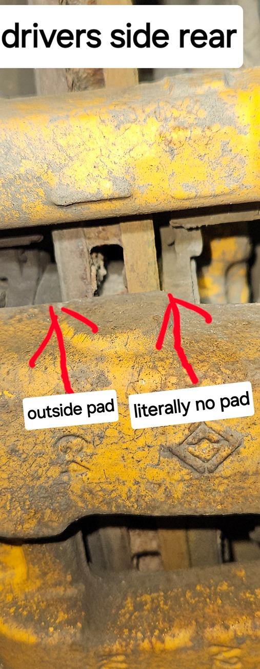

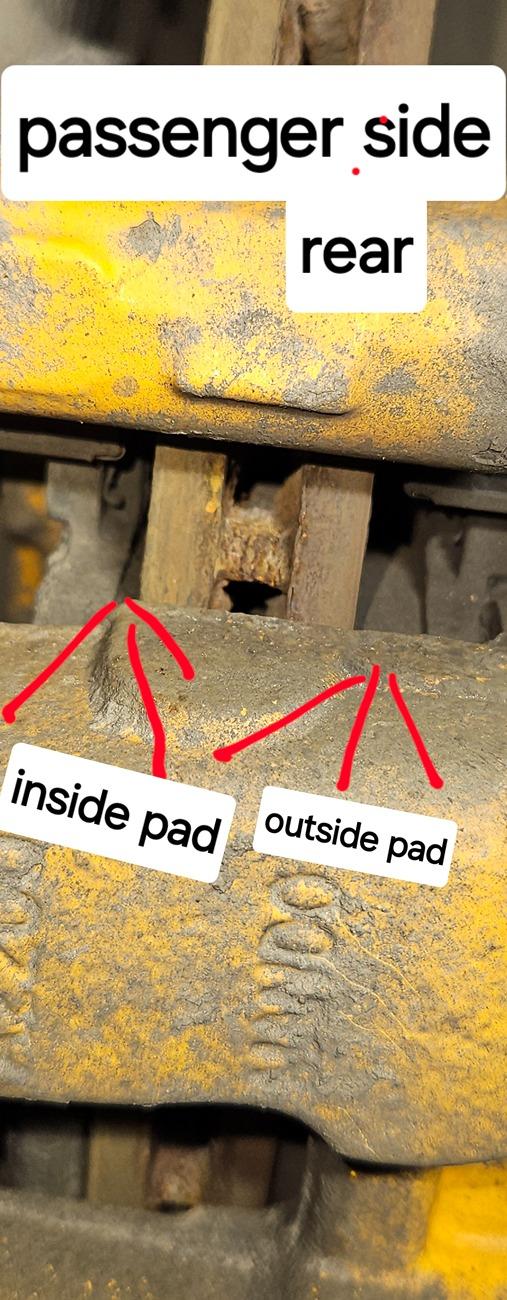

What about the condition of rotors? If you have uneven pad wear, there must be something also going on with the rotors
Rotors are fine, I believe wear is from lack of lube on pins for early builds, something folks have discussed in other threads.

3 years, that's what...50k miles? Inside pads are worn on all four corners? How much extra? For sure there must have been a lot of pad left, and wearing unevenly on all 4 corners would be really odd. Shouldn't have needed brake pads on an EV with that low mileage. I would expect 100k out of the pads easy.

57k miles, without measurements or photos (should've kept them) it's about twice as worn in one direction as the other, laterally.

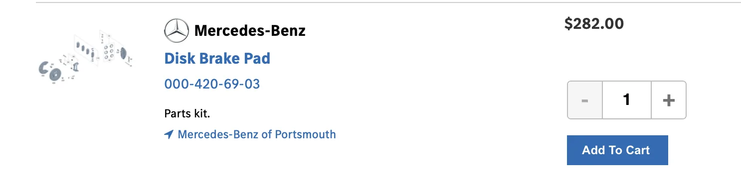

Being in the parts business for almost two decades I agree that, as luxury/dealer pricing goes, this isn't half bad. Go to Mercedes for brake pads for your GLS and you'll pay $472.

This is the reason the 7,500 "inspection" is important. I am sure if you caught this lets say at 15k or 22.5k they would warranty all items. I was very concerned about this and will be doing one at 22.5k again to make sure wear is even. No reason all 4 should be wearing early on inside. You should get 125k out of a set of pads on the Rivian if wearing evenly.
That tracks. My 2015 Model S had pads seized in the front calipers, likely from lack of lube and the salt from it being a Wisconsin car. I almost wished I'd taken it in for that service as it was pretty annoying to get the pads out, but still, almost. The service center penalty with Tesla is way worse with brakes than Rivian.
