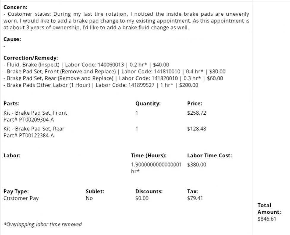

Rivian R1T R1S Brake Pad Replacement Cost ? 1000002023
1. My service request is more related to brake fluid flush recommended at 3 year mark. I'm at 57k miles so it very likely needs it.
2. Outer pads are fat and evenly worn, only inner pads show wear, and it's uneven.
3. ??????
3. ??????
Are you saying the inner pads aren't worn evenly flat (parallel to the backing plate)? That is definitely something wrong with the calipers. Too bad it's out of warranty now...
Not caliper issue, it's the ungreased pins on early builds. Caliper retracts, pad doesn't slide back all the way or evenly.
I've got about 2k miles left and wanted to get this in before it ran out for that reason. If they'll warranty it, great. If they baulk and don't wanna make a deal, I'll DIY.

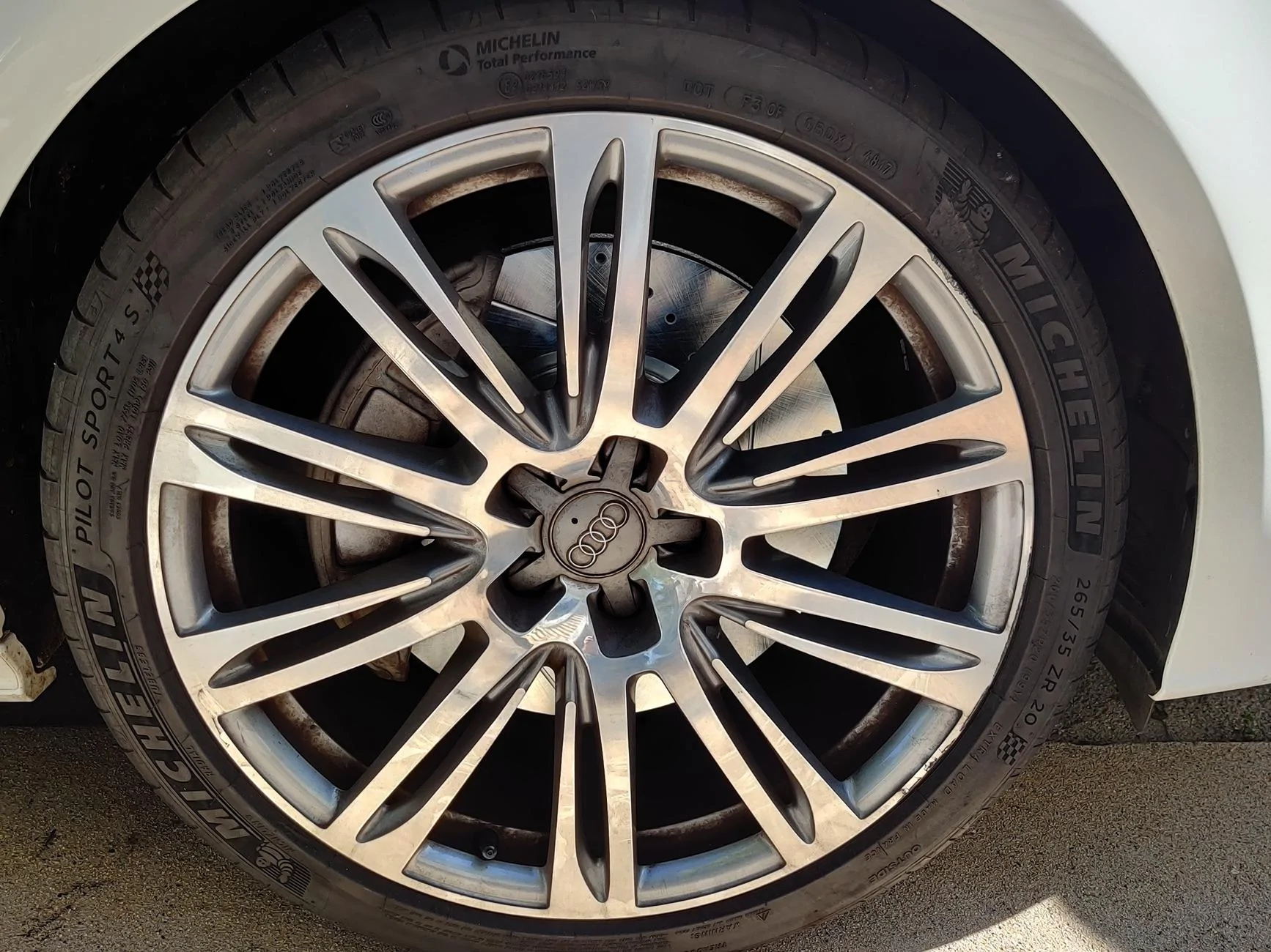

Dealer charges $1000 a corner for my Audi with rotors. Luckily I have the diagnostic software to also retract the electric parking brake and diy.
