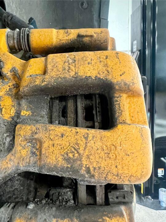

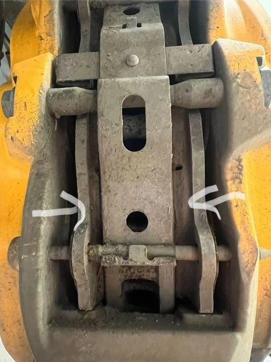

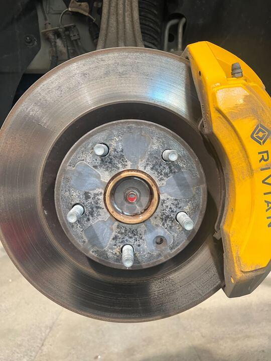

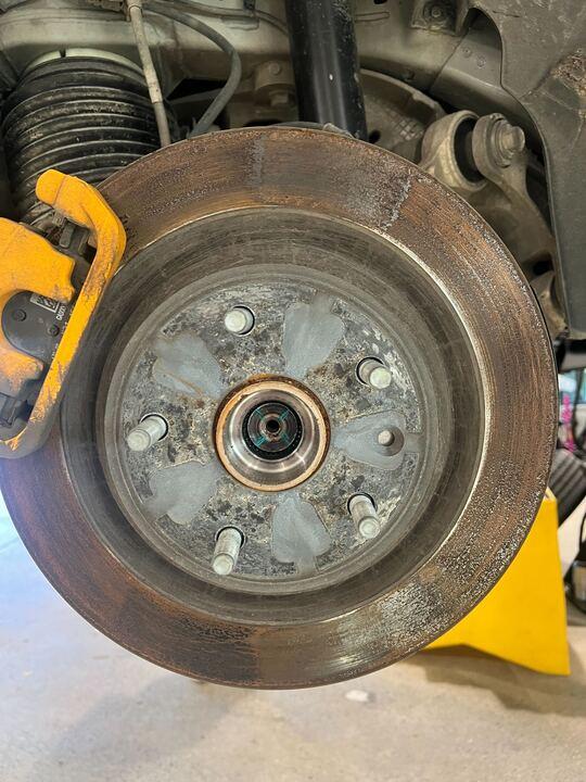

vincent
Vincent
Jul 27, 2024
Canada
Interestingly I've just had the same thing happen to me, 2022 R1T 4xxx VIN, ~70k km (43k miles), brake assist for regen on, 30% highway assist
Car's in the service centre to get the front jounce line upgrade, and the tech mentioned all 4 wheels have inner pads down to 2mm and outer pads at 8mm. Reason they gave for the uneven wear was mud caked on them. Then they recommended rotor/brake replacements (all in Canadian dollars)
For the rear rotors replacement with pads is - $815.32 plus taxes
For the rear pads only - $269 plus taxes
For the front rotors replacement with pads is - $1073.74 plus taxes
For the front pads only - $493.71 plus taxes
I drive on PNW dirt roads occasionally, but I'm skeptical that dirt roads alone can cause ~6mm of wear difference between inner and outer pads on all wheels.
It's a more reasonable explanation on the rear floating calipers, that maybe the guide pins are gummed up. Floating calipers only have pistons on the inner side, and the outer pad is supposed to wear evenly but never really does. (idk the exact details but the point is there aren't pistons on the outer side)
It doesn't make sense for the front calipers. The front callipers have 6 pistons, 3 on the outer pad and 3 on the inner pad for theoretically at least, perfectly even wear...??
From this thread it sounds like it's the brake assist regen setting and/or a 2022 build era unlubed pin situation... I might push a bit harder to get the pad work warrantied but it sounds like I gotta take the bullet and hope they grease it properly this time? hard to say without automotive experience (never done brakes myself before, cause losing brakes after a DIY job in an ICE seems pretty bad)

Those rear rotors look rough! That's surface rust, right? You can see where the pad was getting stuck to the rotor.
IRT brake assist Regen setting, I tried it when it first came out and didn't like it, so kept it off. I'm attributing to ungreased pins from the factory. Mine are not only worn on the inside, but unevenly worn front to back. Like the pad is diagonal, I'll dig up a pic or crawl under and take one.
vincent
Vincent
Jul 27, 2024
Canada
Now that you mention it, my front inner brake pad looks more worn towards the bottom of the picture than the top. Or it could be the camera angle. I'm gonna bring this up with the service centre on Monday.
Yeah, I was pretty shocked to see that much rust on the rear rotors. That imprint is probably from the brake pad binding to the rotor overnight; I often hear a little clunk as the parking pad unbinds every morning.
SC said it was surface-level rust. Assuming the rear friction brakes are getting used by software, it looks like my rear outer brake pad is applying very little force based on the rust buildup on that rotor. Makes me hesitant to drop $800 on new brake pads just for this to happen again when the diagnostic from the SC is "mud buildup".
