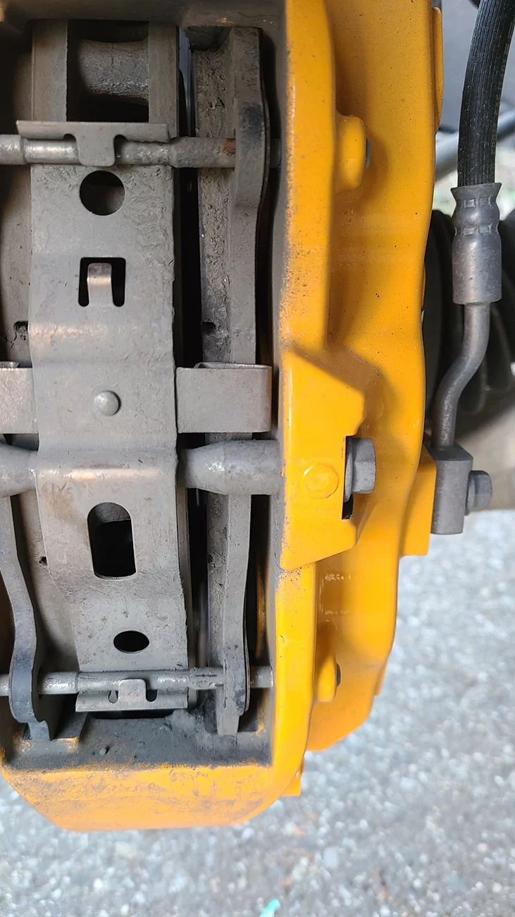

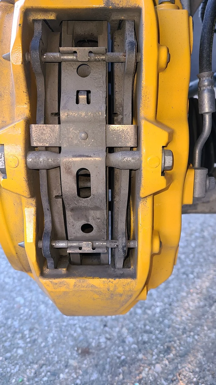

My mistake on the part naming. The keeper pins on the fronts are typically where the pads bind. The photo below is of my first set in May '24
Rivian R1T R1S Brake pad wear? 20240420_070729
Rivian R1T R1S Brake pad wear? 20240420_065812
So going forward, I'm going to try to ensure those are clean.
I will concede this could be a side effect of the dusty/muddy/silty water roads I subject my truck to at least once a week. I try to hit everything including the calipers with a pressure washer after but maybe I haven't been effective enough.

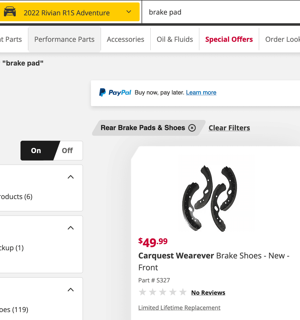

@Zoidz yes it's at the Rivian Service Center in Chelsea, MA. They are quoting $900 for pads and rotors and I think there is a realization something is wrong because they took the labor off before I started asking questions. I'll update after I hopefully get the truck back this afternoon.
Just buy the parts online ( higher quality. ). Do not change the rotors unless you see grooves on them. )
part found. https://www.carid.com/sf-pl-mpn/pid...MIsfTc2MuPkAMVsrIDAB0K4B9LEAQYAyABEgK8V_D_BwE

Seems like the lower right piston is more active than the other three. Could be friction holding that pad on the disc. Does seem to be dry at the pins and the ends.
