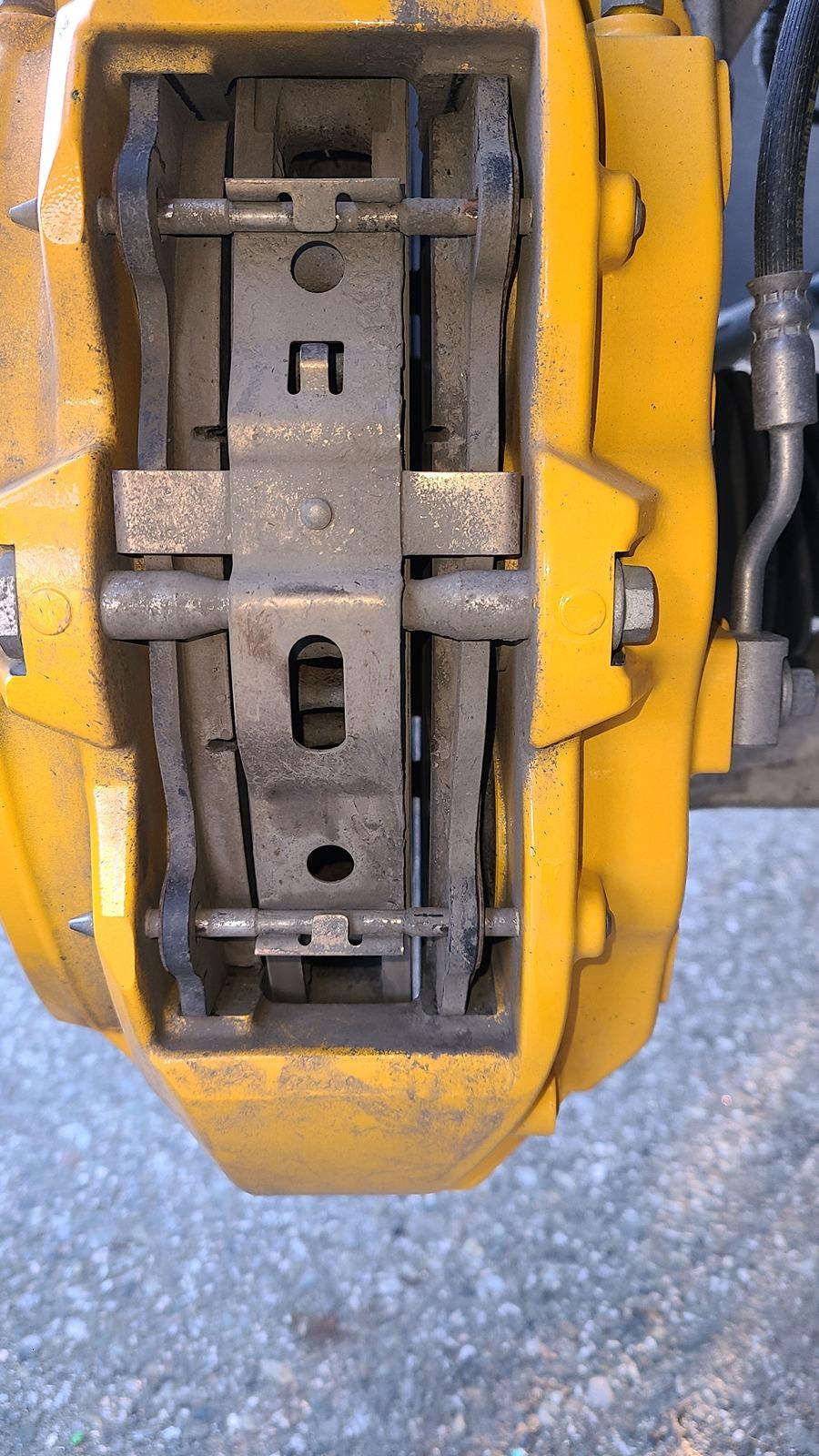

As a data point, was noticing a slight grinding noise after some off roading and assumed it was a pebble between the inner rotor shield and rotor. As the days passed, and it wasn't going away, decided to pull the wheel and investigate.
Turns out the inner pad was worn completely at the base, beginning to score the inner face of the rotor, with the majority of the pad still left at the top. So worn to resemble a door stop.
Rivian is going to try to squeeze me in either today or tomorrow to investigate/repair which is awesome, they've been fantastic in getting this sorted so A+ on that front.
What I suspect is either the top of the pad was bound in some way, or the caliper has some air in it, causing it to only push inward with the lower pistons? Grasping at straws, but will update after it's repaired.
Following up.
Service looked over the issue and replaced both front rotors, pads, calipers and brake lines (not sure the extent of the lines replaced but assume it's just a small portion leading to each caliper) so far so good as I've put on nearly 2500kms since.

Wow surprised they replaced everything, guess they just didn't know the issue.
Looks to me like the rust on the retaining pins will cause binding on the pads. Perhaps worth adding some antisieze on those pins early.

There were no signs of rust, that I noticed at least. I assume it was caliper related if the service procedure mentioned in the Work Order calls for the replacement of the calipers, lines, rotors, and pads.

In the photo above the pins looks really rusted, unless it's just mud.
