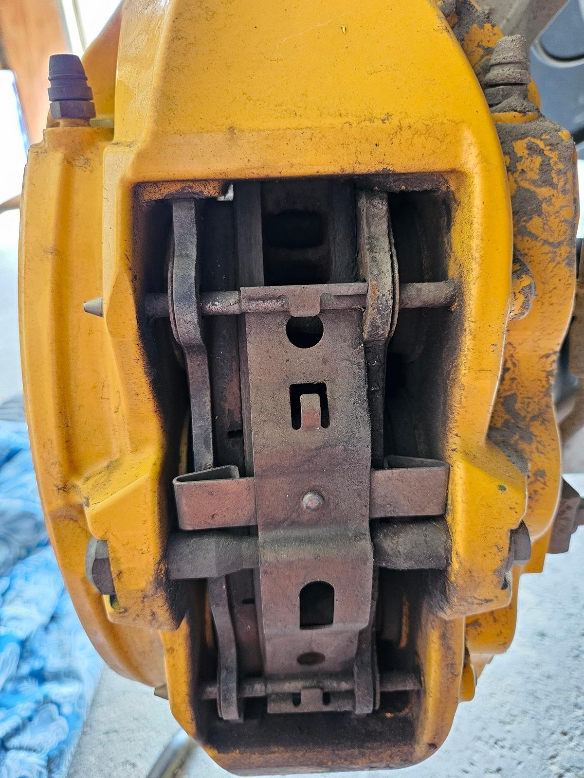

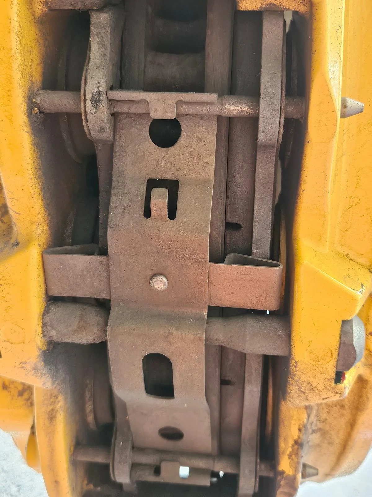

I'm circling back a year later. I now have 52,000 miles. Still am not touching my brake pedal unless it's an emergency braking situation.
Started hearing a rubbing/metal noise at low speed a couple days ago. With the wheel mounted i could clearly see the front pad was fine so i kinda just figured it was mud or a rock stuck in the pad and it would go away.
At the same time I was waiting on my new Michelin LTX Platinum 275/65/20 to get mounted, so I figured I would do a deeper dive once I had to change my rims out.
Took them off today and was pretty easy to find the problem. Both outside pads seem unused and the inside ones are toast. Very hard to see with tire on. If one side was the way i would thing its a caliber issue. Both sides? Im really unsure. Waiting on Rivian service to get back to me after opening up a ticket today.
I would say I have some issues with my calibers.
Once again.... I don't touch my brake pedal.

Aag12
B
Mar 17, 2022
384
443
Na
Oy that's scary. I also get the rotational rubbing noise after driving in snow. I always thought it was some ice/snow stuck on the rotors... Guess I'm going to check my pads during my next tire rotation

That makes sense, inside calipers receive the pressure before outside, so more likely for outside to seize, or just get less "push" over time. Likely why they suggest doing a hard brake at least weekly, keep those fluids moving and prevent seized calipers. Moving parts are lubricated parts
