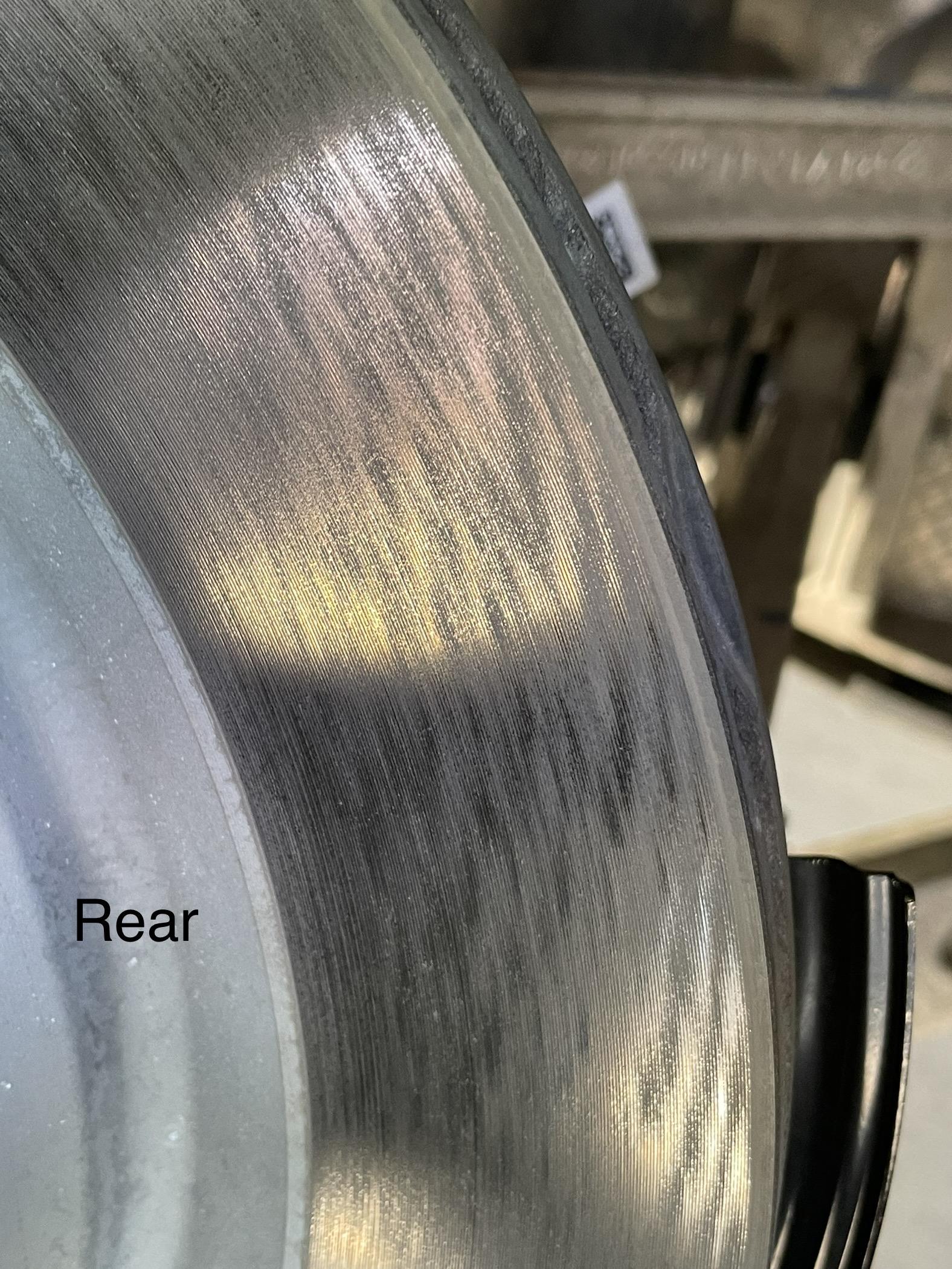

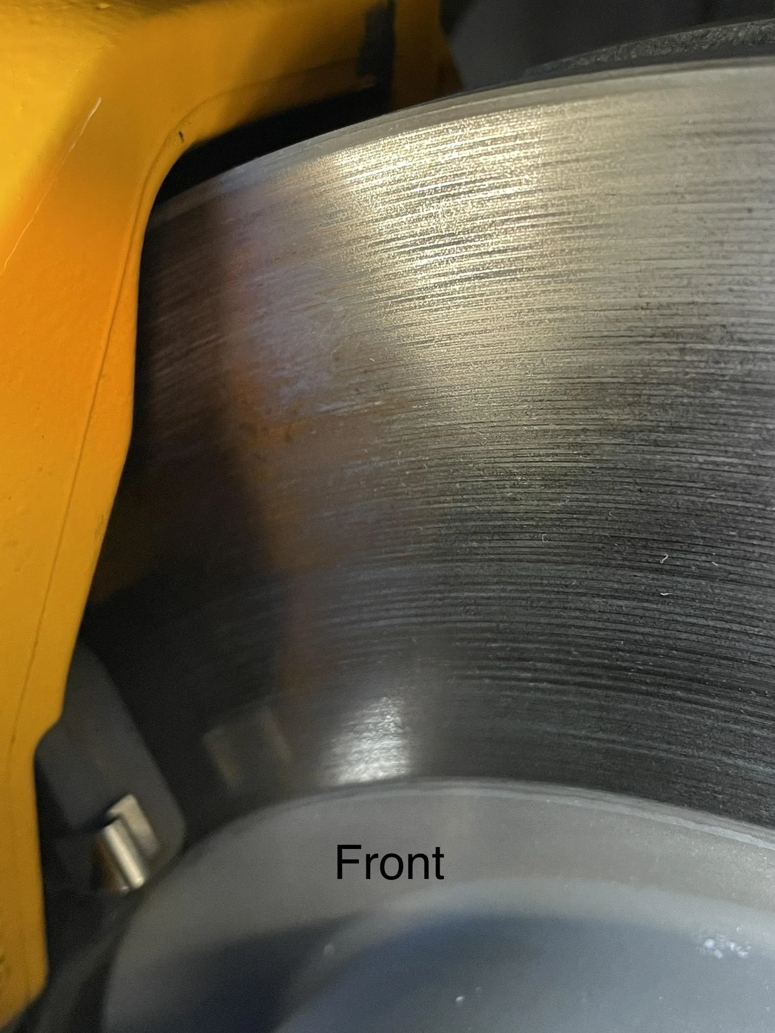

I only have 3200 miles on my S, exclusively in High Regen, so not the best comparison, but after my drives, (including the top of Loveland Pass in the Rockies and back down) the front calipers are cold, and from the photos, I don’t think my rear pads have ever touched the rotors, as witnessed from the brand new striations still present on the rear rotors…would be interesting to see others’ rotor photos.
Rivian R1T R1S Brake pad wear? IMG_6332
Rivian R1T R1S Brake pad wear? IMG_6333

The Rivian does blend the brakes in for the last few mph of a stop with regen. You can feel/hear it sometimes under the right conditions.
I wouldn’t expect this to wear out the pads very quickly, but I don’t think the comments about no blending are correct.
shap
Nov 18, 2021
870
765
Austin,TX
BMW 45e, R1T
I have x5 45e. It also blends the breaks at the last few mph. X5 also has very weak regen in general. Said that my, pads are 9mm (out of 12mm) after 38k. My friend with x7 40i replaced pads and rotors at 30k. But he is driving in a very "aggressive" way.
I just do not get how Rivian can require a brake pad replacement at such low mileage, taking into consideration the high regen feature.
Either driver was slamming the brakes, or Rivian abused friction brakes for stability/traction control.
If the latest is true - it would be really bad, but hopefully fixable in OTA.
