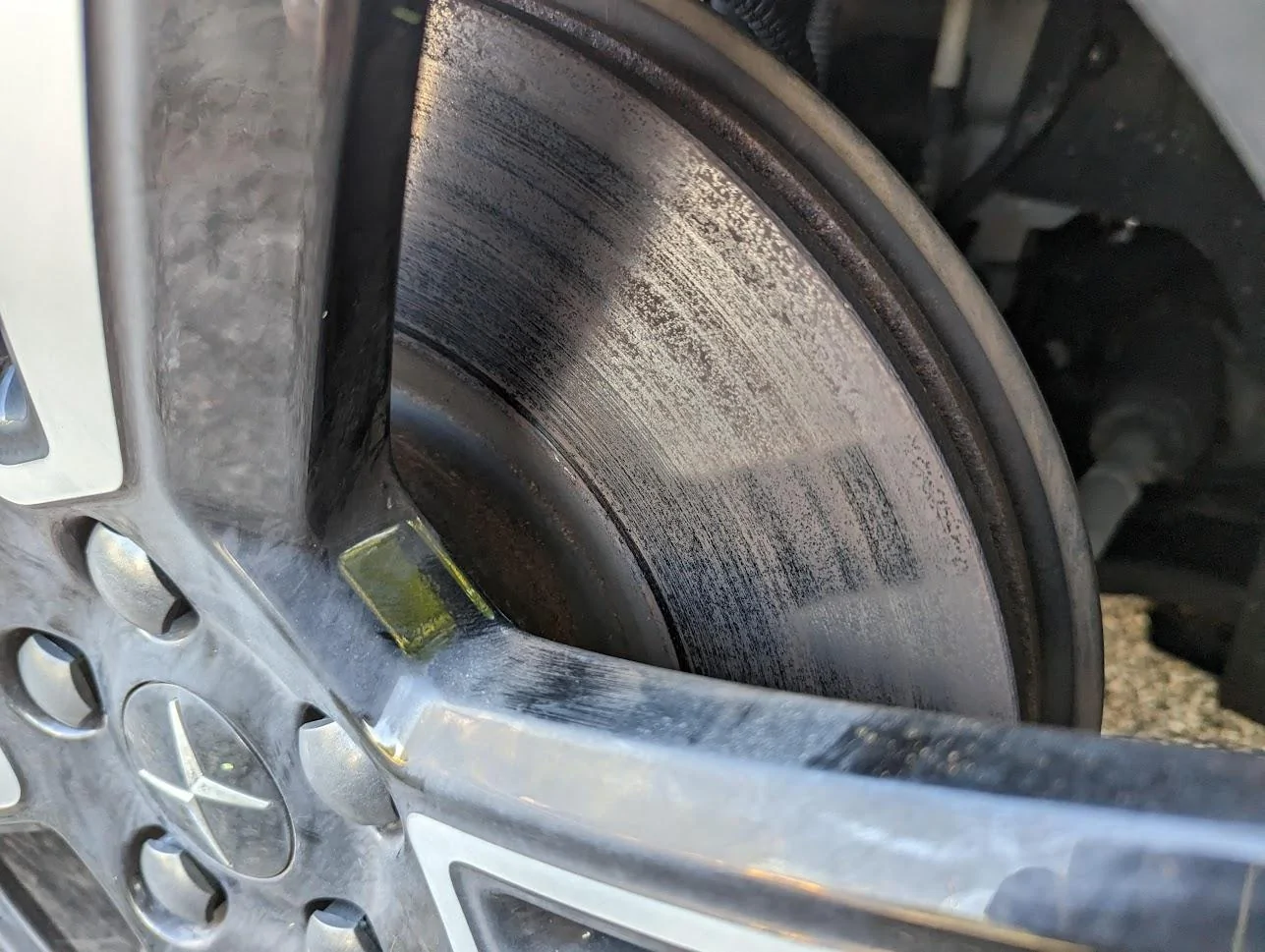

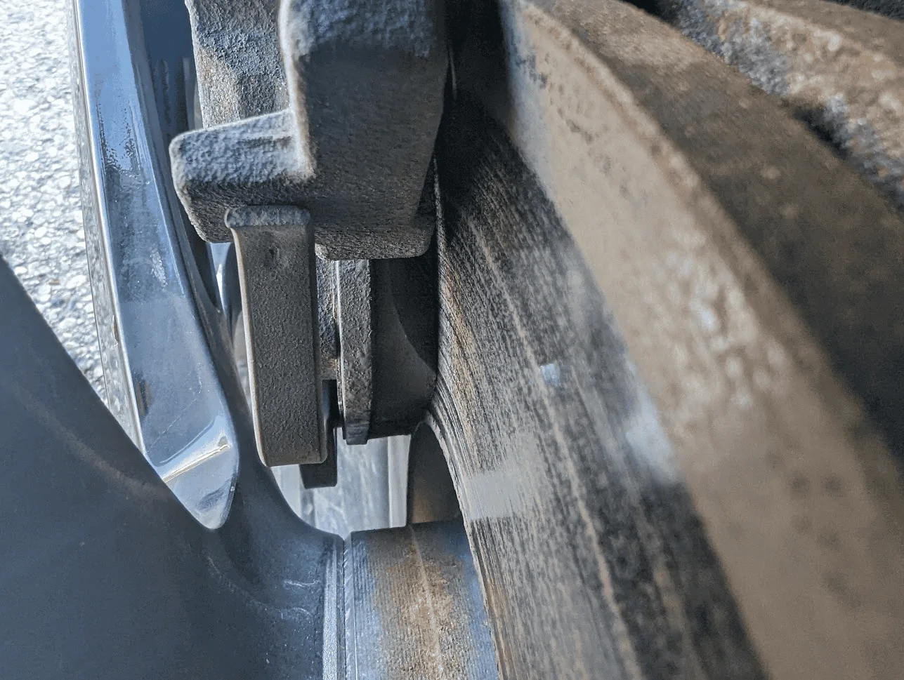

I only have 3200 miles on my S, exclusively in High Regen, so not the best comparison, but after my drives, (including the top of Loveland Pass in the Rockies and back down) the front calipers are cold, and from the photos, I don’t think my rear pads have ever touched the rotors, as witnessed from the brand new striations still present on the rear rotors…would be interesting to see others’ rotor photos.
Great to know! That kind of shoots down my theory but that's not a bad thing.
