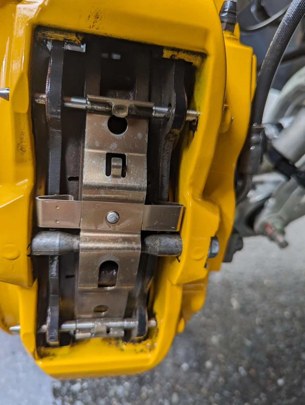

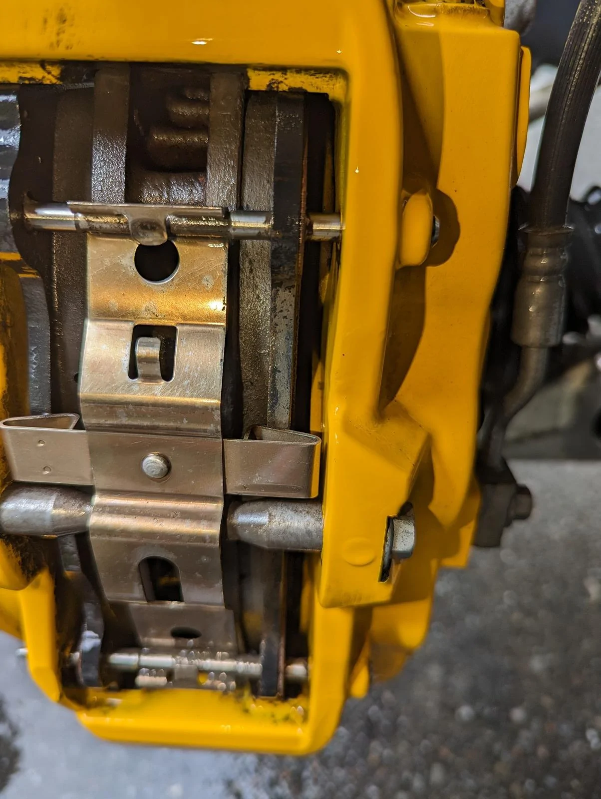

31k miles, after a good wash/scrub while changing wheels yesterday, in New England.
Rivian R1T R1S Brake pad wear? PXL_20240518_193014696.RAW-01.COVER
Rivian R1T R1S Brake pad wear? PXL_20240518_193032751.RAW-01.COVER

Pads look good, but you can definitely tell the inner pads are wearing 50% faster than the outer ones

Agree. Does it mean it should be a warranty issue? i.e. design flaw, etc? My understanding that calipers need to be calibrated and designed to wear evenly, no?

Warranty coverage, perhaps. Design flaw, no. It's from failure to properly lubricate pins and pad ears at the factory.

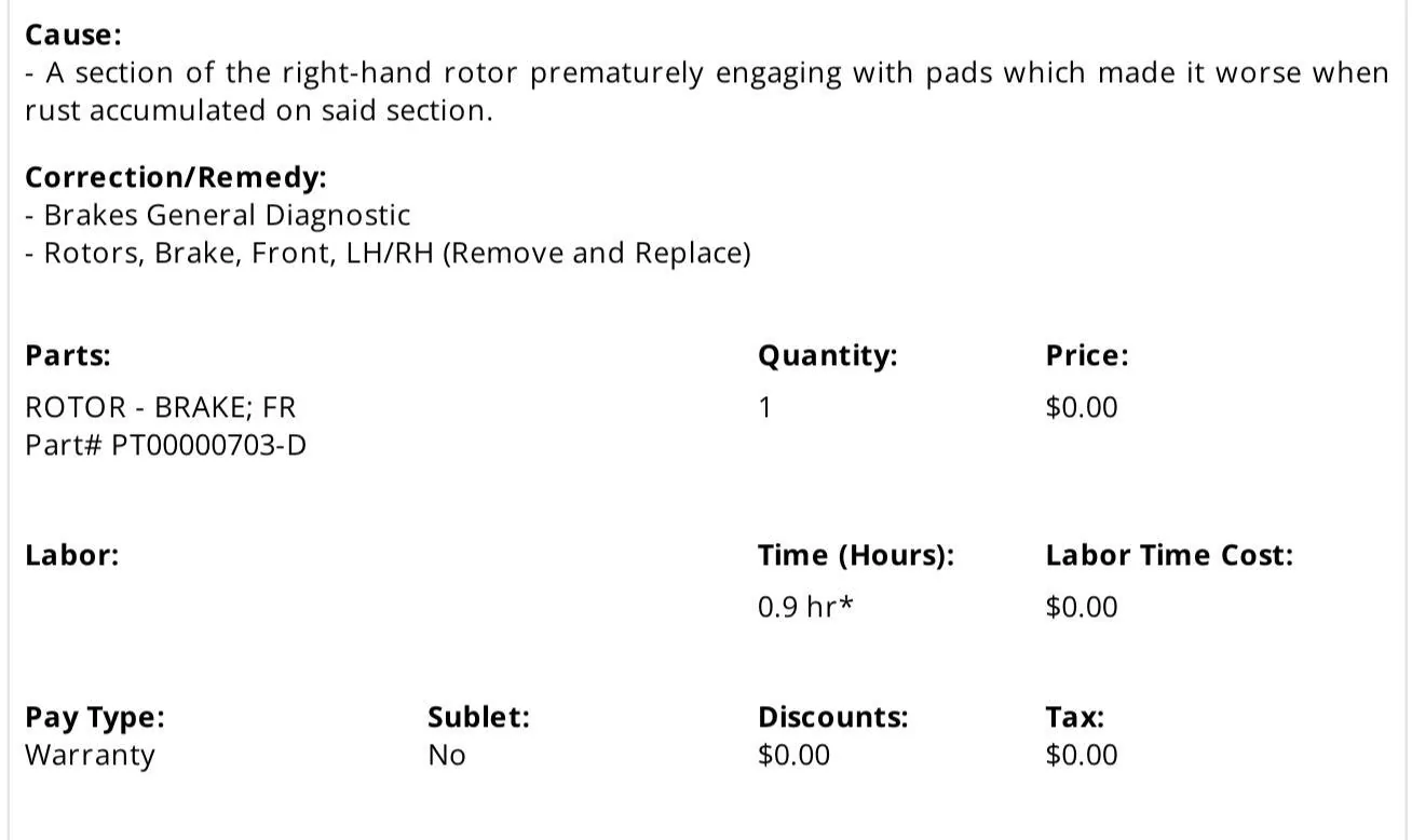

Got it. I just added another item to my next SC appointment - right caliper. Other 3 rotors show no signs of wearing at all. This one (front right) is polished like a mirror. I am in TX, so no bad weather, no snow, no salt. 30k miles, 2 years, no reason to have any stuck pin IMHO.

Quick update:
SC replaced the rotor and pads on the right front brake. They said that it was uneven wear and suspect that the brake was "stuck". I do accidentally use brakes, and I live in Texas, no off-roading. No idea what could potentially make it stuck and create rust.
SC was great and solved the problem.
Rivian R1T R1S Brake pad wear? 1744048343778-m
