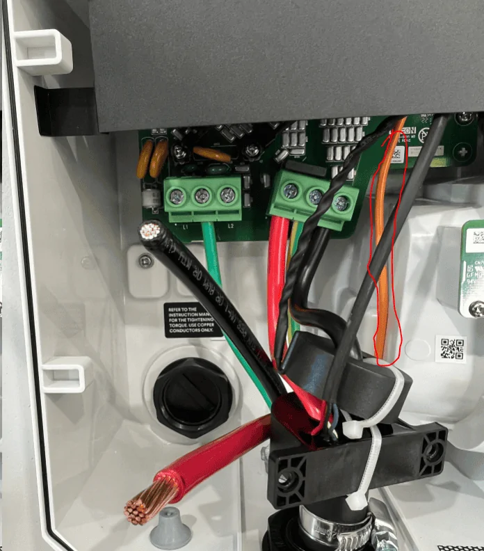

So long as its a J1772 cable that is rated for a 48amp EVSE you should be able to use it.
Rivian EVSE uses a single orange control signal wire. I don't have a Rivian EVSE to take apart and verify so if there is a special connector on the end you may have to splice it in to the old one.
I recommend you have an electrician do all work, overall you might not save much money over a rivian refurb.
Rivian R1T R1S Broken Charger Retaining Clip 1709308059449
pic from another thread.
https://www.rivianforums.com/forum/threads/rivian-evse-and-4-awg.7536/
