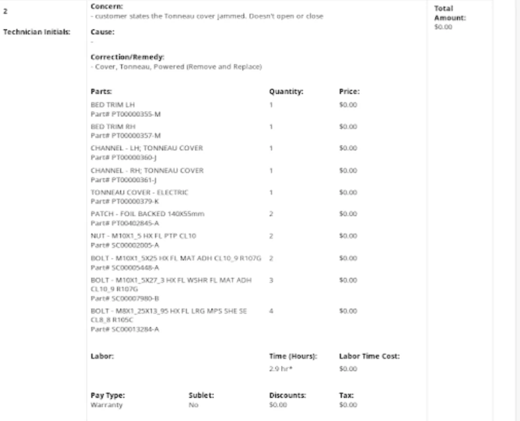

For some reason of course the only invoice I want to look back at itā€™s not letting me now. I do remember it listed off some of the parts needed to fix mine. I donā€™t recall seeing anything about a new motor, just the panels and some trim pieces.
5th part is "Tonneau Cover - Electric". Maybe that is it?
Iā€™m reading that as the actual tonneau part, though odd it is only 1 quantity. Perhaps it is a kit with all the pieces. I know my old ones were broken on the sides so they definitely had to be replaced!

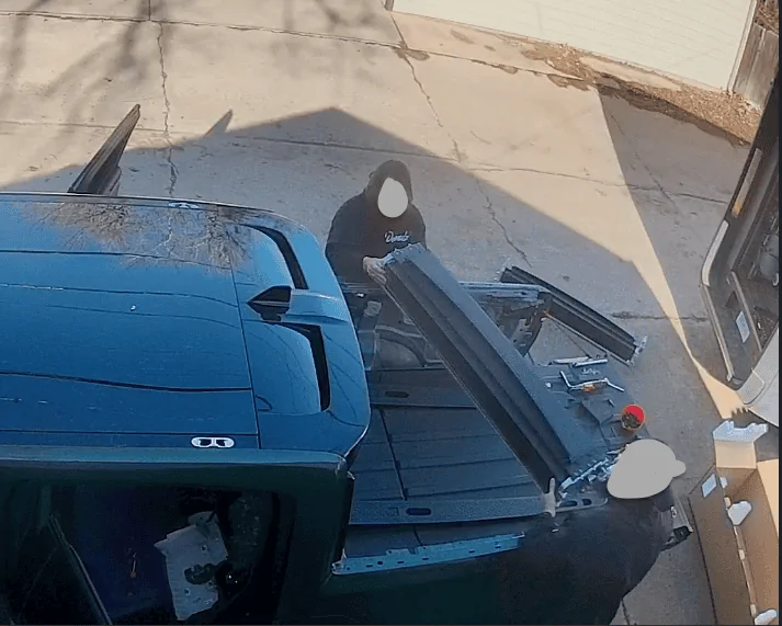

Pretty sure this is the new part listed above, it came in one piece out of the box on the ground. The old part is sitting behind the truck. The assembly included the motor (in the closer tech's right hand) and after they installed it they deployed the slats out of it. So I believe PT0000079-k is the full PTC assembly, motor, slats and all.

Mobile replacement complete.
  • 8:03 - Tech #1 (with the van) starts working solo
  • 8:36 - Tech #2 (in an R1T) shows up
  • 9:57 - All done

Glad to help. Not trying to make excuses for the SC but it could be a training issue.
Those pics are great to see, and will make my next phone call with my service center (CO Springs) a little more interesting. I am still being told that this fix absolutely cannot be done with a mobile service call. It's bad enough that there isn't much rhyme or reason to their scheduling (had a ticket in since June 2022), but I've even had a mobile tech out to me since they've started these fixes. Thanks!
