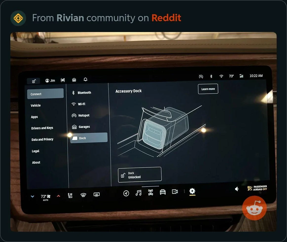

From Reddit:
I just got the update and tested it... it does NOT work with my prototype, even though my prototype latches perfectly. So I suppose while they are probably going to release accessories for the dock soon, they are keeping the locking proprietary and it will require some form of authentication (be that something as simple as just electrical load or something more sophisticated).
So even with that feature, my drawer won't lock ?‍♂

I just got the update and tested it... it does NOT work with my prototype...So even with that feature, my drawer won't lock ?‍♂
Not a big deal for some of us, I'll use it to store bed tie-down straps, gloves, stuff like that which has no need to be secured.
lock is bonus. I can live without it.

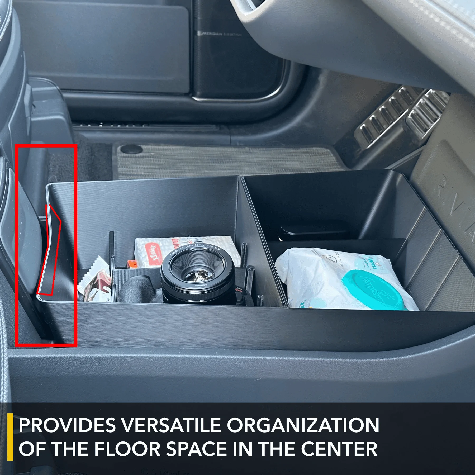

Looking forward to this being available.
On a separate note, I've held off on the floor console organizer, however, if I get this, would likely get both. My question, are you going to offer a modified version of it to slot out the front portion of it so the new storage tray can still slide in and out. With the non-used camp speaker, wasn't an issue, but now that that will be a usable storage drawer, wouldn't want to have pull out the organizer every time I need to access it, which would be quite often.
Possibly it's as simple as just trimming just the front end? Or your program maybe can be revised to lower the front edge a little? Appears it wouldn't need much (see image below from your site)
And, just throwing it out there again, still would love for rear half (toward front of truck) to tilt up and allow for a little deeper storage. With the cover on it, would be a great place to put your phone. I know you said that complicates 3D printing. That was a few months ago, so just checking to see if there's been any further thought given to that?
Certainly buying the drawer storage. Likely will buy the console organizer if the front edge can be trimmed to allow the drawer to come out with it in.
Thank you.
It's on my todo...I actually made some progress on this about a month ago but I wanted to do the cup holder completely differently so it can accommodate all sorts of cups...that's where I was at last. I hope to finalize it soon as you are right - it only makes sense to make our own products compatible with each other :)
