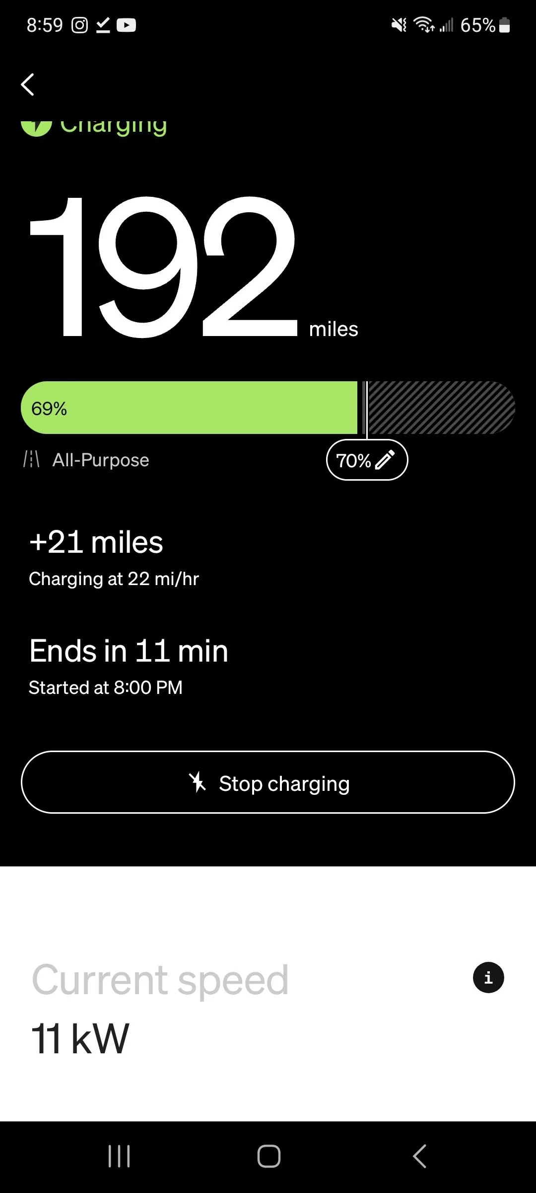

These numbers change a little, here is our R1S on our Autel 48 amp charger just about to stop charging for the night after 1 hour of charging and it is at 22 miles an hour, but usually 25 miles an hour.
Rivian R1T R1S Charge time difference between 60A and 50A? Screenshot_20230417_205915_Rivian
I think you should easily get 18 miles an hour so even if you plug it in at 9pm and unplug at 7am that is 180 miles on all purpose mode. That is still a lot in my opinion and should be good

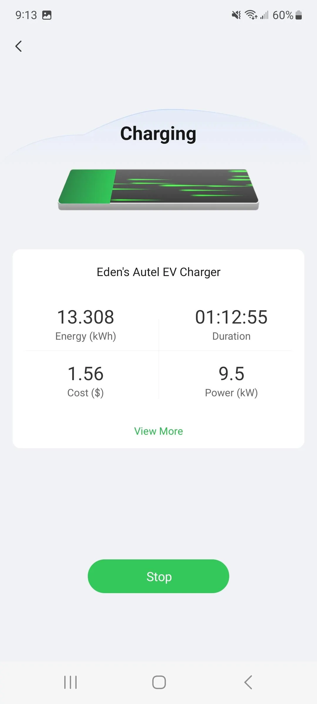

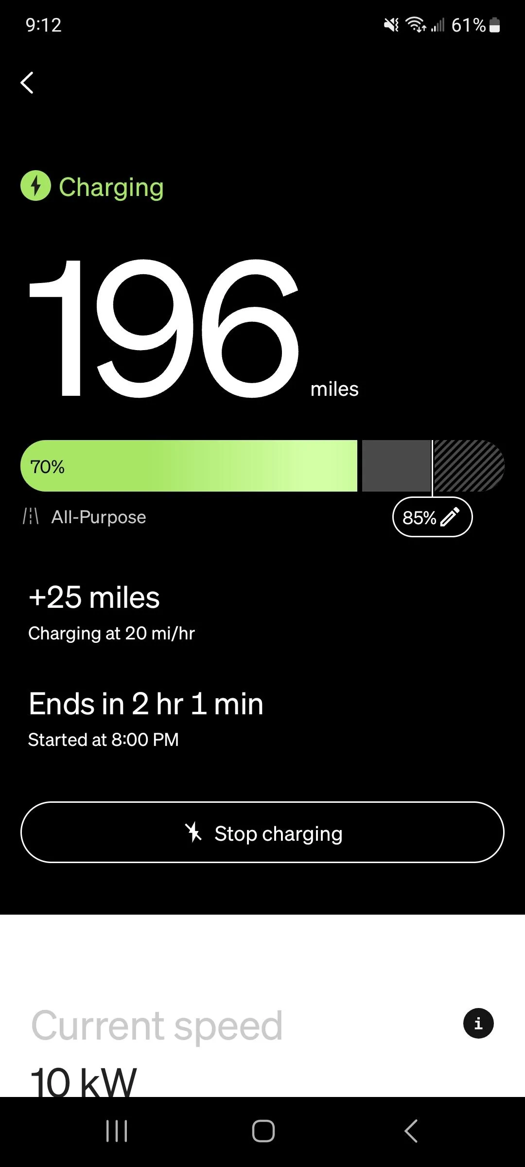

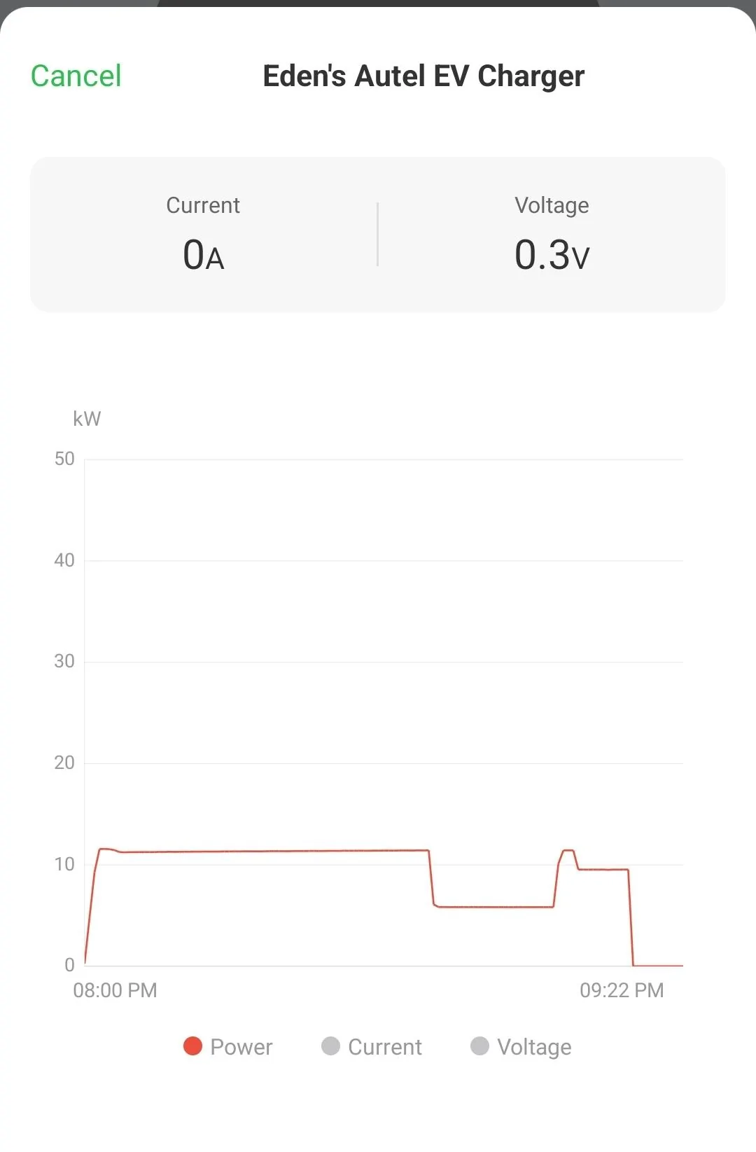

So it just dawned on me I could just change the amps.on my charger through the app while my R1Ss is charging and tell you exactly what 40.amps hardwired does. Now I had to move the max charge to 85% so it might have been tapering a bit, but it got me 20 miles an hour on the dot. The chart looks funny because I played with the 24 amps I'm looking at for the dryer cord for travel (which was 11 miles an hour BTW, a little.less than I was hoping for, but enough)
Maybe when I'm bored someday I should log every charge rate at every 5 amps and post it for the forums haha

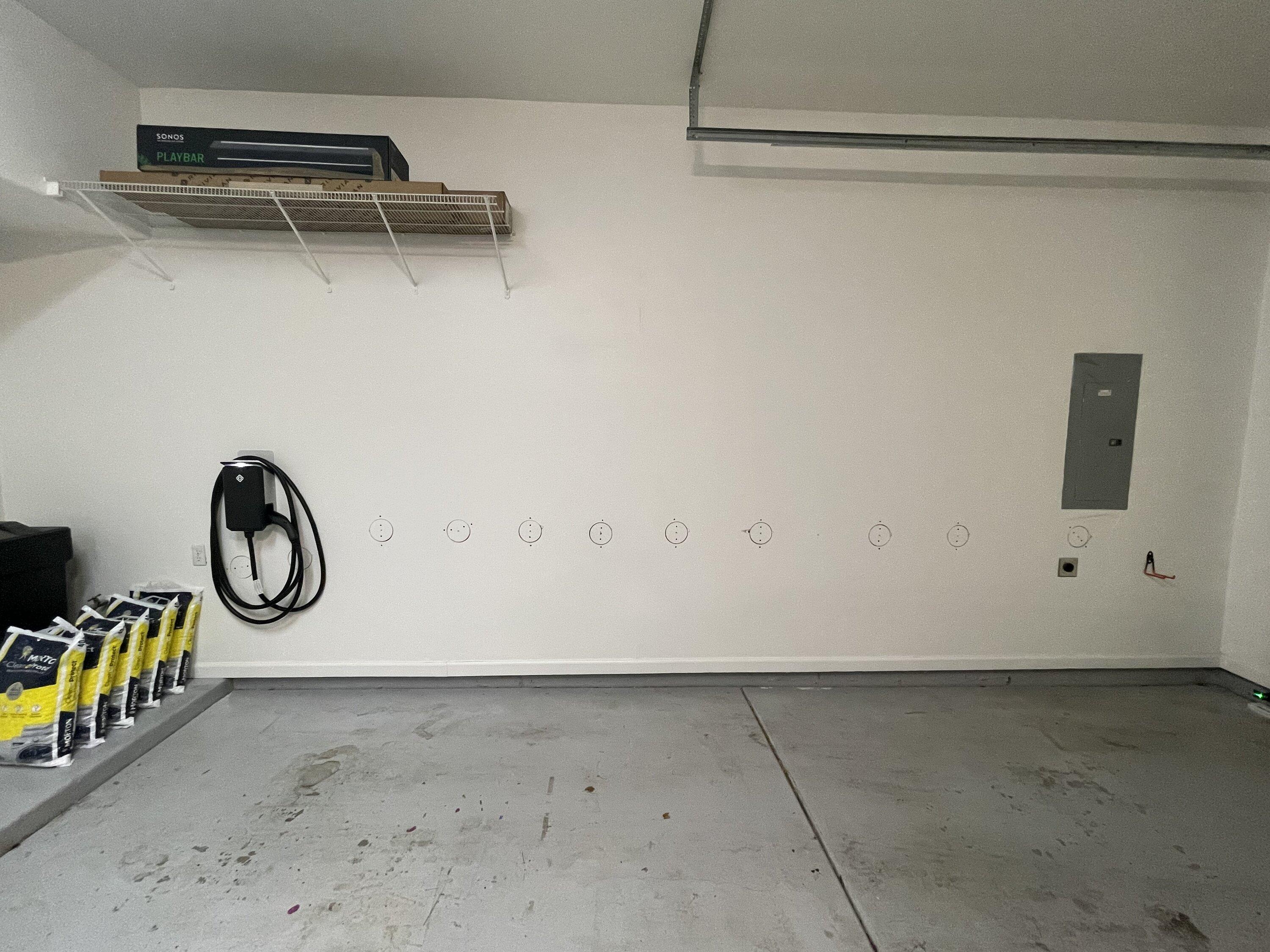

Final decision was to run 6awg copper wire the ~25ft to the 200W sub-panel in the garage. All 3 electricians said I was “borderline” to use a 60A breaker, so we went with a 50A breaker for now and will only charge at 40A. If, at some point, we shift a condenser or two off of the sub-panel or get better tech, we have the 6awg wire already buried in the wall to accommodate upsizing. Thanks for the recommendation, @Christopher @WSea @pc500!
Pics below after the electrician left. He was generous enough to mount the drywall pieces back into the holes with backer board. Nice work from my layman’s point of view. Just need to sand/tape/mud/paint and it should look nice and clean!
Rivian R1T R1S Charge time difference between 60A and 50A? 25E4DEA1-C344-43D5-8481-D8991B4B89AA
EDIT: For anyone interested, I had quotes Of $1100, $1200, and $1500 all-in. I went with the $1500, because it’s a guy we use a lot and he’s absolutely meticulous. Wanted it done right the first time.
EDIT 2: New rig should hit the local SC in Phoenix on Monday. We’re all set for it (I think)!
