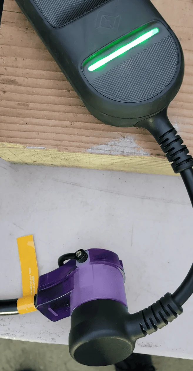

have to use a neutral to ground bonding plug on any generator or inverter to get it to work on any EV charger. The charger needs to see continuity between neutral and ground

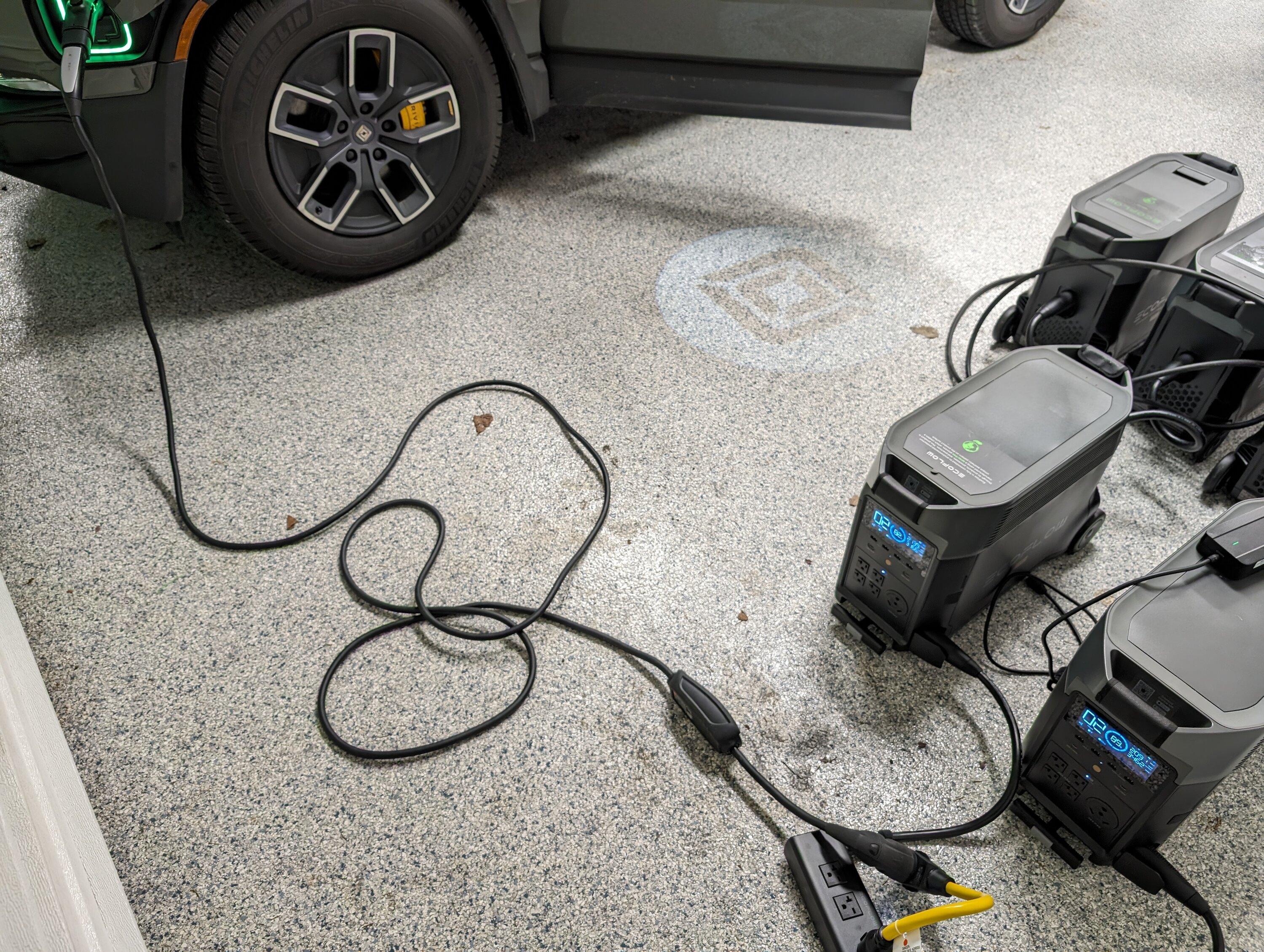

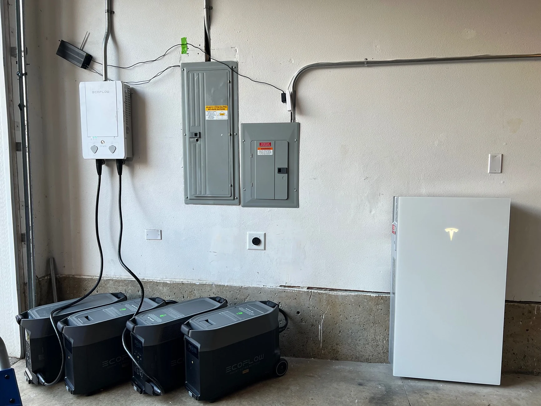

Reviving an old thread - I have a pair of EcoFlow Delta Pro plus two extra batteries to help with home backup when I'm home, and as mobile power for my travel trailer when camping off-grid. (Similar setup to Redmond Chad) and recently had the opportunity to use it to rescue my dad, who accidentally ran his Kia out of charge.
The home setup:
Rivian R1T R1S Charging a Rivian with an Ecoflow Delta Pro IMG_4513
Got a Tesla Powerwall 2 installed with solar panels in 2021, it runs "essential loads" in the smaller breaker box. It recently dropped below the warranty replacement threshold, so got it warranty replaced, and they replaced it with a Powerwall 3. The two Delta Pro plus two extra batteries are on the floor, plugged into the EcoFlow "Smart Home Panel" above them feeding 8 "non-essential" circuits. I figure in a power outage that we're home, it would be nice to have lights and outlets in some rooms the Powerwall doesn't feed; but if we're gone on a road trip with the EcoFlows, it isn't a big deal to have those circuits unpowered. The Powerwall runs things like the refrigerators, furnace, one outlets-circuit to run internet router and home office, and garage door openers.

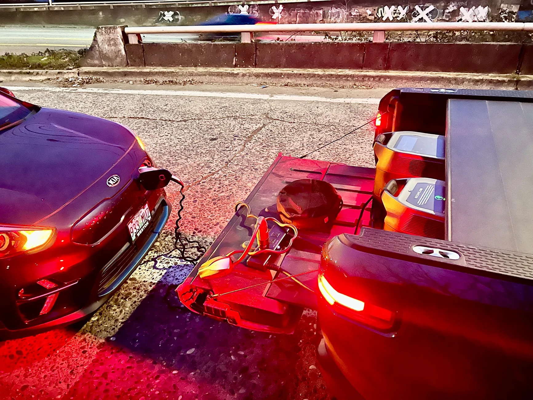

Here was the rescue, using the 240V combiner Chad showed, and a Tesla mobile cord (because it works fine with a floating ground) plus Lectron J1772 adapter.
Rivian R1T R1S Charging a Rivian with an Ecoflow Delta Pro IMG_4469

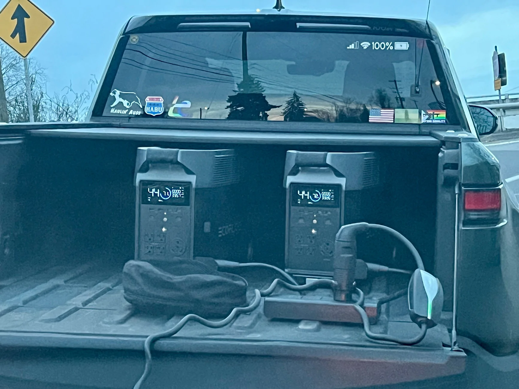

For @Michal - yes, they fit under the tonneau. I only brought the main Deltas, not the extra batteries, because I knew they would have more than enough juice to get him home.
Rivian R1T R1S Charging a Rivian with an Ecoflow Delta Pro IMG_4471
Yes, he made it only partway up the off-ramp before coming to a halt. He misread the distance he needed to go that day, and thought he would be able to charge at one of his stops, but the L2 was down. He made it to about a mile and a half from his house.
