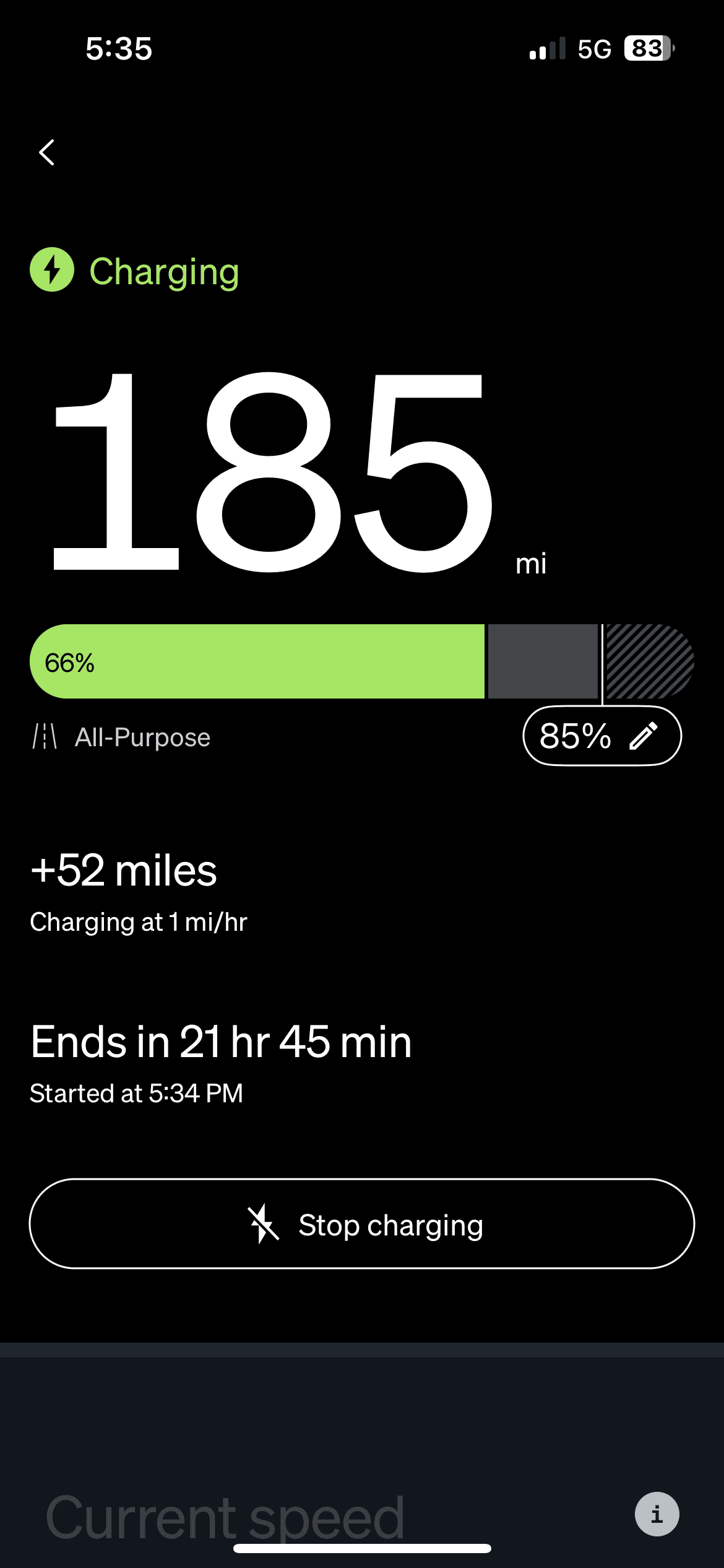

Followup:
In Florida, 133 miles from the first DCFC on my route home. I had to try two different circuits (first one didn't work with the wall charger although it works fine with my golf cart).
Charging now on 120v, and have added 52 miles in the last 24 hours. Should be good to go for my departure home in the AM.

Remember not to cut it too close... when the car starts preconditioning for charges, the miles drained like a bank account... don't ask me how I know.
Thanks for that. I'll be fine though, I was at 79% (leaving that charger) and drove here with about a 5 mile detour to run an errand on the way. Arrived with 67 miles of nominal range driving in all-purpose mode and not being at all careful. No preconditioning on the way down, but I've also got another 14-15 hours of charging to go.
I think 133 miles won't be an issue, even with my normal heavy foot ;)

Followup:
That is actually better than I thought it would be.
