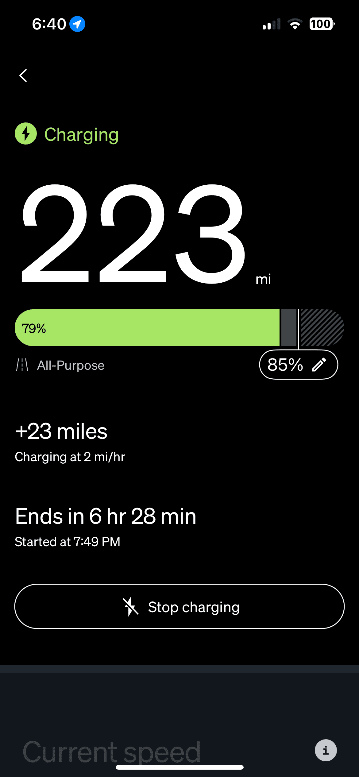

One more data point.
I let the truck sit on the 120V outlet for 12 hours last night again. Similar mild temps, gear guard off but no other special steps.
Again seeing about 2mi/hour over 12 hours, which seems to track with what others are seeing.

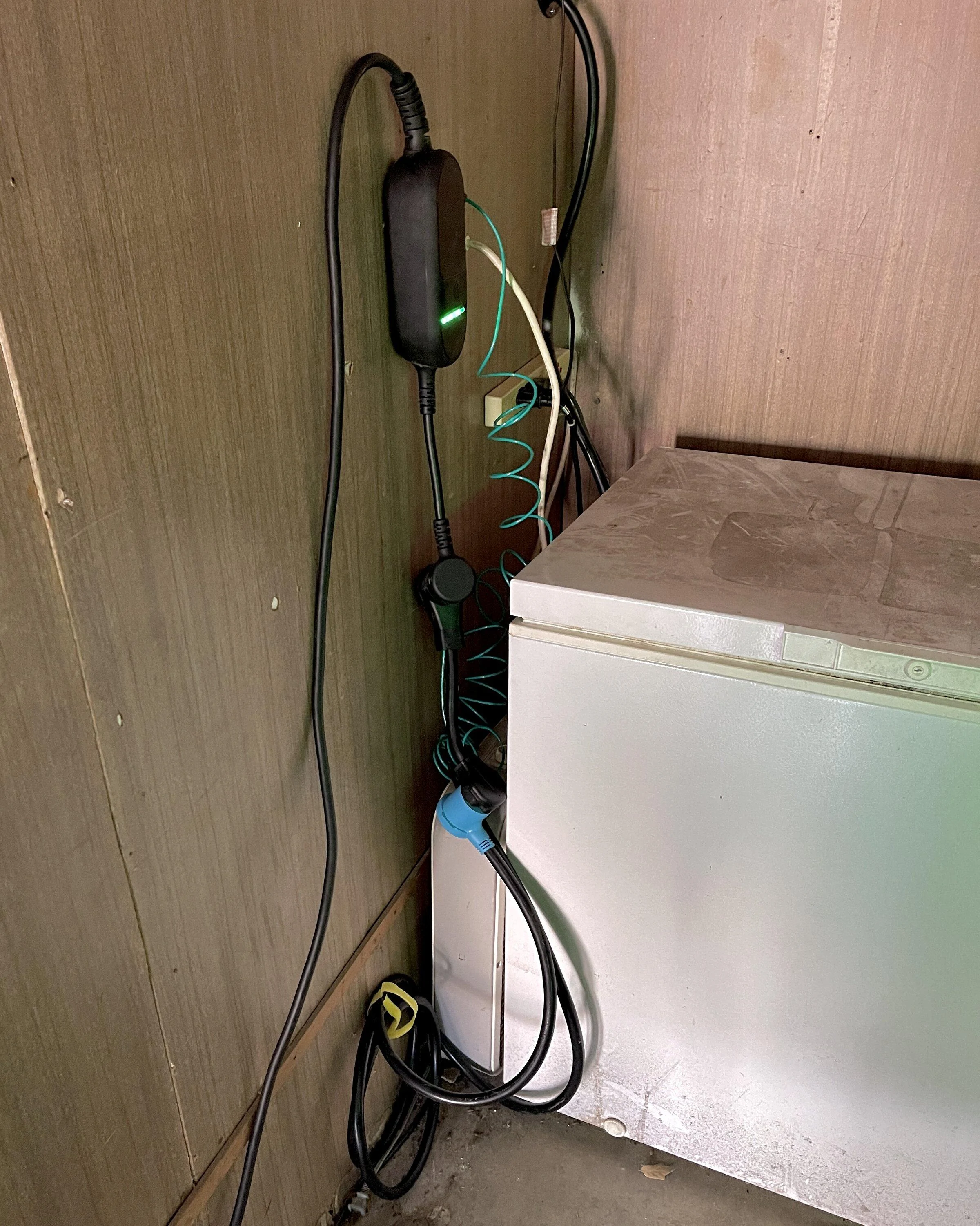

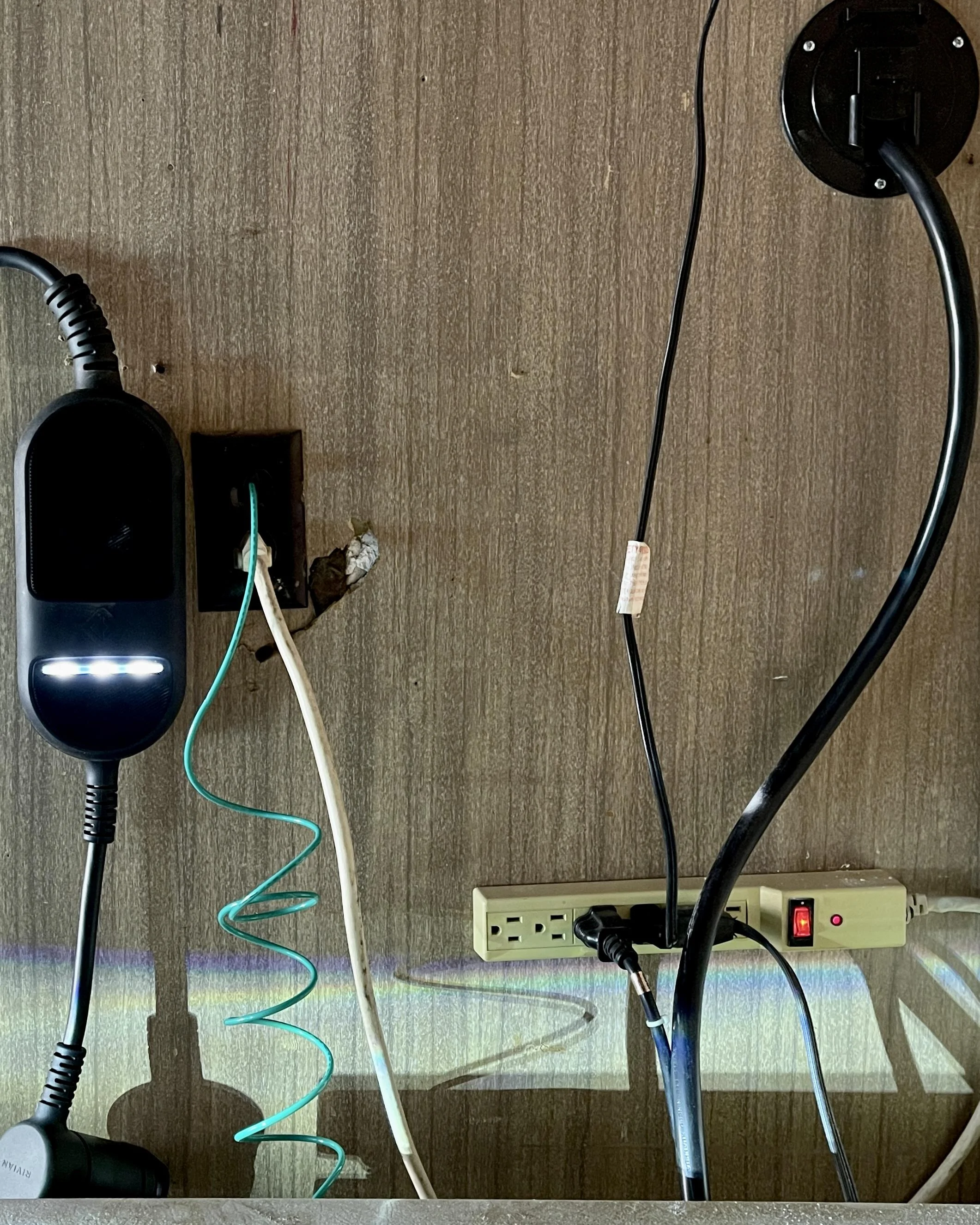

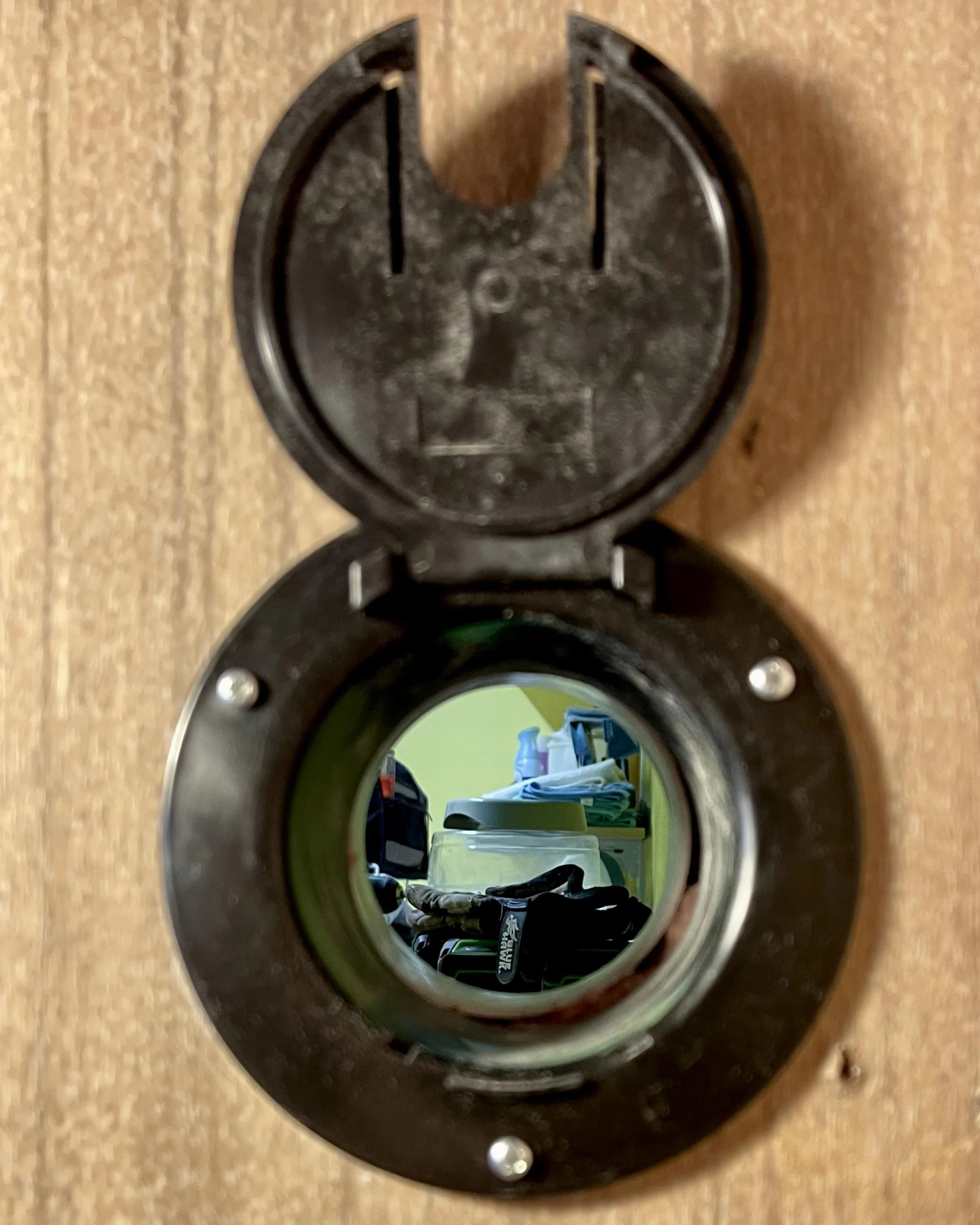

FWIW, I recently purchased some cables and adapters to charger off our our 220 dryer outlet. It was only about 10' from the truck "as the crow flies" if the crow could fly through the wall between the two.
After hooking up all of the extensions and adapters, and putting a hole in the wall with some RV cable ports, I am now charging on a 30A outlet and gaining about 13-18 miles back per hour of charge. It's a temporary solution until we can get the breaker box upgrade and get the dedicated charger, but it's a good enough solution for the next 3-6 months.

This is a solution we've considered as the location of our breaker box and a finished basement will require either cutting the ceiling and having work done to repair, or running conduit outside and around the house into the garage. For the 30A dryer circuit, are you setting the Rivian charge limit to 24A?

^ have you checked the temps of the adapter ends after charging at 32amps for a few hours? The connections are usually the weak point in the system.
If this in in reference to my adapter post, I actually reduce the charging level to ~24A just to be safe. Nothing has been hot (or even really warm) to the touch during my charging sessions.

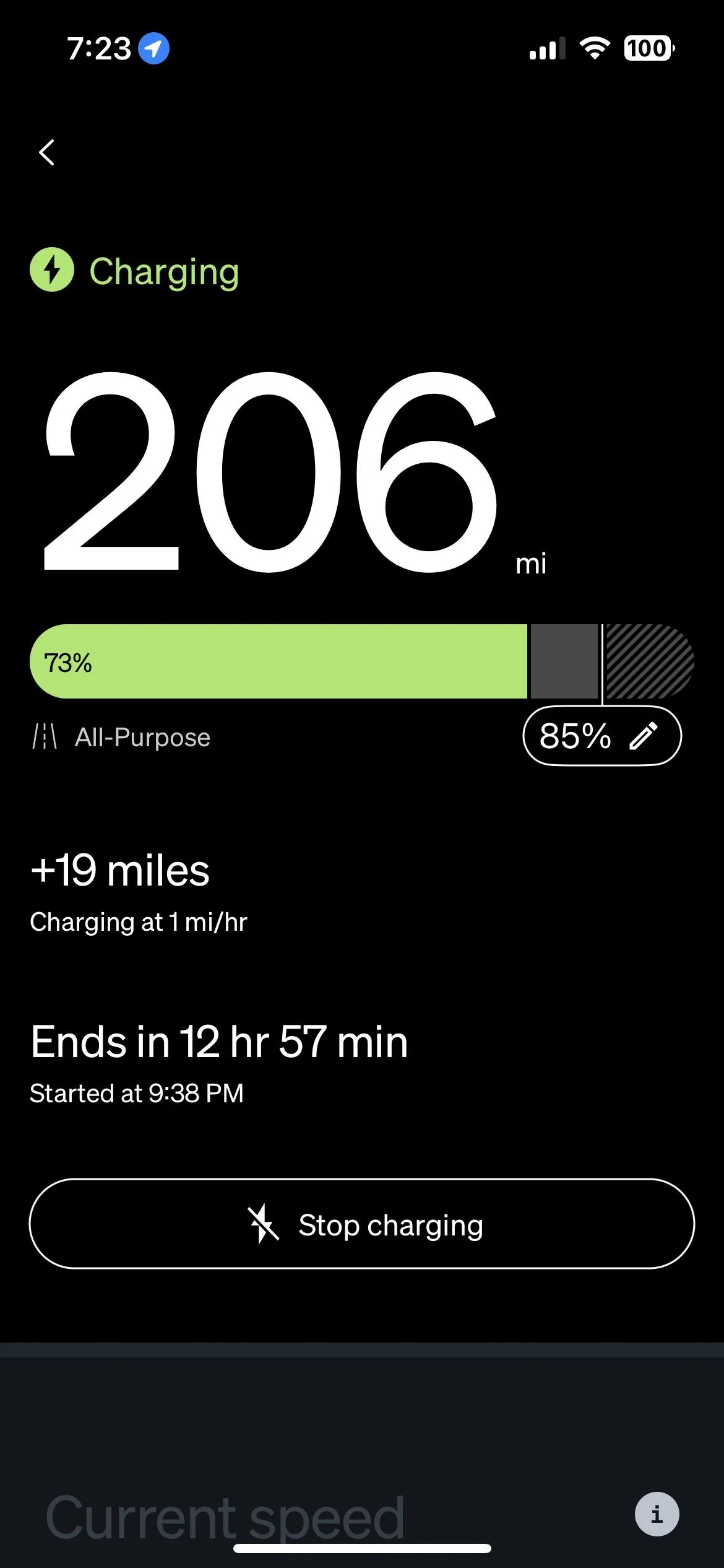

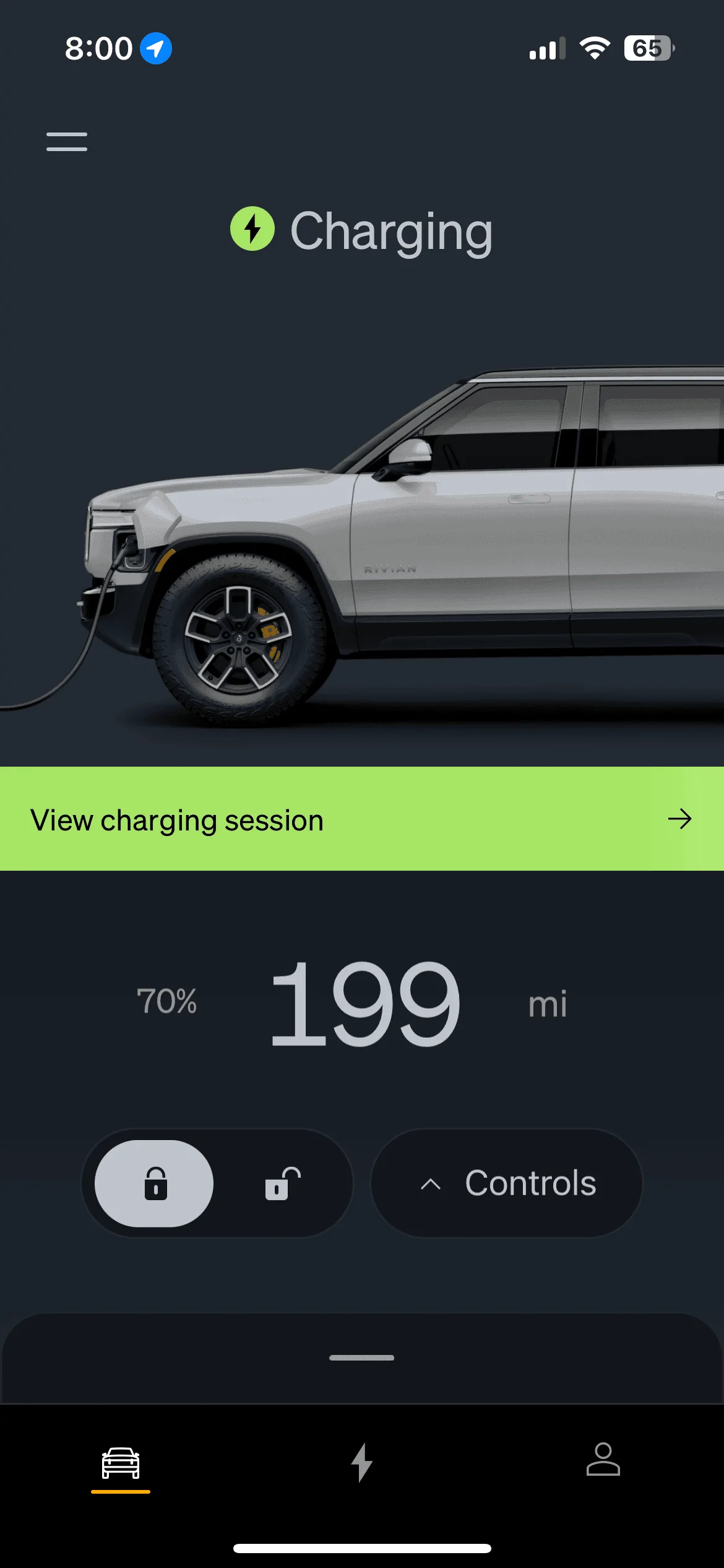

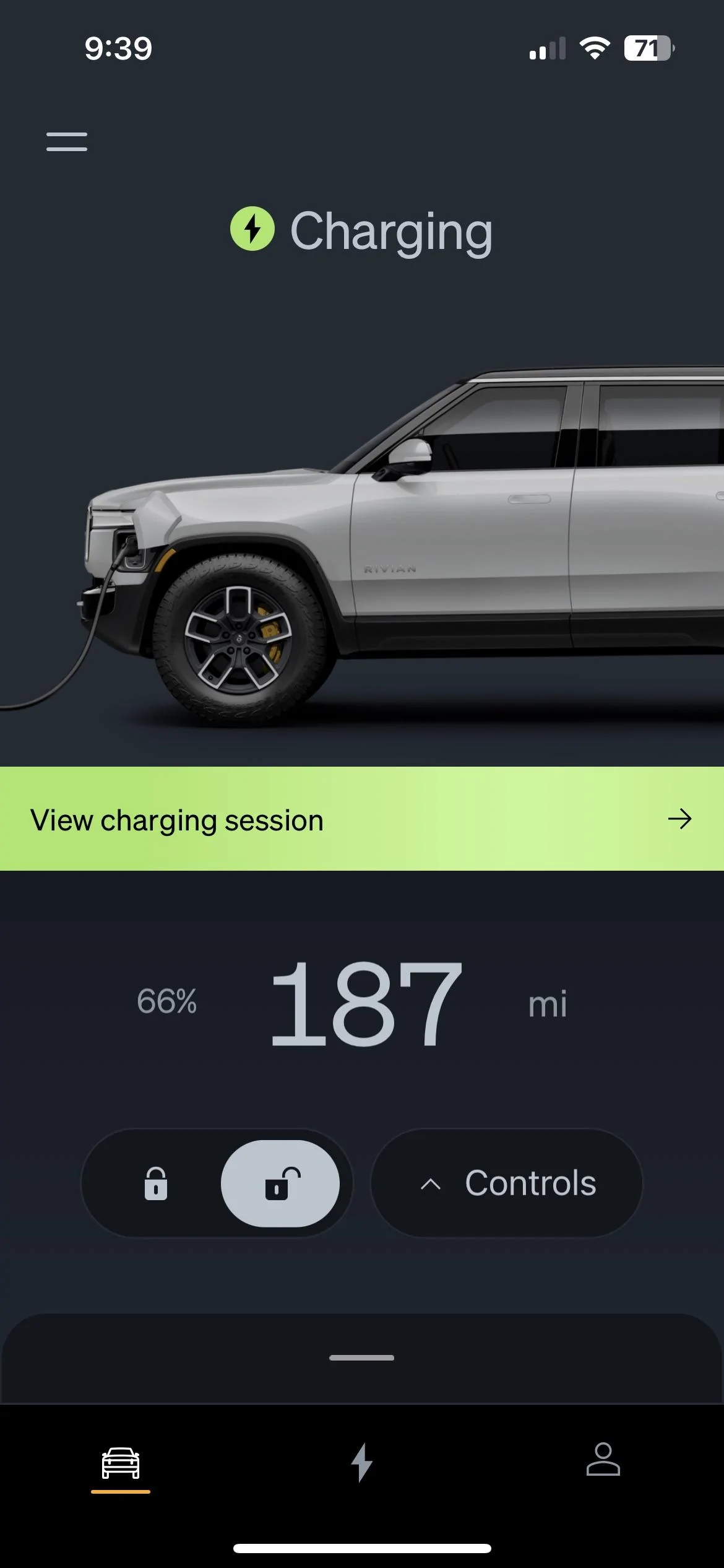

Ok, so I know it’s not recommended, and even Rivian’s official guidance seems to discourage it, but I haven’t seen it reported on the forums, except in the context of freezing temps and unable to keep up with vampire drain.
last night, with my R1S at about 66%, I set the charge limit to 85% and plugged into a 120v/20 amp wall outlet, on a circuit shared with a refrigerator and a couple of surveillance cameras but nothing else turned on.
the car hadn’t been driven in a few hours, I have gear guard off at home, and the temps in the garage average low to mid 60s over night. I did ‘t try to put the truck to sleep or do anything special.
I just updated to the latest software as of 3/7/2023 (2023.6.2)
i checked after almost 10 hours, and it had added 19 miles. I think that’s useful in a pinch, as we have a vacation home that is 133 miles from the nearest DCFC.
Oh my, 1mi / hr :( But I agree, better than nothing if desparate.

I had to get three different adapters before I found one that would work on the ancient dryer plug at our cabin, but now I get to take the R1T offroad through the woods and around the back to charge through the bathroom window when I go so... Win-win.
The main issue we had (aside from having to cut a hole in the wall) was to deal with the fact that the portable charger requires a ground, and our 1960s built house has only a couple of grounded outlets - the 30A dryer outlet not being one of them. So I had to get the 10-30P to 10-50R adapter that adds a ground cable that I was able to plug into a nearby 120V outlet that actually was grounded.
I will admit that I did a lot of research and testing to come up with a workable solution until we can get the dedicated charger installed.
