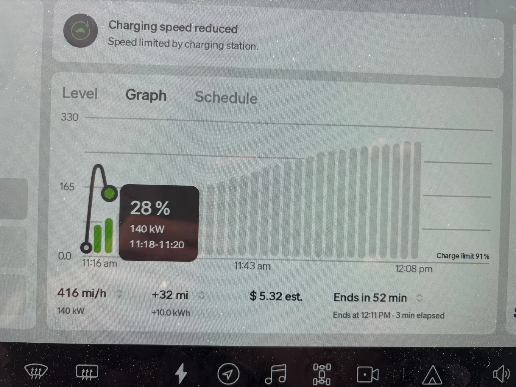

I think the conventional wisdom that Electrify America is bad and unreliable is seriously out of date in many areas now. I've had very good performance with the new 350 kw dispensers throughout the midwest and western states. Conversely, my recent experiences with supercharges has been meh...... They have quickly dropped to 150 or even 130 kw with a "speed limited by charger" messages. EA and Electrify Canada on the other hand hold 190 to 210 kW for a long time.
Check plugshare on your intended route and if the EA stations are getting good scores, I think they are a very good option.
I agree with you about EA being much more reliable now. The main issue I find with EA chargers is that they are crowded. I also agree that Tesla chargers derate quickly, especially in the heat. Here in AZ I typically see them drop to 110-120kw, it is also likely the adapter, but my adapter never feels really hot.
I do not think it is the adapter, the Superchargers in the Coachella Valley slow down when temps get up over 105 even with my Tesla.

But I specifically get “speed limited by charger” messages in the Rivian UI. Happened multiple times with Superchargers, other Rivian drivers have said that too at Supercharger stops.
Yes, the Tesla superchargers slow down in the heat even for Telsa drivers. Ever see those images of Tesla drivers draping a wet cloth over the supercharger handle to keep it cool so it wouldn't derate?
BTW, that's one of the requirements in the NACS standard, that the power is reduced if the connector gets too hot for whatever reason. It's designed to do that.
