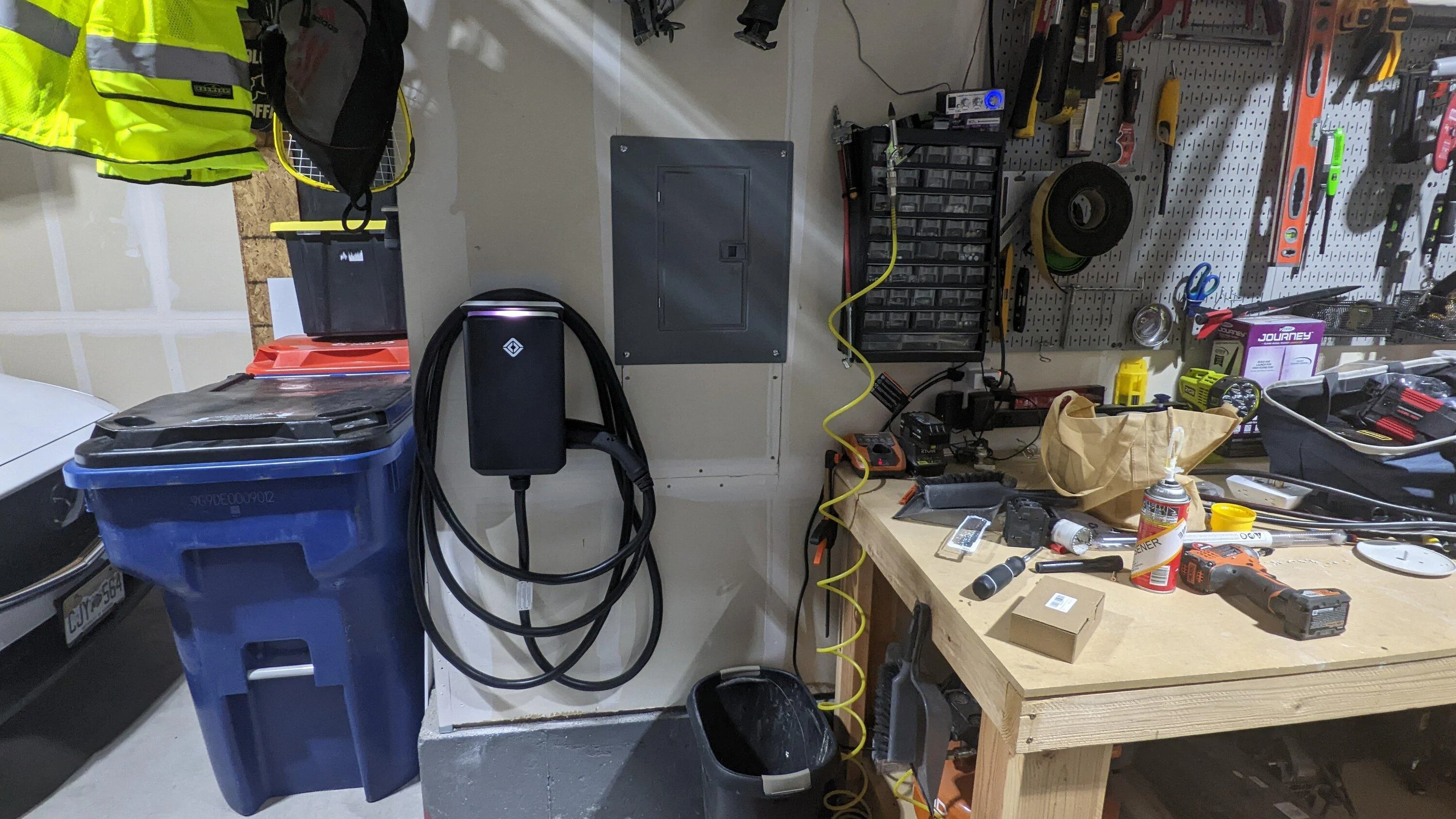

Anyone have an electrician them have used for installing their EV charger in the Broomfield area? We've used a standard plug for our Tesla, but once we have the Rivian I'm going to need a Level 2 because of the battery size and efficiency.
I got a few quotes but my breaker box is on the other side of the house from the garage so they wanted $3k-$4k to do the cable run and install. I opted to watch a bunch of videos and install myself with a little help for the final connections from a handy uncle. Pulled a permit and had the city inspect it to double check my work. Ended up only costing me $700 which included a sub-panel in the garage for future expansion if needed.
I am definitely not handy enough to do this by myself. When it comes to gas or electricity I pay someone who knows what they are doing to do it for me hahaha
