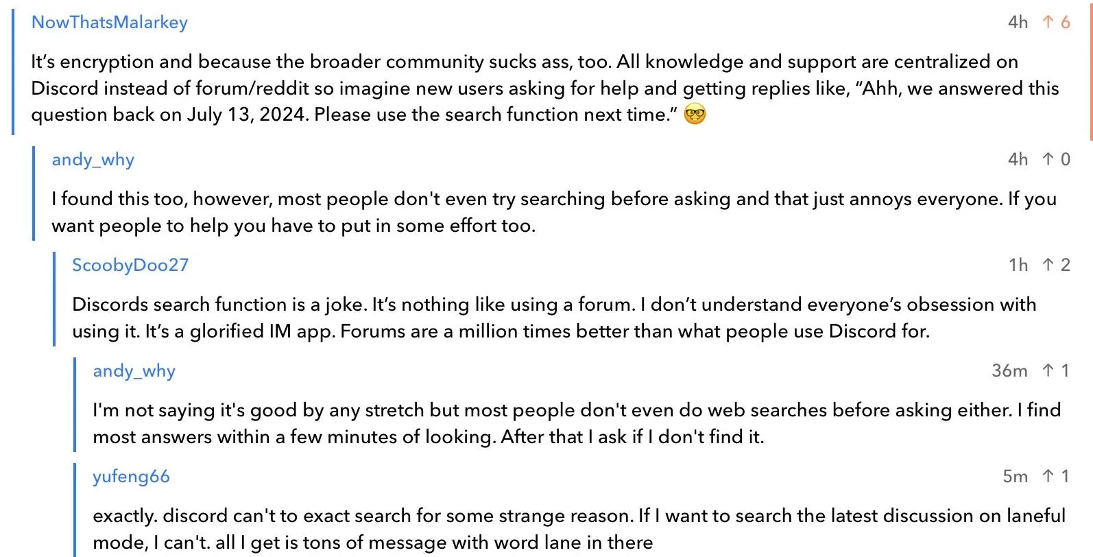

Some commas are drawing too much power especially with forks that are doing more and you may need to install obd power to avoid this. In the meantime, if you have time I would advise plugging your comma into power in your house and installing sunnypilot/mads-tesla-prebuilt. It’s a bit more stable than Lukas new branch and will allow you to try MADS hopefully without the power glitches. Happy to help if you have additional problems.
Thanks, that's logical but also makes me wonder if now I've got a damaged harness, blown fuse...etc? I have Lukas' harness. The unit turned off, and would not turn on at all. It didn't give the low voltage warning you get on low power USB bricks. How would you branch out from the harness and also get OBD power?
There's an interesting discussion about how encryption may kill Openpilot in the long run, and this part was amusing. I completely agree, having worked in software/systems dev for nearly 30 years.
