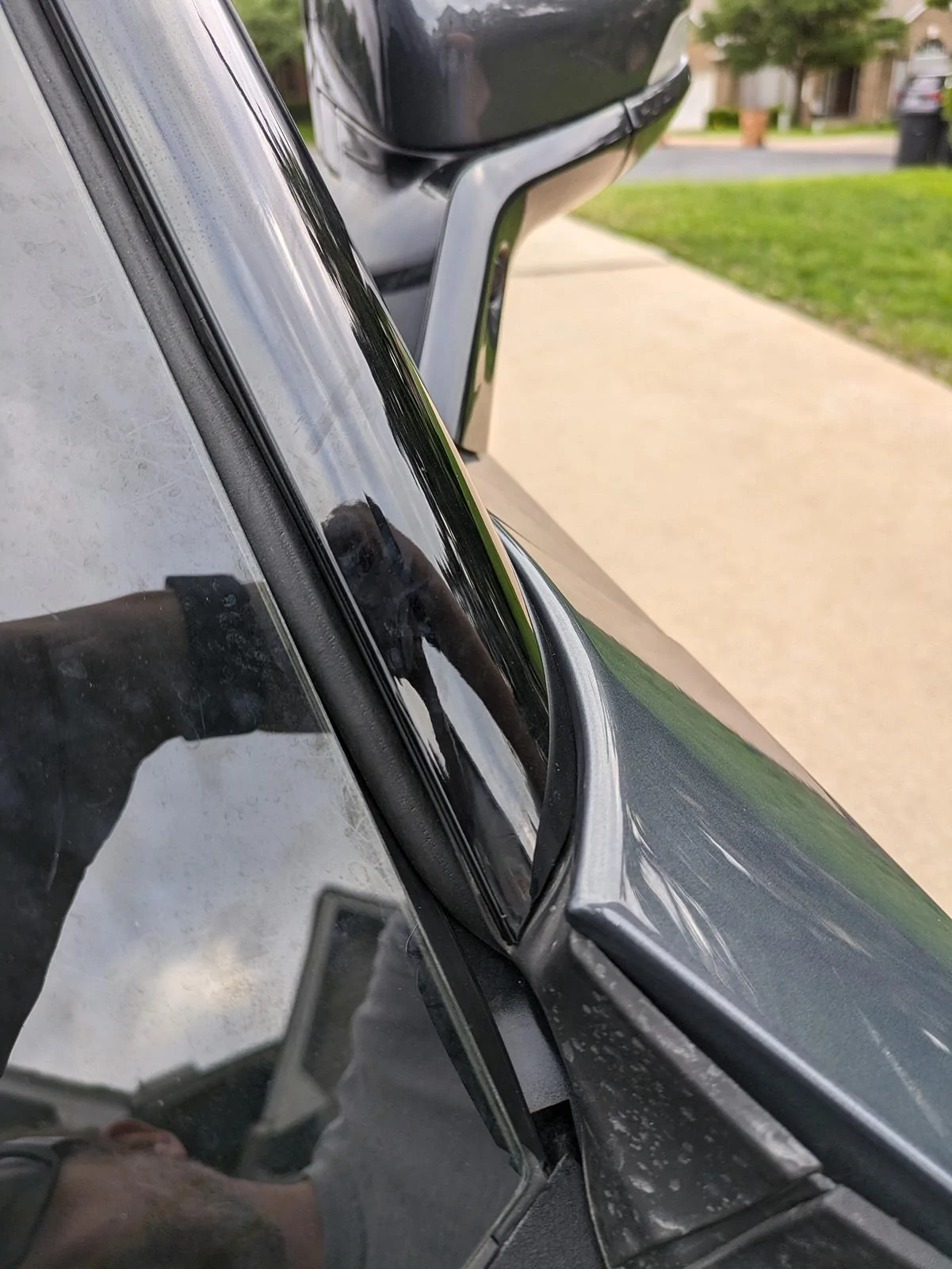

In my case I am getting A piller wind noise that is not due to the small triangle or the door side of the a piller trim or the top applique. I sealed the a piller top and door side of the a piller trim with 6mm tubing.
But I had to get 10mm tubing to fill the gap between the windshield and a piller trim. It did help more than anything else I tried, but what I noticed is that 10mm is not big enough for the lower part of the a piller trim.
The existing seal that is there has no structural support, it is just cosmetic, you can poke your fingers into it and feel that it's just an air scoop straight into the a piller.
I attached a picture of the 10mm tubing, it looks pretty good, but you can also clearly see where just falls into the hollow gap that feeds directly into the a piller.
It would probably take a rather large block of foam to seal up the bottom of that a piller ... does anyone how to remove that exterior trim piece? I suspect form fitting that trim piece will completely eliminate the wind noise in my case.
Also, you can "knock" on the a trim, in my case it is a very hollow sound all the way up until about the top quarter of the trim.

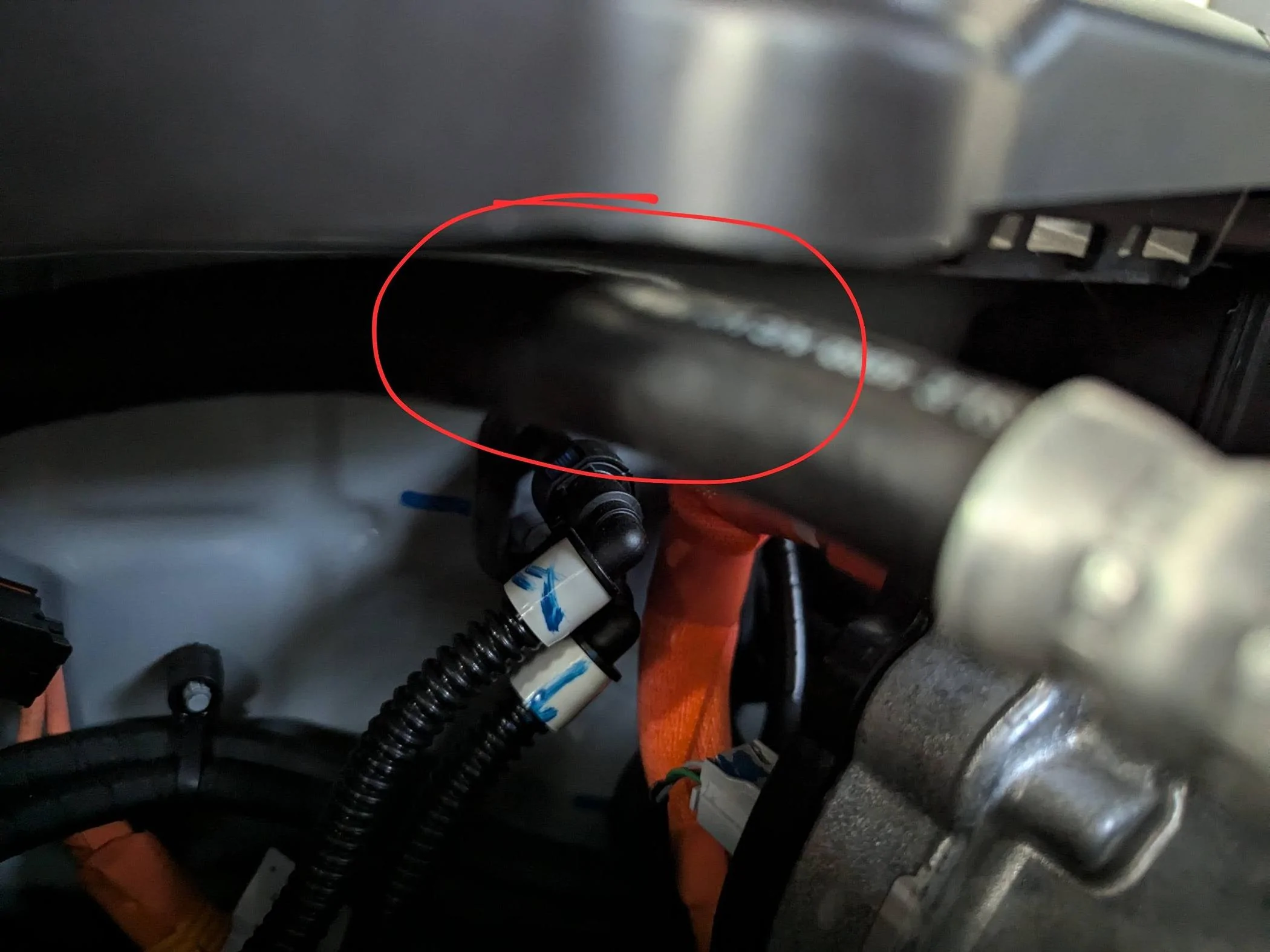

I believe I have located the source of much of the AC compressor vibration. The noise unfortunately is normal but the vibration and in some cases rattling is not.
I believe a lot of the vibration and rattling is due to an AC compressor. Refrigerant hose resting up against the cowling. See this rather terrible picture I took while investigating. The rubber on the refrigerant hose has been damaged. After a year of the rubbing. I installed a piece of foam weather stripping and on a recent road trip to Boston. Most of the vibration and all of the rattling noise is gone. The normal buzzing noise the compressor makes is still there of course.
You can easily check this by taking off the plastic cowl cover and see if you can fit your finger between the refrigerant hose and the underside. If it's been rubbing, you will likely feel rough spots on the rubber insulation in the hose as well.
Mine goes in on July 3rd and I'm going to see what they're planning to do to address it. This is only present on our R1T build date 3/2023. Neither of our R1S had this level of vibration/rattling noise. Strangely it only seemed to happen above 85F ambient.
Thank you for this. This was indeed the same issue on my R1T. Used some foam weather insulation on the bottom of the plastic cowl so the refrigerant line no longer rubs and vibrates against this piece. Took it out on a drive and while the AC compressor is still loud, my dash no longer buzzes like before.
