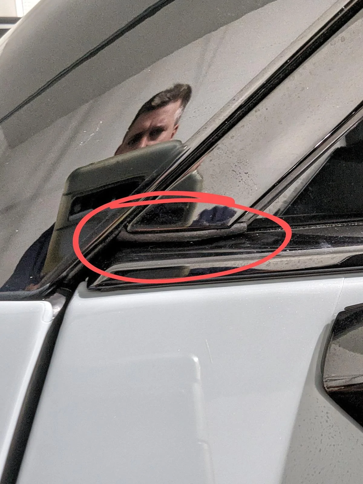

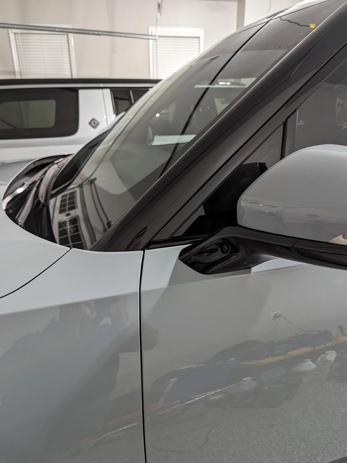

Mine has been pretty good. Some wind noise but I picked up some 6mm foam listed in another thread, cut to length, and installed them near the triangle glass. Works great and looks factory. The T has a bit of rattle but it seems to come and go which tells me its related to air suspension or kinetic ride control.
These are adventure vehicles so they are not going to be bank vault silent.
