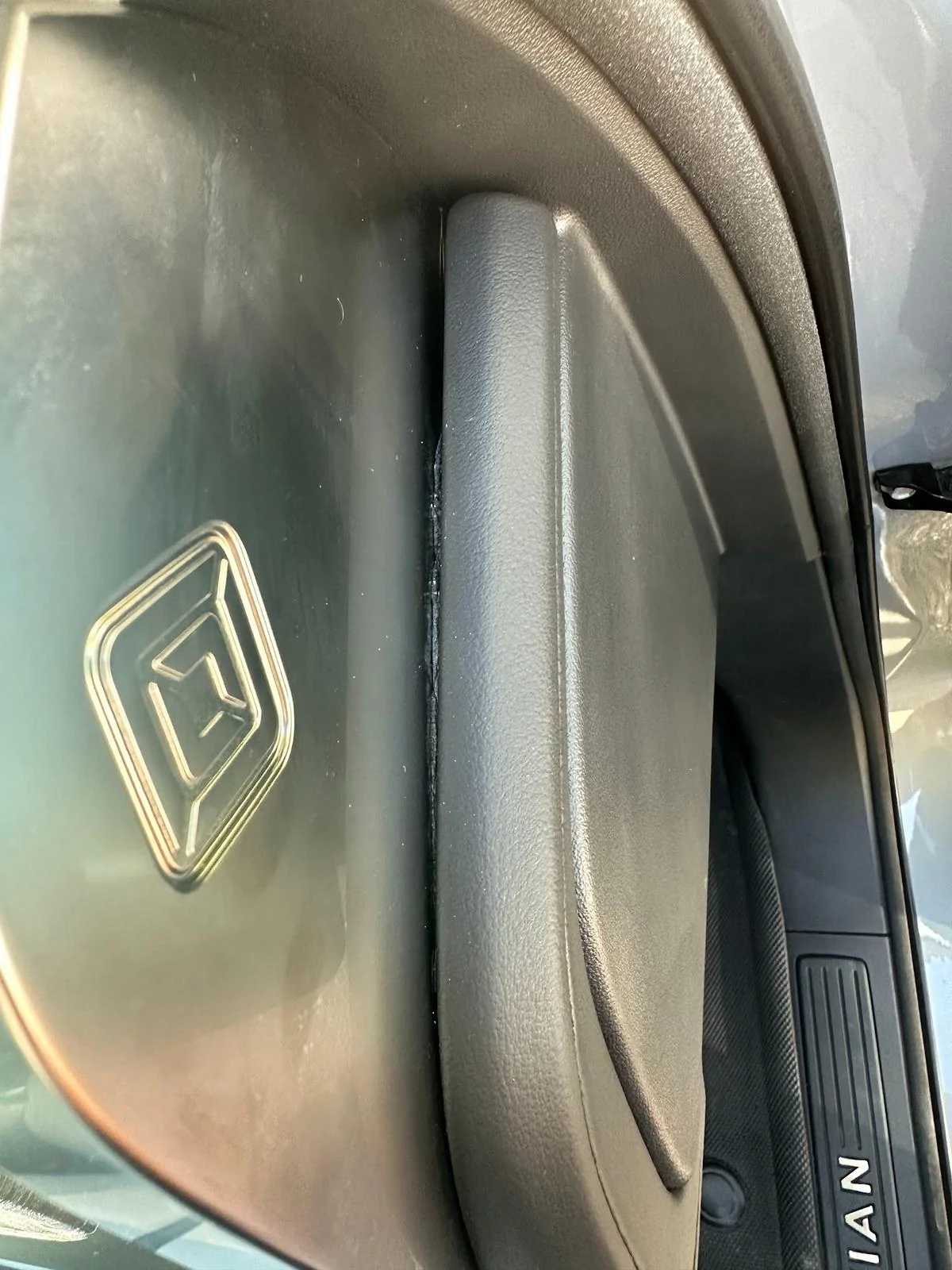

These two pieces would squeak over bumps. I probably could have hidden the tape better but it's hard to see unless you're looking straight down. I have rattles in the seat belt adjusters in the B pillars too. No idea how to address those.
Still thinking which part of the vehicle it is??? Would you mind sharing zoomed out picture ?

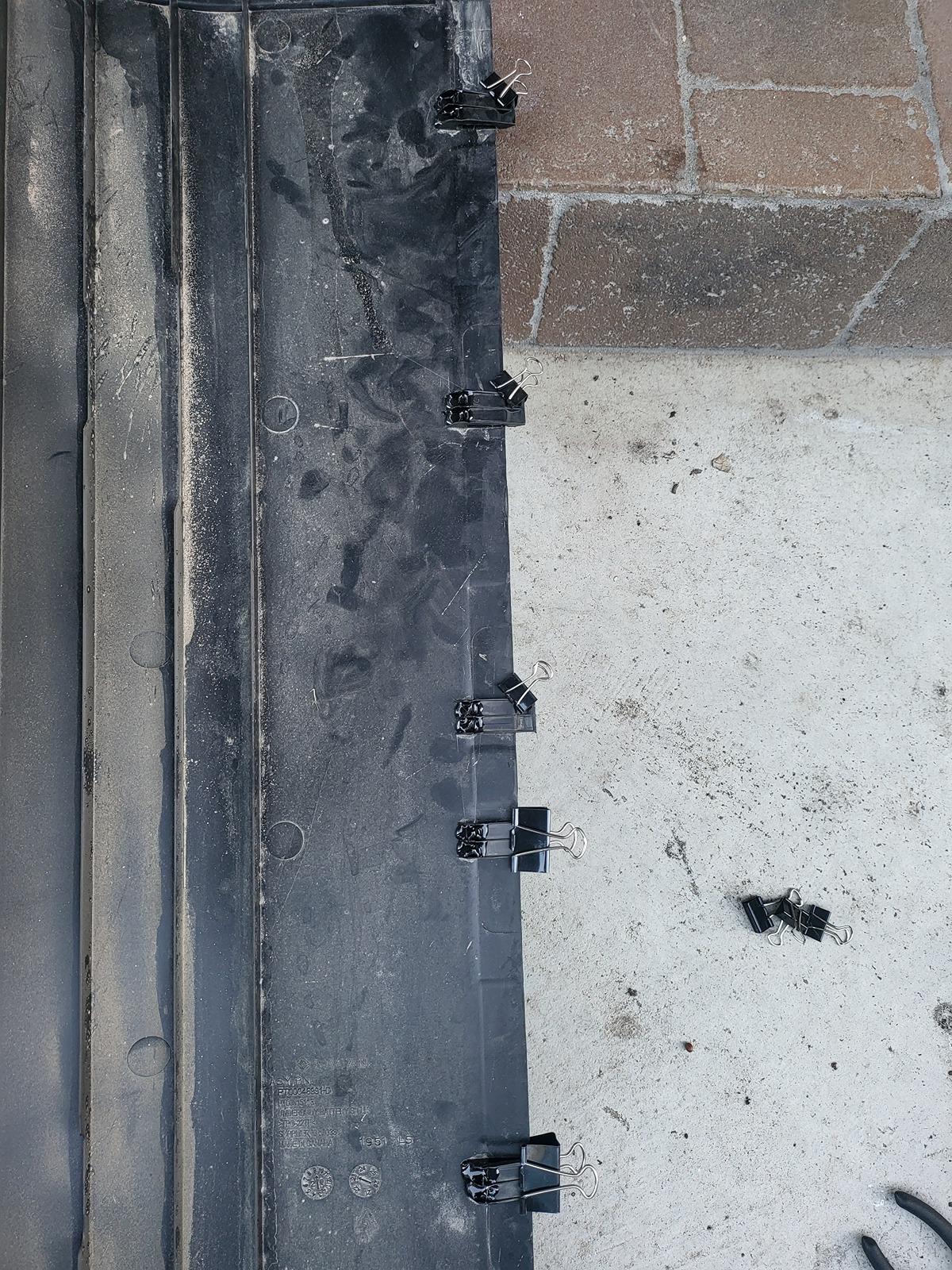

Good start of a list! I'll contribute one. At about 70mph I could hear a high speed panel flutter banging away under the car. Basically someone at the service center had pulled off one of the plastic rocker panels and bent all the cheap plastic clips. You can diagnose by checking the panels. Video below.
I took the panel off by unscrewing the ones at the wheel wells, bending down slightly and using a long screw driver to pry the clips under the doors loose. Repeat with the long panel that's loose by first prying the inboard section down. This is the section with the lose bent clips. I then used some glue to reenforce the crappy clips and carefully put the panel back after it dried. No more rattle but the next time the panel has to come off they will get jacked up again. It's a horrible design.
