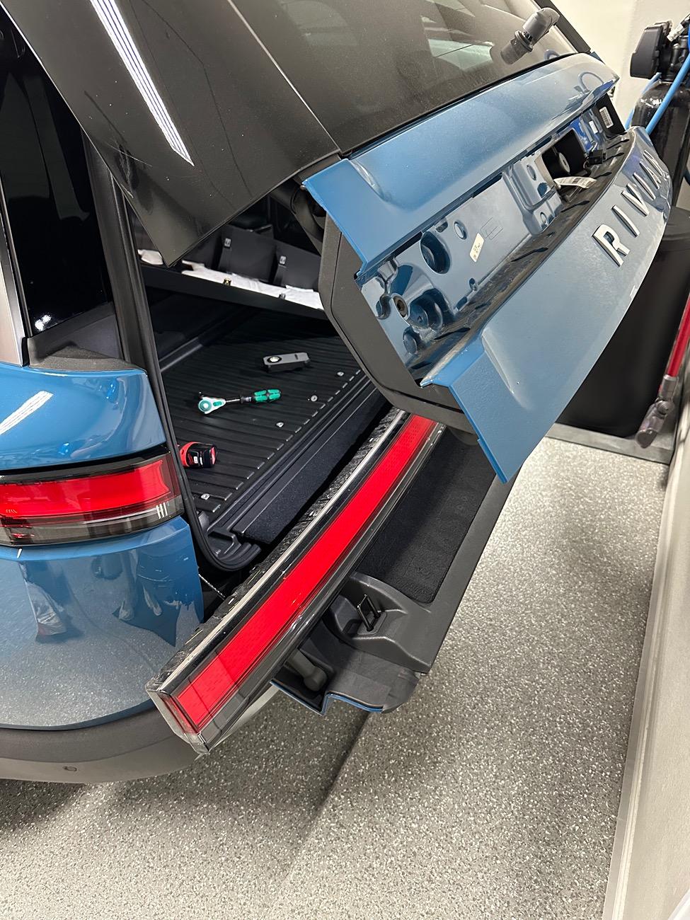

JWreck
Josh
Oct 3, 2021
303
401
R1S (pre-ordered, Audi RS5 Sportback
Here’s a new one for us. Rear light bar squeaks like crazy with the slightest movement when driving even over some of the most smooth roads. Recreated by applying light pressure to either side of the light bar.
I removed it to clean it and make sure it wasn’t just dirt. Before adding felt tape myself, figure I’ll give Rivian a shot.
Service Center appt in a couple weeks.

Tango001
Apr 24, 2024
72
Illinois
Haven’t
Haven’t noticed that one, will check it out.

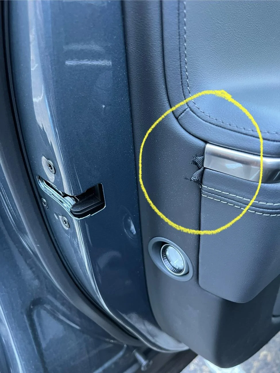

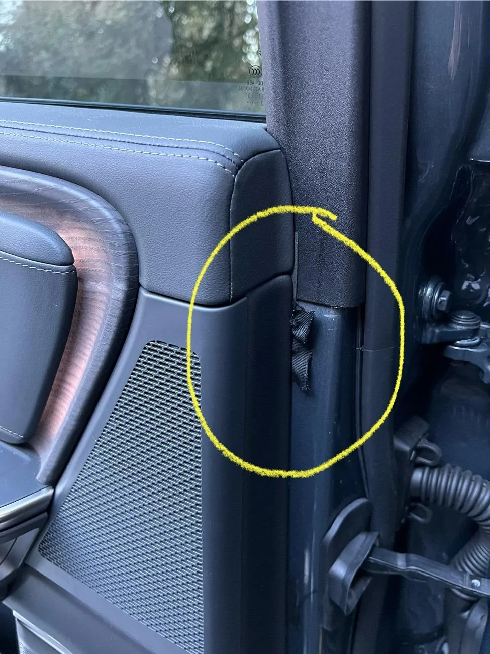

rchilde3
Ryan
Feb 25, 2025
Lake Oswego, OR
2023 R1S
Anyone run into a rattle like this yet? Seems to be coming from the rear passenger door/bpillar area. It stops if I press on the door panel above the speaker.
I've suffered from rattles from (seemingly) all 4 doors on my R1S. A few mobile tech visits helped for awhile, but they returned (or new ones developed). Recently, took the time to have my wife drive the car around while I systematically tried to isolate the rattles. For at least some of these, it appears to be caused by rubbing between the interior door panels and the metal door frame itself. Putting pressure with my hand on various places would pause the rattle. I took this further based on some other forum posts and carefully worked in small pieces of felt at suspect locations. I used a guitar pick and a tiny flathead screwdriver to slot the felt in certain places. Glamorous? No. Functional? After a few weeks, seems the answer is yes! Most of the more annoying rattles seem to be gone. Hope this might help a few others out there trying to quiet down the ride!
