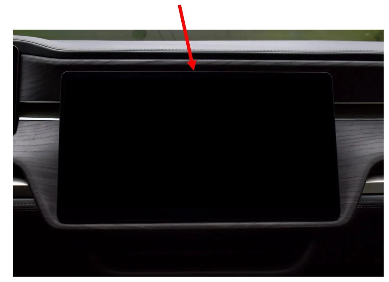

I was getting a lot of rough road noise around my center dash area. At first I put a thicker rubber piece behind the screen to get some separation of the screen from the dash. The ultimate fix was put an additional piece of felt in between the top of the screen and the dash to get some separation. No more center dash noise.
Wonder where this noise was coming from...Thanks!
