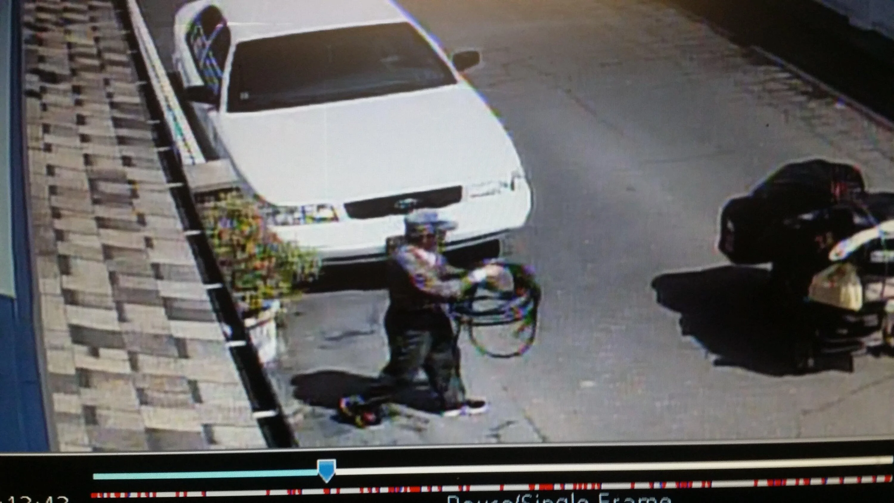

Unfortunately they take everything around here, including the garden hose :) Even with security cameras.
Rivian R1T R1S Configuring outside charger, any thoughts? 20160620_194441 (2)
They don't take everything, you still have a security camera.

That's only 'cause I lock up the ladders ;-)
