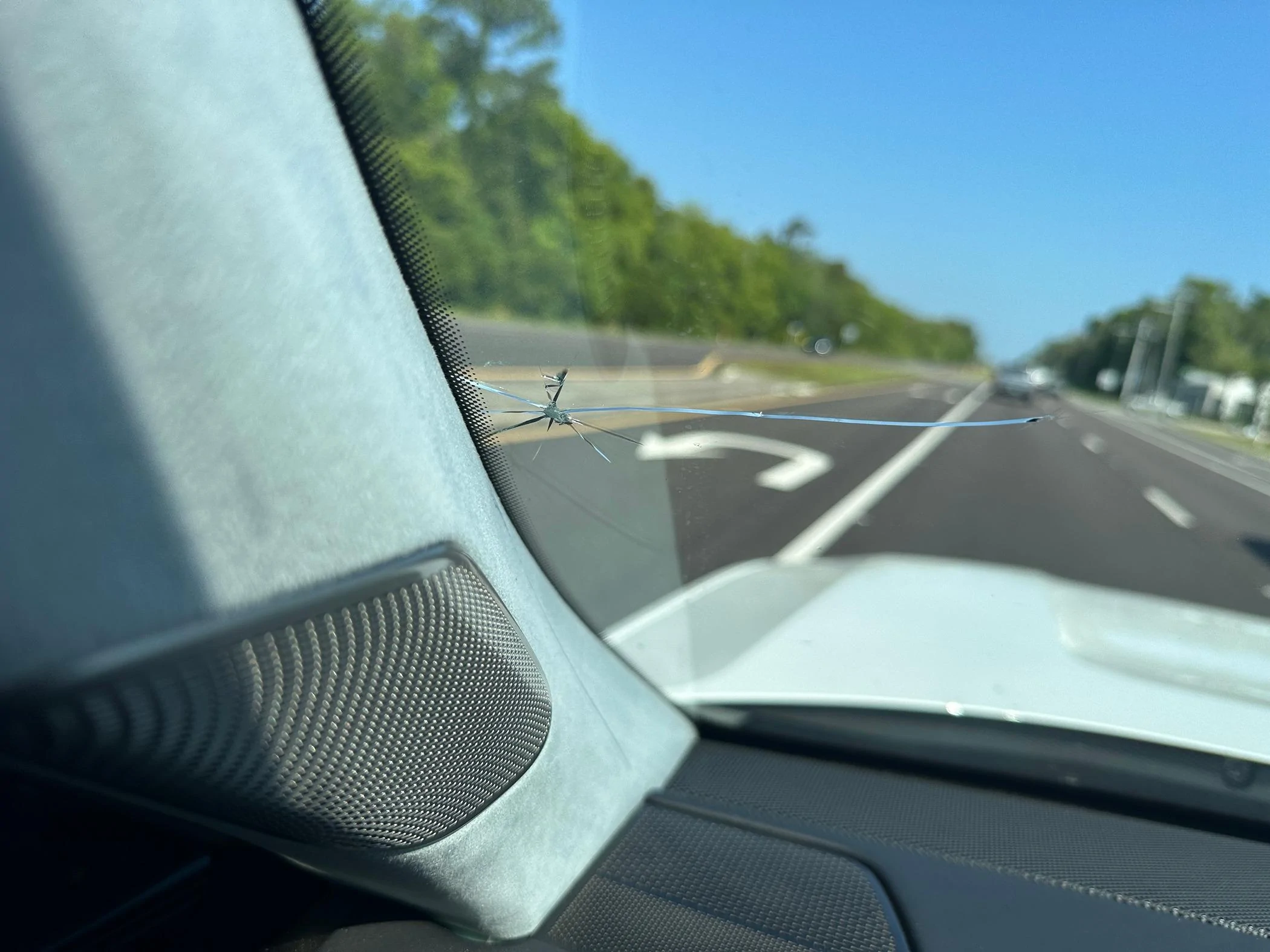

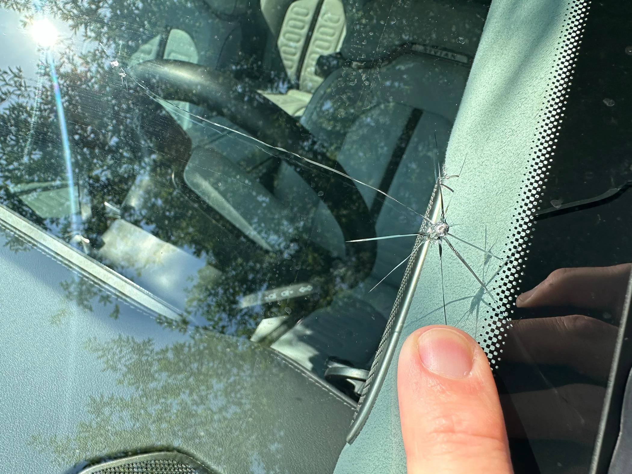

Just added windshield replacement to my open service center ticket. I've had two small chips on this windshield, both repaired pretty easily with the Rain-x windshield repair kit purchased from Amazon ( https://www.amazon.com/gp/product/B00IPS4APU/ ). This one's a bit bigger, though, and the lateral ray from the break actually stopped at one of my previous self-repair locations, so I could see this one splitting even further. I'm still going to try a self-repair tonight, but it is probably time for a replacement.
Maybe Rivian is making tougher windshield glass as part of the factory retooling! :rock::rock:
This is my third windshield in this R1S in right at a year, the replacement will be #4. The first two replacements were from bad seals - the first from the factory and the second from the replacement of the first.
I like to tint the inside of the windshield for heat here in the florida sun - I've had great results tinting with 70% tint, which looks almost clear. Many here tint with 50%. Both of those are technically illegal in Florida.
What I would really like to see is some great PPF or ceramic coating for the exterior of the windshield. A friend of mine with a Fisker (insert sob story here) is going with Exoshield since he may never be able to get a replacement windshield. I'm going to look into this too https://www.getexoshield.com/products/windshield-protection-film-gt3
Sorry to OP for thread hijack, just sharing my thoughts after being attacked by a rock about an hour ago!
For what it’s worth m, I have Exoshield- and I caught a rock a few days back and now it’s from wiper to roof crack. If you do go exoshield get the extra $200 insurance for free replacement and replacement of glass up to $1k. Personally I would have been able to repair had I not had the exoshield
