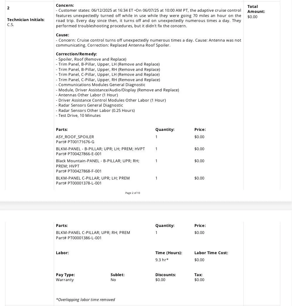

Please come back on and see what they say after they look at it. I am thinking it will be fixed in an update as it seems the issue appeared after the last update as others have said.
Truck is back.
They ultimately ended up replacing the antenna assembly. I haven't had enough time with the truck using highway assist to determine if the issue is truly fixed. Unclear how they diagnosed the antenna issue, I was not having issues with cellular, GPS, etc. so seems a little suspect...
It also came back with the latest FW, so it will be tough to isolate variables.
I'm curious if folks have noticed reduced occurrence after the latest update?

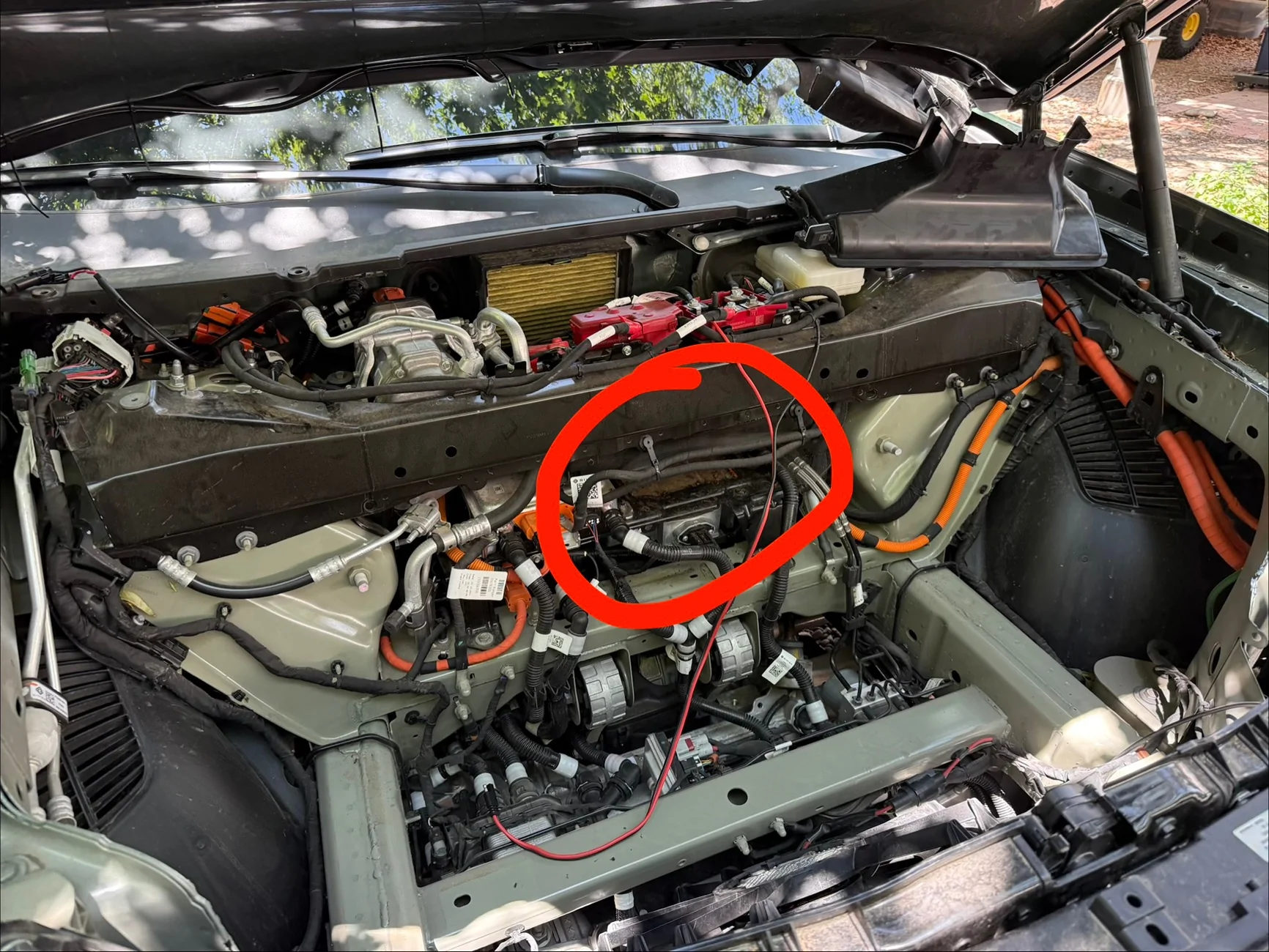

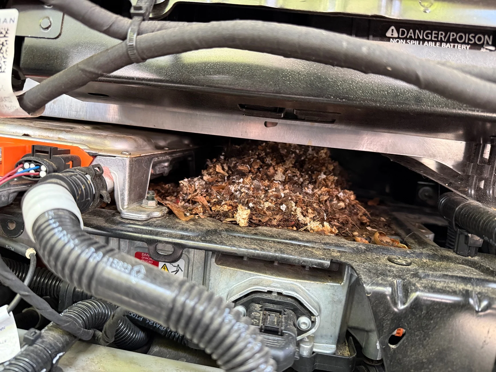

So here’s an interesting thing. I recently had my R1T in for service, and I brought up this issue. They told me that it’s a known firmware issue that affects certain vehicles, and that it should be solved with a future software update (as well as that another guy who had his truck in at the same time actually had it resolved by replacing the steering wheel… not sure what to make of that).
However, I recently had the frunk tub out to run some wiring (solar panel on hood to keep 12V battery topped up, more details in the thread on vampire drain). While I had the frunk tub out I discovered a void that was full of what looks like it might have been a rodent nest or something. I found no damage, or any evidence of ongoing rodent activity, so I simply cleaned it out and kept going. Since doing that, I have not had any issues with the ACC or HighwayAssist. I obviously can’t say for certain the problem is solved, and it previously would sometimes go quite a long time without issue, nor can I say that this was what potentially solved it, but it is an interesting coincidence. It certainly seems possible that the issue might have been related to overheating of some component due to a lack of airflow that was resolved when I cleaned out this mess or something.

Wow - that is a lot of rodent confetti to not have any other issues related to wire damage.
I am restoring an old Land Cruiser and that much junk is a sure sign that I am about to stumble upon some very sad section or wiring harness.
Happy to hear it resolved your issue though!
