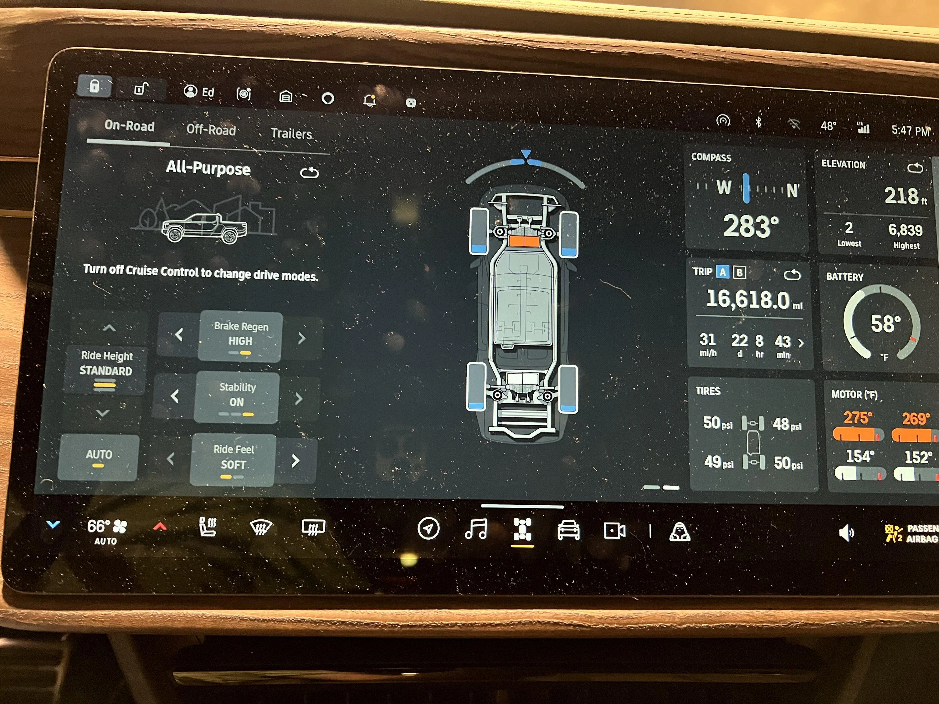

Rivian copied Tesla's design where they use motor windings to help bring the battery up to charging temperature when needed. Unfortunately, on the first iteration this was done on a jacket cooled motor (the Bosch) where Tesla's design was built based on an oil bath motor. As a result, the Bosch motored Rivian has to really throw some temps into those motors to get any usable heat out of it. It is a relatively inefficient design.
Rivian corrected this on version 2 of their drivetrain (the Enduro), but for those running Bosch motors, high temps are the norm when trying to get some heat into the battery.
Yep. Mine got ultra-toasty on a recent trip. And what may have made it worse is that I was driving in "Conserve" mode on the freeway, so all the battery preheat energy had to be generated by just the front motors. I happened to flip to the gauges screen and saw the front motors in orange, so switched to All-Purpose mode. Took a picture a couple minutes later and the rears still weren't anywhere near as toasty as the fronts.

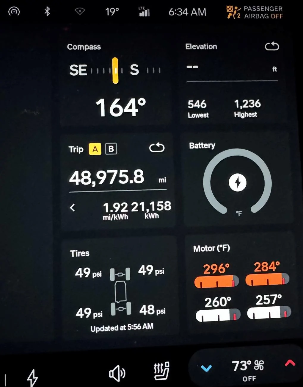

Similar happened to me last night and twice this morning at DCFC.
Temps +/- 20 degrees in north Alabama.
Figured last night was an error on me since I didn't navigate/pre-condition.
This morning I did navigate but the tesla charger was only 1.5 miles away.
Passenger front went to 292, other 3 at 220-240 and charging was limited to 7kWh in 18 minutes.
Navigated/pre-conditioned to a ChargePoint about 5 miles away and passenger front went to 296, other 3 still at 220-240 and charging was limited to 2kWh in 6 minutes.
Did a hard reset and moved to another charger.
This helped a little - charged 15kWh in 32 minutes with the left front at 296 and right front at 284, rears at 260, outdoor temp 19 and battery temp 64
Motor temps did not increase as quickly and all were in closer range of each other not just one motor way out in left field by itself.
Once I unplugged when I got the amount needed, temps returned to moderate levels very quickly.
I'm all for gages and warning lights but I need some base line info on what's happening.
